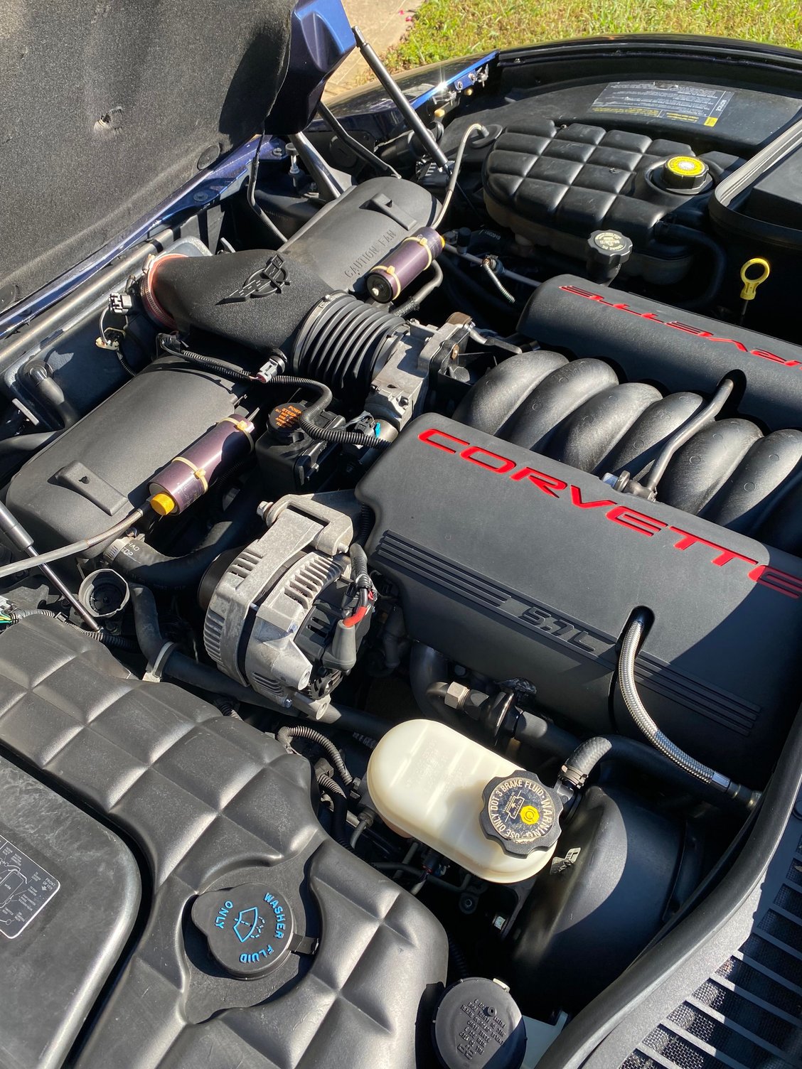

My Corvette is unmodified, so you have lots of plumbing in your car I don't recognize. But I think I spot an errant manual headlight **** near the driver's side strut. These slip off easily; in fact when I bought my car, one was off and in the engine bay, not unlike yours.
As for the temperatures; your modified car might just like to run a bit hotter than normal, but I have seen 230 in my car; even after a new water pump and 187 degree thermostat. Personally, I wouldn't worry about it. But you might consider checking your radiator. These cars are bottom breathers and can pick up a significant amounts of trash that can block the radiator.

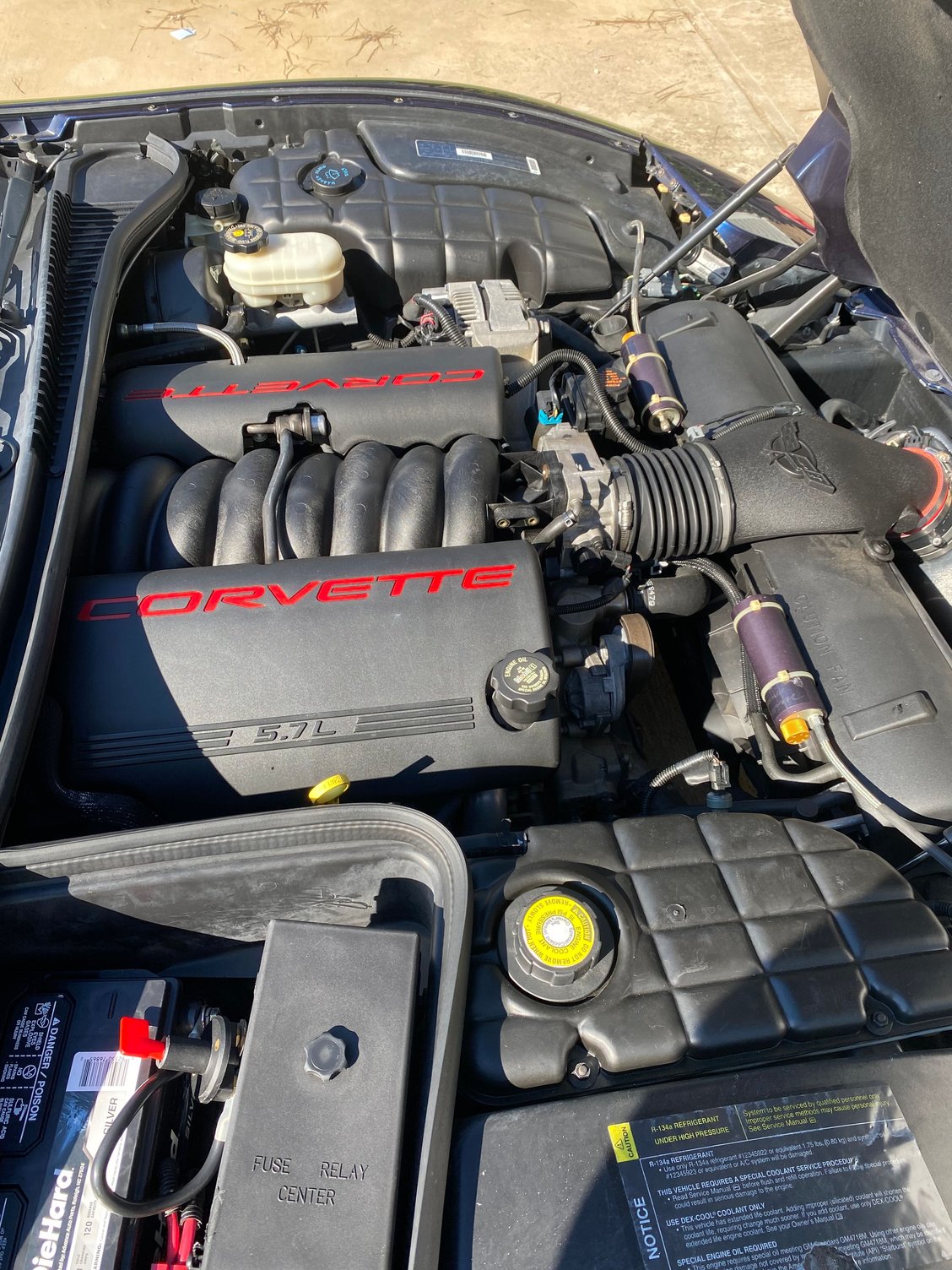

To me, your temps are high because you have a Dewitts radiator and that should keep things cooler than 235. A collapsing hose is not normal. The long tube headers do add heat under the hood but my supercharged 99 has long tube headers and I rarely see above 200 and that is with a stock radiator. You got something going on. I would start with the basics, blow the AC condenser and radiator out with compressed air. Blow from the engine side towards the front. You will be amazed at how much crap the AC condenser and radiator accumulates. Let us know the results.

With a Dewitts, your temps should be lower. I also agree that the first step would be to clean out the radiator and condenser. You might also check your coolant level if you haven't already. BTW, your coolant should be orange and not green. With that taken care of. Welcome to the forum, and congrats on what seems like a really great car! It certainly looks amazing, I hope that it brings you many miles of smiles.
