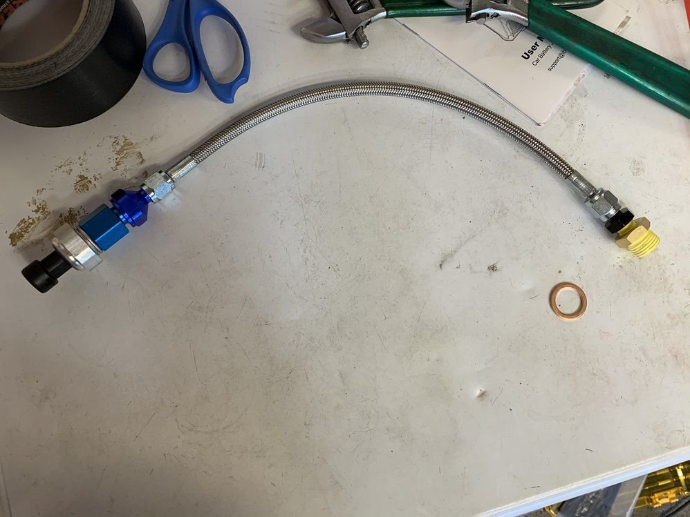

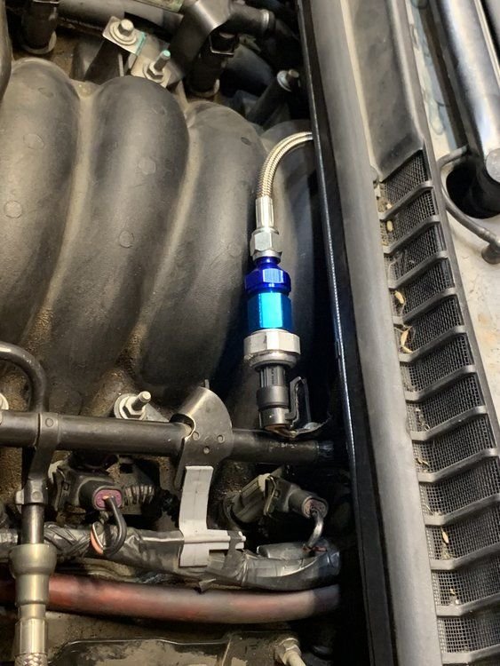

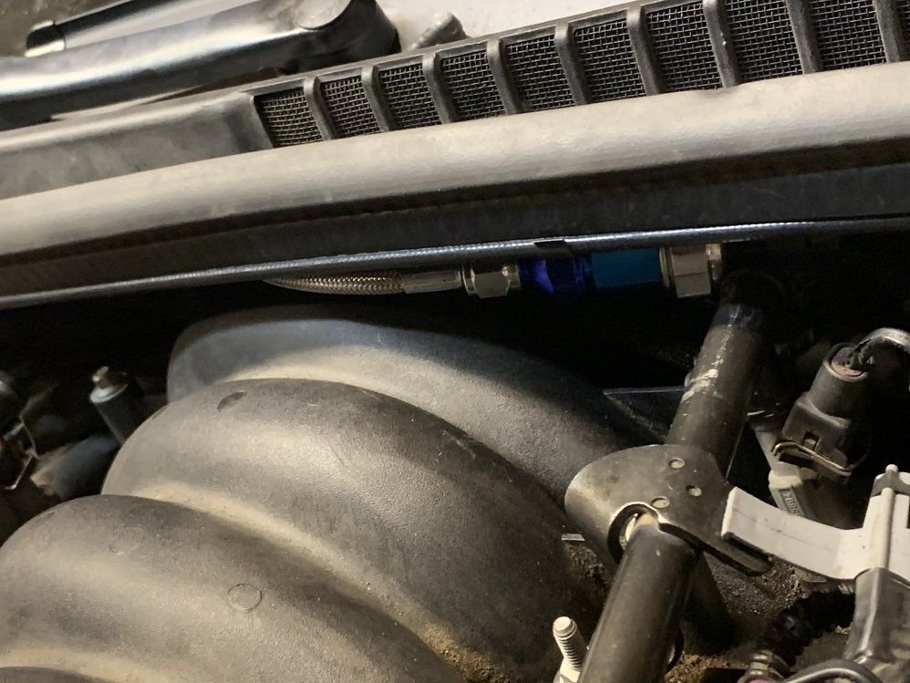

Unfortunately, the sensors go bad, even the replacements. JDMVETTE has wise advice with the remote relocation kit. When my oil pressure sender went bad, I went with the relocation kit. It's not cheap (though you can source individual pieces for less) it makes changing out the sender sooooo much easier.
