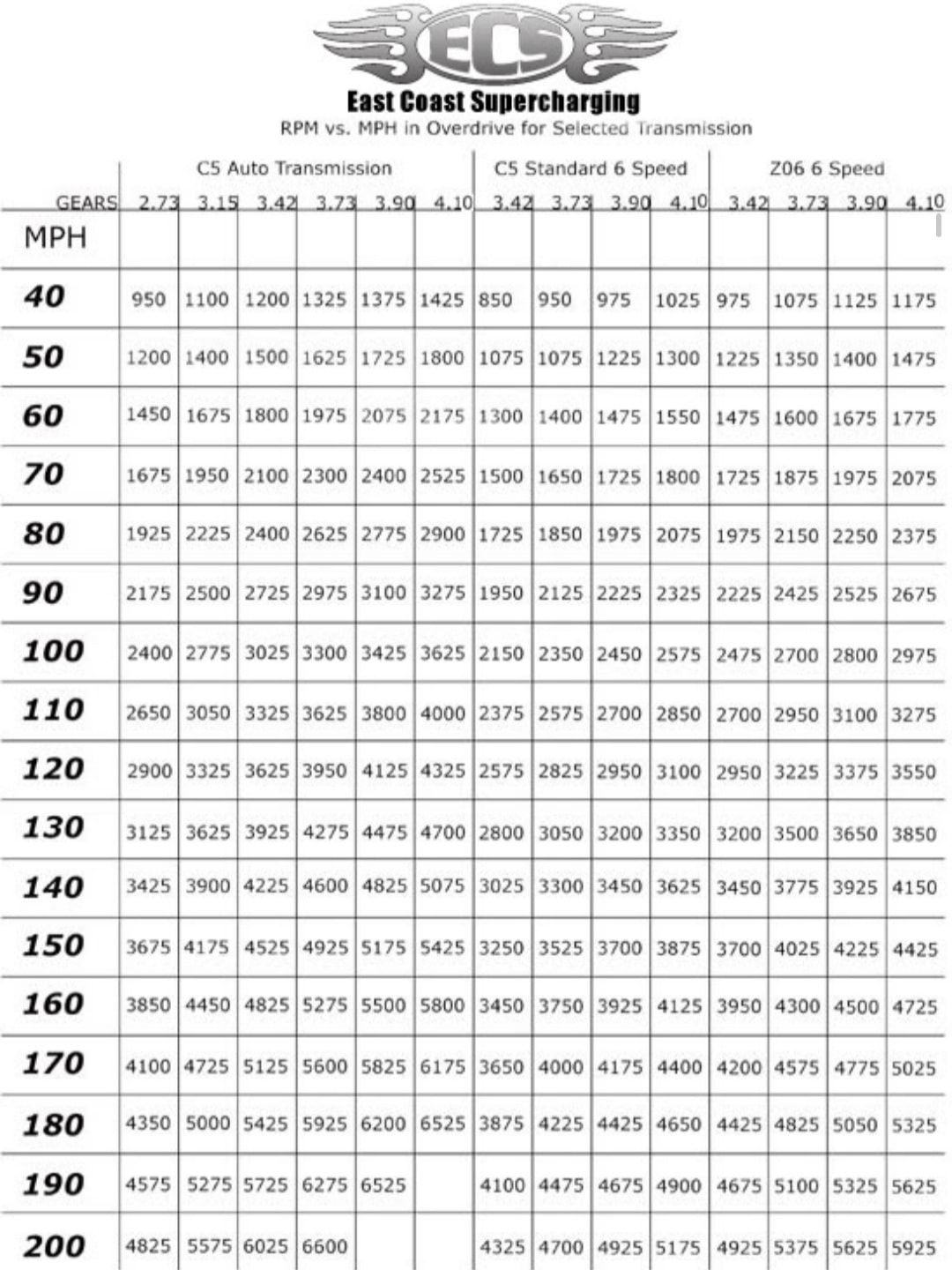

Here is a chart that should help you out

3.42 seems to be the popular choice for that combo. The next step up would be 3.73; pair this with a slightly higher stall converter and get a real kick in the pants, but under normal driving it would behave nicely. Also, when you get it tuned, they can adjust the shift points and firmness under hard acceleration. Fun!
65 mph with 3.15 gears = 1804 rpm
65 mph with 3.42 gears = 1958 rpm
65 mph with 3.73 gears = 2136 rpm

Or…you could drive your car at 40 mph and note the rpm. Then compare it to the chart above. It may not match precisely, but should be close.

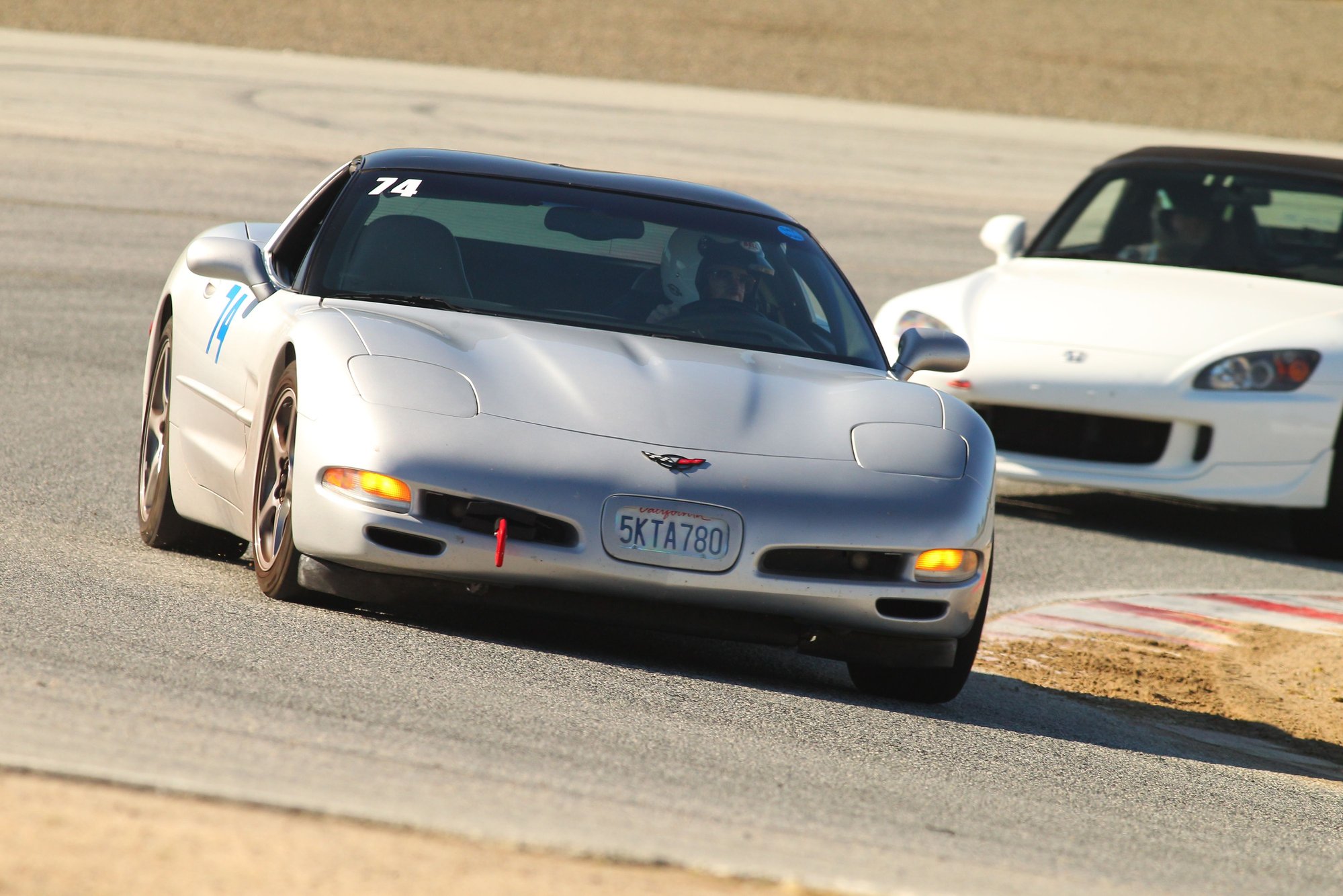

Not necessarily short tracks. My favorite track of all time is Laguna Seca. Before moving to Arizona I had spent 13 days there over several years. Coming up the long straight I would hit 110 before braking for Turn 2. Stock HP but 3.73 RPM rear drive with WaveTrac differential.
One thing I would do if I had the PCM reprogrammed again would be to program the auto 3-2 downshift so that it would not auto downshift from 3 to 2 at high lateral G and high throttle. A surprise downshift like and the rear snaps out and has to be brought back very skillfully to stay on the pavement.
Ask me how I know.
Here is where you do NOT want a surprise 3-2 downshift- Note roll level.

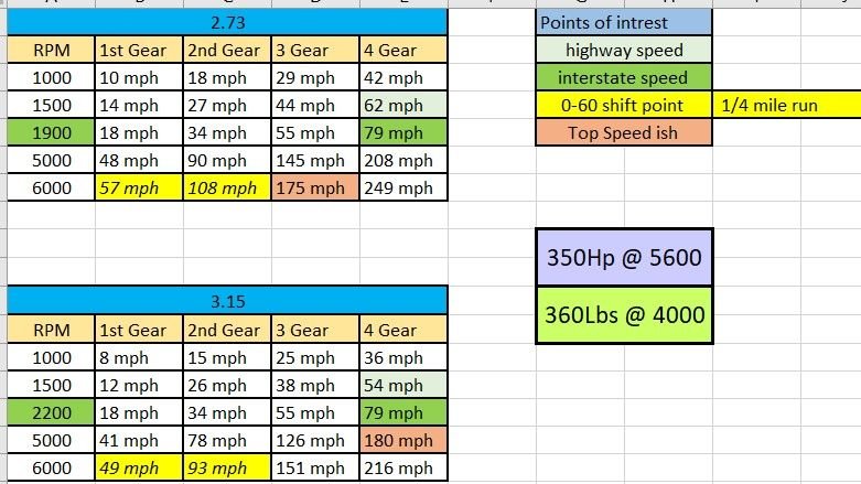

Some info I found. I have the same friend that plans on doing the same upgrade in the spring.
