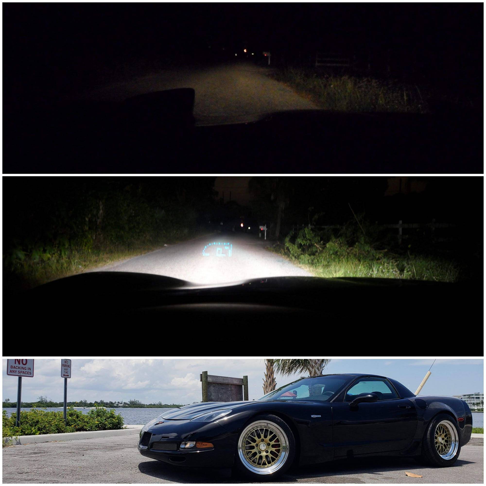

you need projectors, with a good HID/LED bulb, I do 90% of my driving at night.
stock headlights had to go
