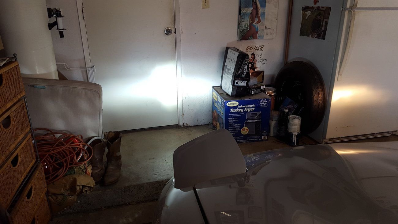

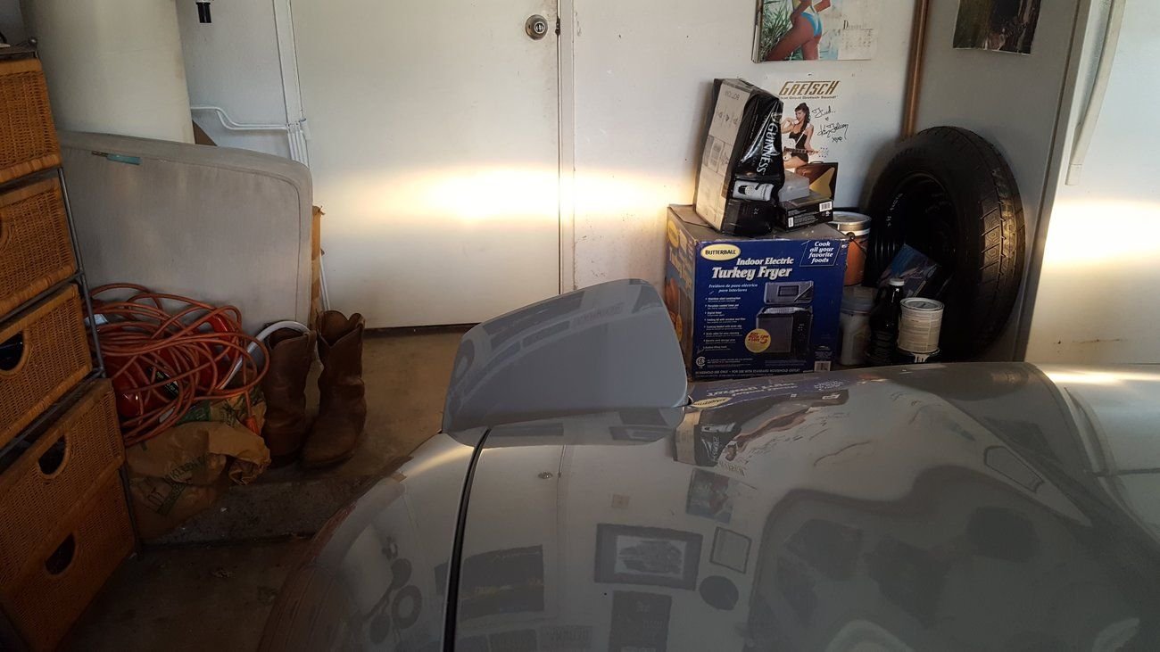

You don't want to just put LED bulbs in the stock housings... ask me how I know!!
Stock bulb beam shape
LED beam shape
With a glass bulb, the light emits from the filament at the center. Installing LED replacements screws up the geometry of the light focus.
