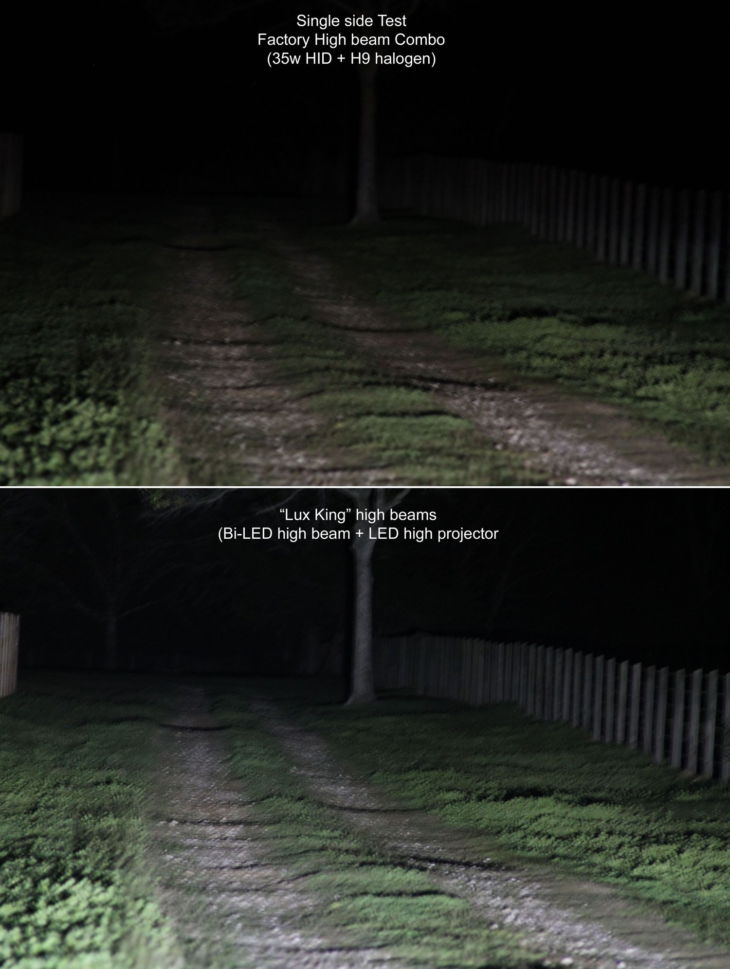

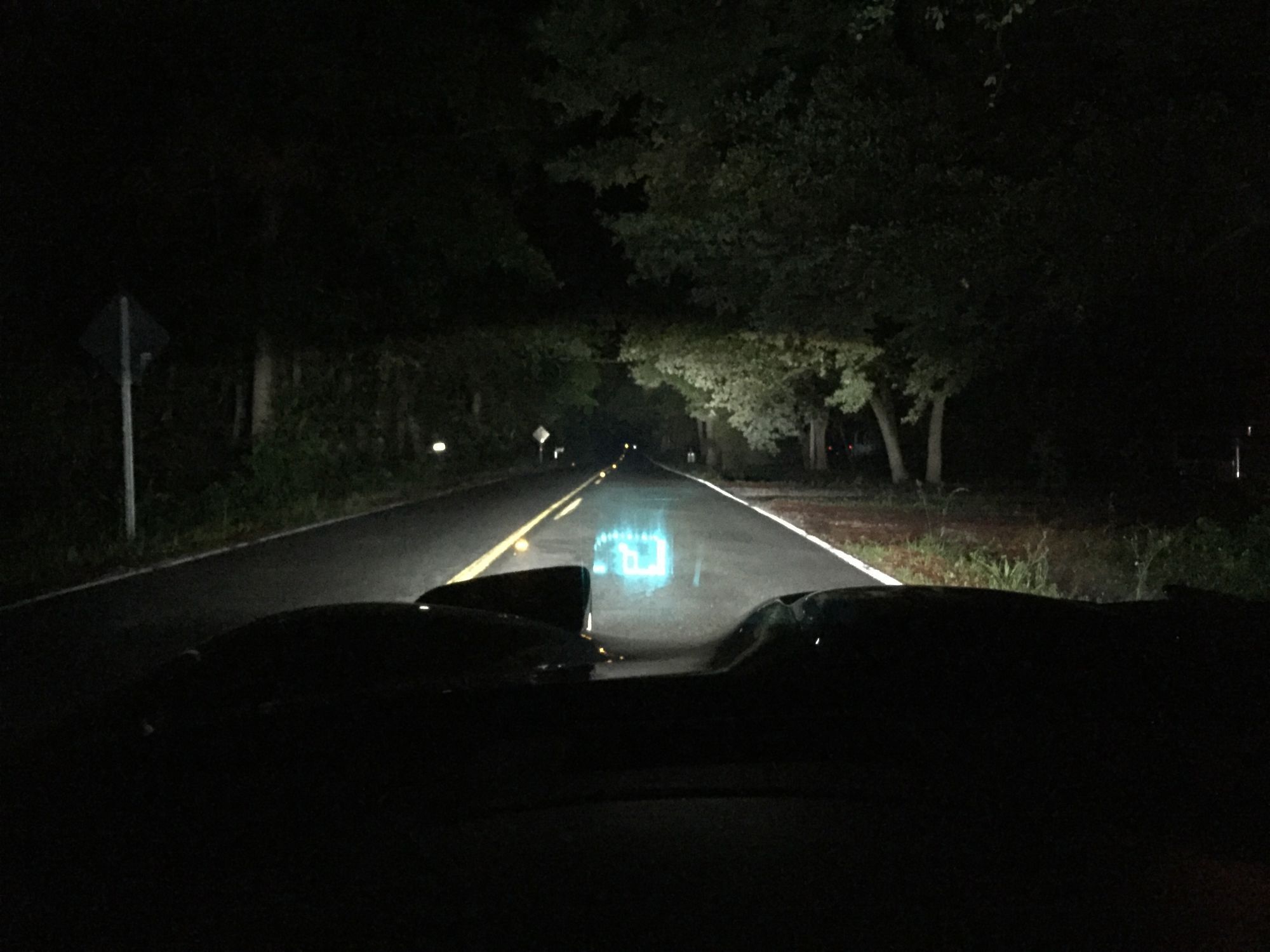

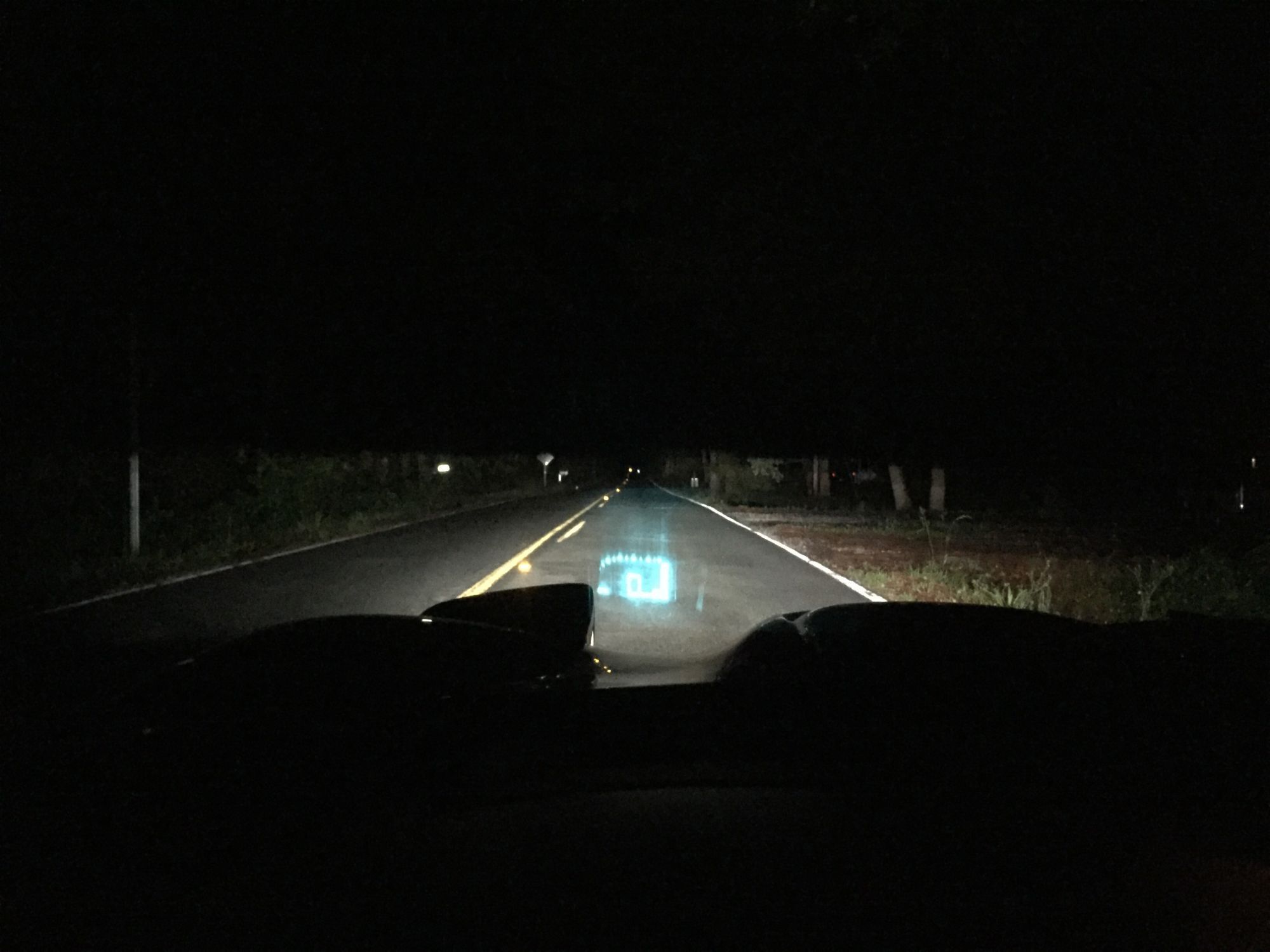

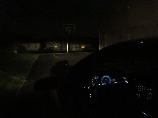

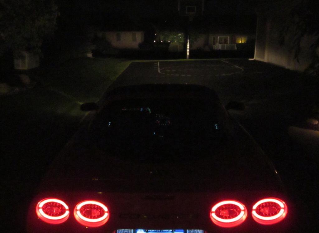

Our Bi-LED ACA headlights have a dual-function (low and high beam) projector and supplemental LED reflector high beam. Our newest generation LED Projector is 15% brighter (measured by Lux at TDC hot spot in low beam) than the last version.
https://sharplightinnovations.com/sh...aca-headlights
No other pop-up headlight system for the C5 comes close to this performance.
Low beam
High beam

Is it just taken with an older cellphone or why is both sets of patterns H/L look to be a quite narrow width?
Are the headlights improperly aimed? Low beam is shining on the top of the near opposite side road sign
Why do the high beams not extend distance past the low beam and only seem to light up higher tree branches?
Why is the HUD all fuzzy and its image in the middle of the windshield?
That’s for $695 plus tax aand shipping ?
Not sure. These were photos from a customer. It appears they are properly aimed though the car may be on a slight incline. The width is the widest in the industry. Keep in mind this road is pitch black and the only light source are the headlights
The high beam function on these lights is not to "extend" throw, but to illuminate objects above the cutoff of the low beam. The hot spot of the low beam is what provides the long range vision. It is only partially blocked by the cutoff shield. If properly aimed, the low beam hot spot will provide ample distance illumination. When the shield moves, the rest of the pattern is projected including a small part of the hot spot that was previously obscured. No additional light will be projected on a level road by the projector even though the hot spot will be more exposed. High beam is really only needed for driving on roads with a lot of geography (curves/hills) or to better see off-road hazards (pulled over vehicles, animals etc)
single projector only.
I
My guess is that the HUD was out of focus (in preference to the range of the headlight pattern)
Correct.

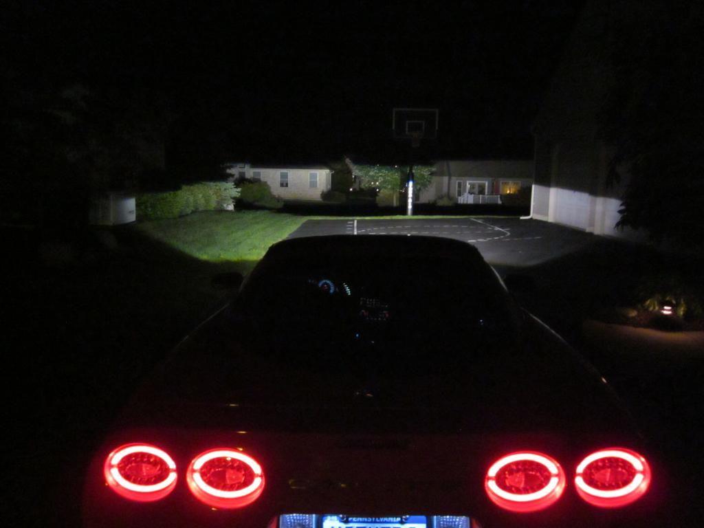

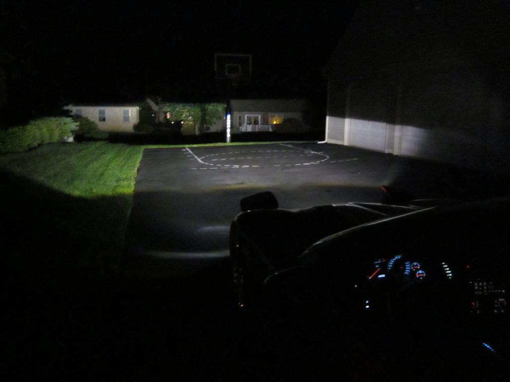

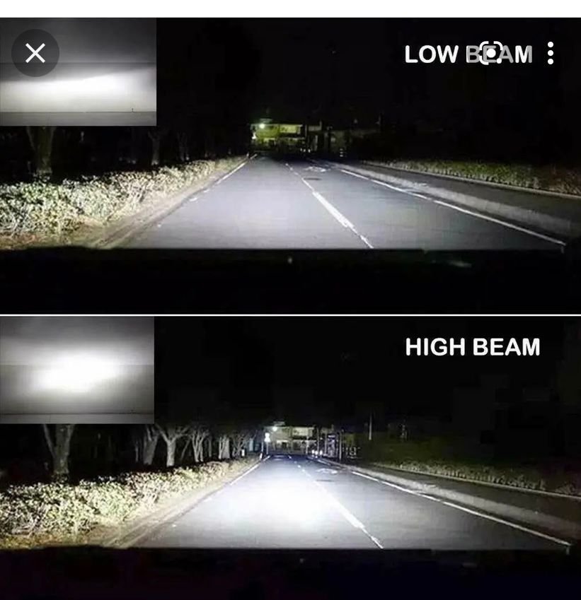

If the patterns are factual they don’t seem to compare well with quality lighting standards especially the high beam output. Also in the customers car both High and Low patterns are unusually high. I would be interested to see the lights shown on a height measured test pattern. A lower output light can be advantaged by raising the pattern above normal limits which could be verified as true and safe or not
Notice the wide and much lower pattern in an example below
Also, the test pattern high beam example does omit a higher level of light but looks unfocused and blurry instead of clear and controlled and in the Customers photos only seems to illuminate an unnecessarily small high area not really needed
It’s difficult to trust cell phone photos but there are systems that provide quality light patterns out there that makes it easier to see like the pattern below which illuminate much cleaner, wider and seemingly at proper heights
Given the choice; which pattern would you choose ?

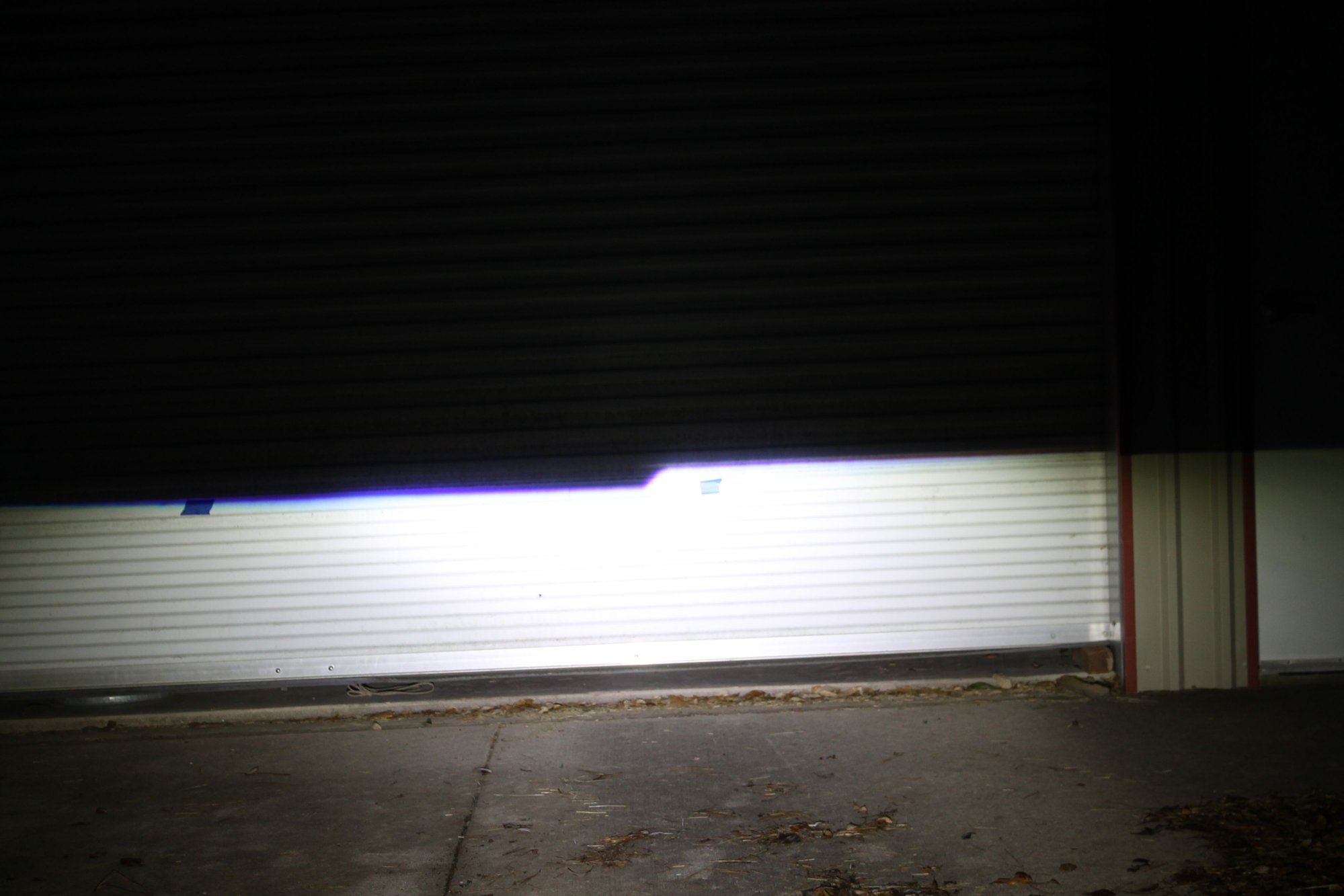

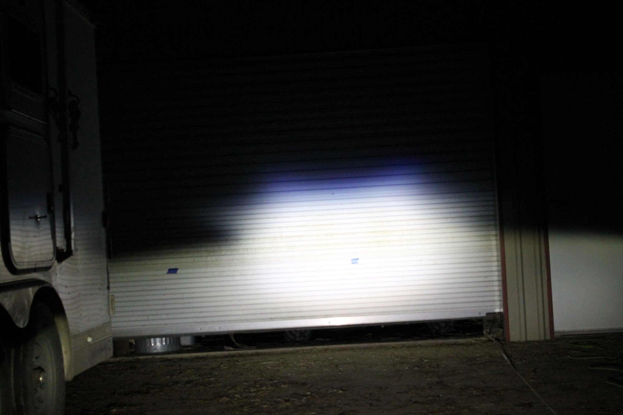

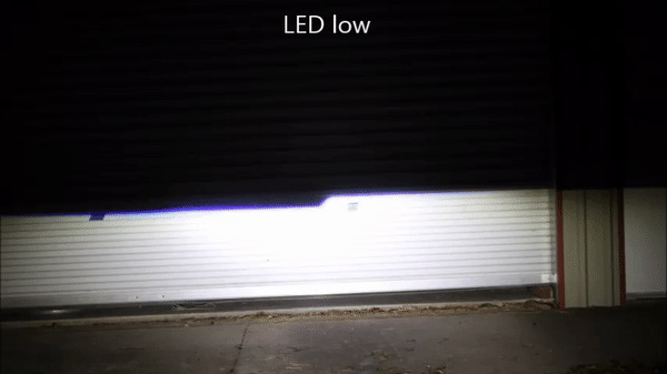

The patterns you have posted appear to be more along E-code T-84 headlights for the C5. While the E-code lights do have a noticeable cutoff, pattern is incredibly narrow especially compared to a modern projector. In addition, you are still required to use halogen bulbs which have limited output on factory wattage.
Objective tests using our previous generation LED projector shows the following at 20'
Top Dead Center: 1120 Lux
10 degrees off-center: 138 Lux
Settings F5.0, 1/20" ISO 400
A single projector was easily able to illuminate an 8" wide tree at 475ft distance
More information here:
https://www.corvetteforum.com/forums...post1601460077
Countless high-end vehicles come from the factory wit Bi-function projector optics. The high beam creates a combo spot flood pattern which given the substantial hot spot produces subjectively uniform illumination irrespective of distance. Compare that to the "blob" of light from the E-code headlight pattern which has so much foreground glare as to be irritating. There is a reason even e-code reflectors have fallen out of favor. The vast majority of luxury auto makers use HID or LED projector optics for this reason.
Factory Low
Our kit Low
Factory Low
Our kit Low
If you need more "throw" our "Stealth light cannon V3" projectors use the same projectors main, but in a fixed headlight configuration. The Bi-LED projector in the outer position but have a supplemental dedicated high beam projector. At 25ft, the hot spot from the Bi-LED and projector combo is over 2000 Lux.
Measurement taken at the central tape mark.
Single tree is 475 ft away. The Tree line is 100ft away.
