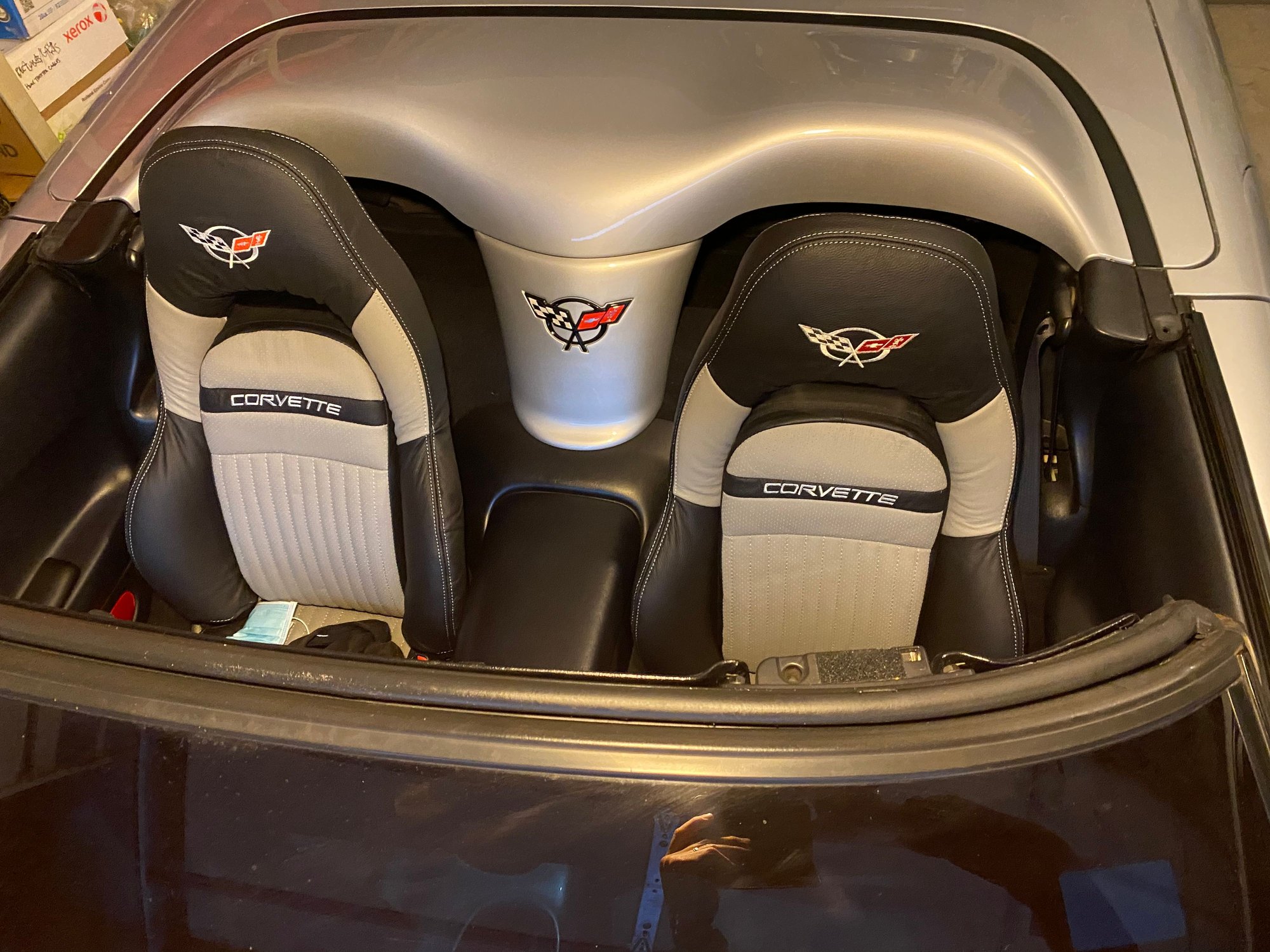

I redid my seats in leather and new foam. Lots of online research. When one vendor never called back, I gambled on Leatherseats11 on eBay and they were leather and budget priced. Let me choose the colors and pattern and ventilation at no extra charge. The logos look awesome.
New foam from PFYC.com.
Makes my 98 look new.
