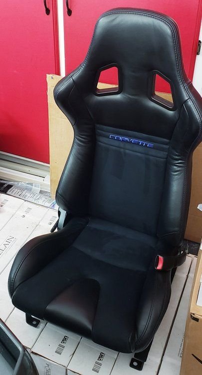

Try these, $900
https://www.corvetteforum.com/forums...tom-seats.html
