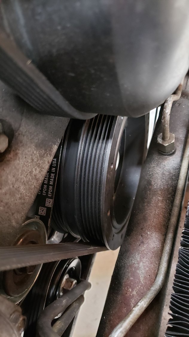

Heating the new balancer in the oven. A half hour at 350 and it slid right on.
Installed and torqued. The LS motors have an interesting process for balancer replacement. If you've never done it, google it before you attempt it yourself. Its not a lot of fun.

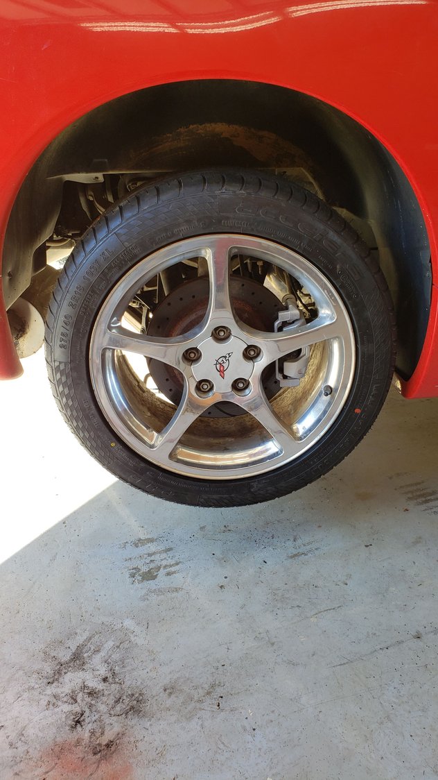

We replaced all 4 tires, they are factory sizes. The car came with Michelin Pilot Sport run flats on it that had been heat cycled a few too many times. They were pretty much shot. I decided to go with a set of 400 treadware Accelera PHI 2 as replacements. Never tried them before but they're a matched set in the correct size for a reasonable price. If they suck or don't last its all good because they were mad cheap.
I need new lug nuts. Anyone have any suggestions?

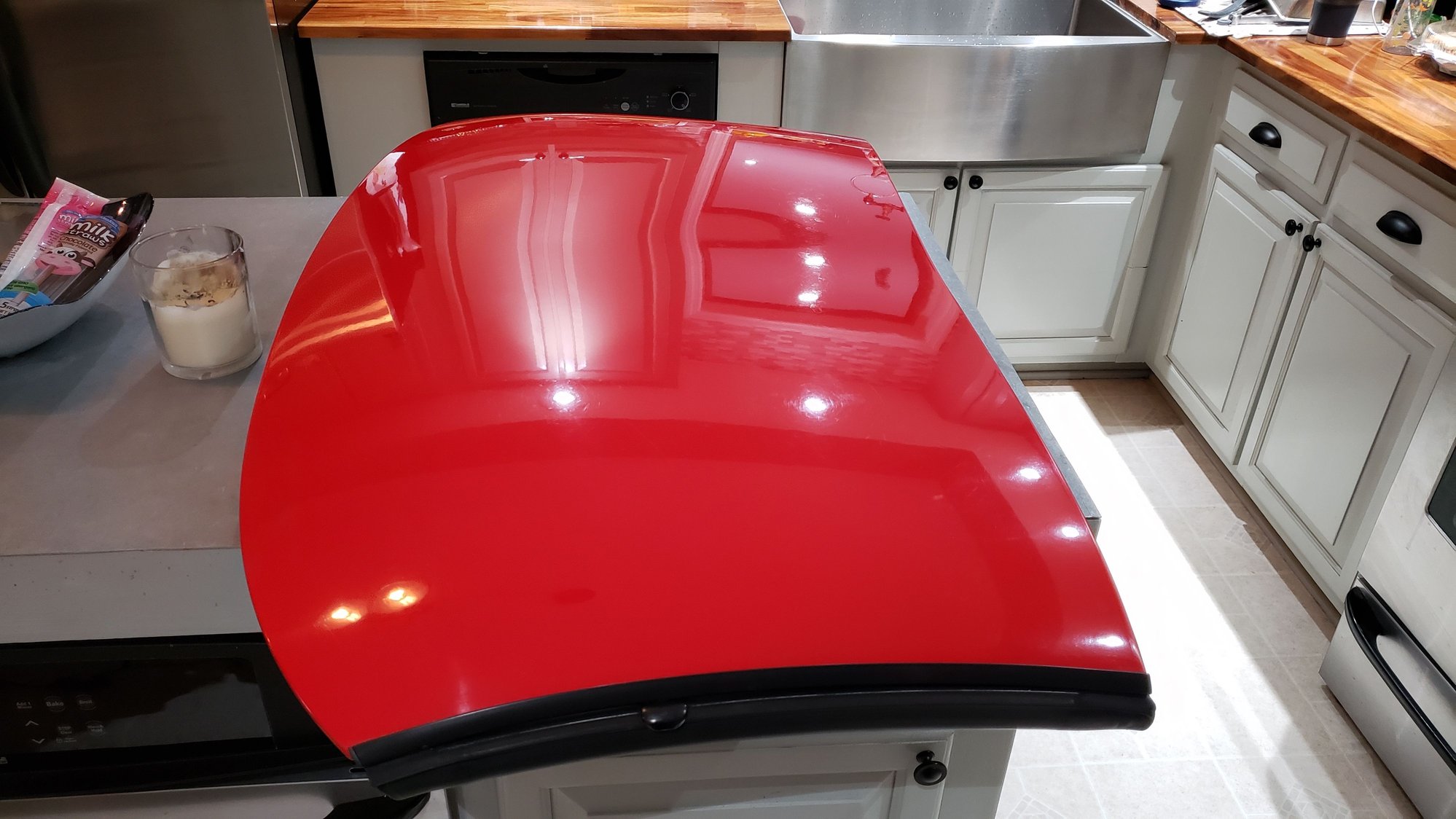

We wrapped the roof in 3M gloss carbon. This stuff is crazy hard to work with! It's mad thick and takes a LOT of heat to stretch it. Good product but I should have practiced with an easier product first lol.

I'm partial to the relatively inexpensive Gorilla lugnuts you can get on Amazon for like 40 bucks. I have them on damn near everything.
The nice thing is if you get stuck in a pinch you can still remove them with a socket and not wreck them. They will keep the honest away from getting them off as well.
The clear top on my 1997 has at least a half dozen cracks coming in from the door edges. I would like to grind those cracks out a bit and then back fill them with polycarbonate glue. Then wrap it with the 3m in a Gloss black.
I also just blindly assumed the top would be a pretty easy first wrap project. Thanks for the heads up that it may not be lol.

Wrapping the top is actually a very easy first project. There are minimal curves/contours. A helper makes it a LOT easier and a good hair dryer or better yet a heat gun is a must. I was mostly just commenting on the carbon wrap. It is extremely thick and hard to work with. A solid color wrap is much easier to apply.

Gorilla makes good products that last. I originally bought model 41137, but the profile was too round at the top and didn’t look right to me. I found a set of 41138 LT’s on eBay, and they have a flatter top that look closer to the originals (but whose quality are wayyy better that GM). I believe that the 41138 is now discontinued, but you can still find them on eBay, and Gorilla can help you find something similar if you can’t locate them.

So two votes for Gorilla lug nuts. I will definitely check them out. Its not real high on my priority list but whatever is on it now looks like crap.
