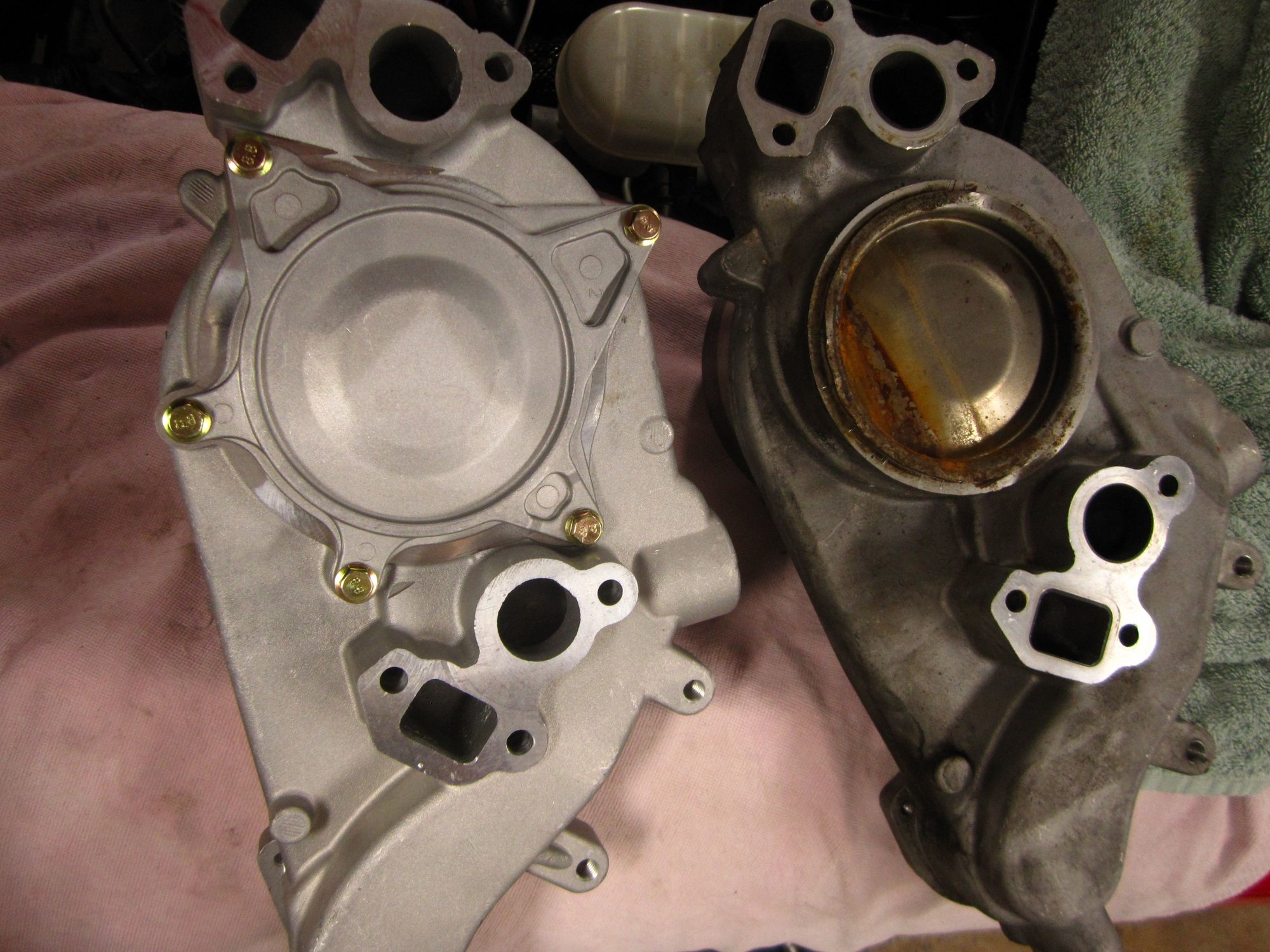

I went with the NAPA $170 pump due to its design, it uses an aluminum bolt on back instead of a pressed in steel plate which can leak and rust.
Here's the NAPA on the left and the old GM on the right, the rusted area is where the coolant was leaking.
Looks like a good design improvement.
