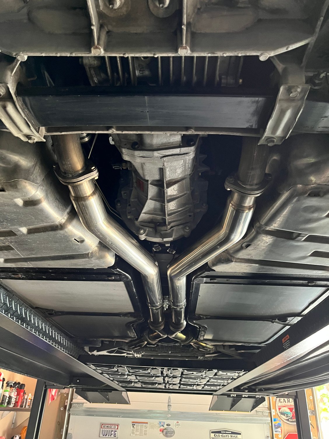

That Exhaust is a flange back system. Mounts from the flange back, it will work with the stock exhaust. I installed it on my Z06 that has American Racing headers and high flow cats with a X pipe and droned terrible. I literally took it back off the same day and put my titanium system back on.
