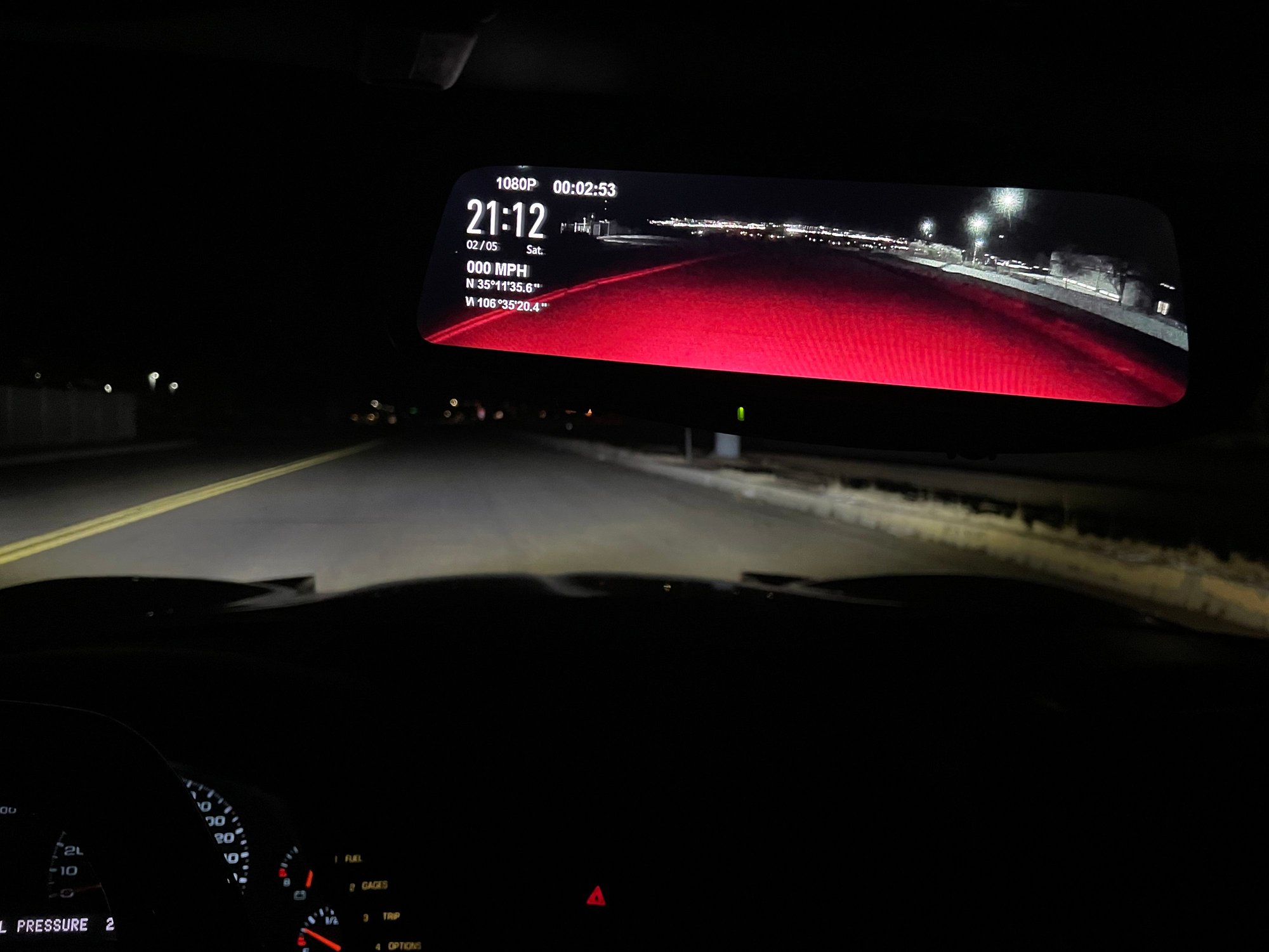

Old Feb 7, 2022 | 09:44 PM
jdmvette's Avatar
jdmvette
Night Owl for life
Joined: Nov 2003
Posts: 24,725
Likes: 4,564
Slap on a camera overlay mirror instead
yeah, that's what I suggested.. I have one of those in my keep.
they're great.
That does look like a pretty cool upgrade.
the camera-in-a-mirror takes some getting used to -- I put one in my offroad cherokee b/c I had very limited rear view , due to 40" spare and roll cage.
you're also best off getting a more expensive unit -- the lower cost units are really janky, run at like 15fps, and can actually be disorientating. Get a good, 4k camera/screen combo with at least 30fps..even then, since the viewing angle of the camera (usually mounted somewhere on the rear) is at a differnet angle -- usually lower -- it does take some getting used to. You have to remind yourself you're looking at a monitor, not a mirror.
