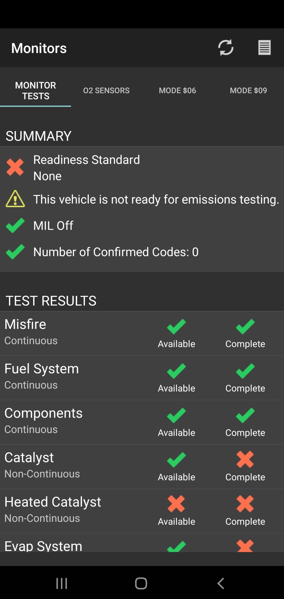

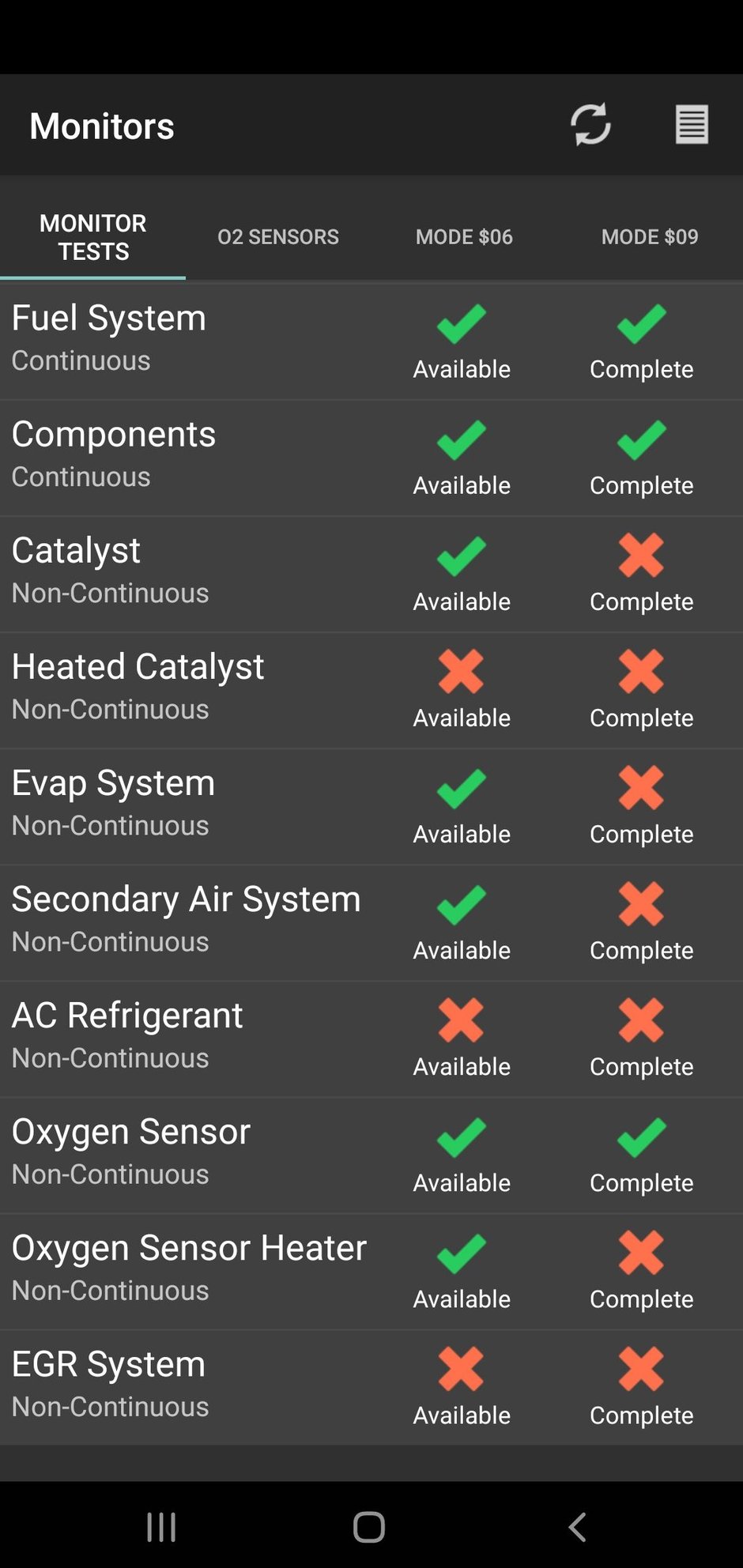

Hey guys, I'm trying to get a get a nice looking z06 for a good price, but he has texas speed headers with xtreme corsa, and claims he has the high flow cats. Haven't raised the car so I don't know if it's true, and after checking the monitors, most were not ready as if he just cleared the codes. I'll include a screen shot of them at the end. There were a few stored o2 codes. Is it possible that the monitors look that way because of his tune? Because I have a big problem. In NY, I am only allowed one not ready. So I would not be able to register the car. Someone told me a tuner can take care of it, but I don't think they understood that by deleting the o2 sensors not to get the check engine light, it would still not help the monitor situation. Should I just forget about this car? Because i really don't feel like spending over a $1000 to install the stock headers and cats. From reading, I should be able to pass with high flow cats.. assuming he has them. Let me know please. Time is running out

You shouldn't even consider this car without a full pre-purchase inspection from an experienced Corvette mechanic. If the mechanic doing the inspection is any good, they should be able to tell you if the car won't pass emissions (as well as any other issues that you may not currently know about). If the seller won't agree to this, run away fast.

Are the front O2 sensors on the car to be turned on again? I have headers, front O2 sensors and high flow cats, the car passes NYS inspections as long as the check engine light is off and the GM learn procedure was run two or three times. If the codes were cleared, the GM learn procedure needs to be run even though the check engine light is off. Disconnecting the battery might also require the learn procedure to be run. try running the learn procedure on a cold engine to see if anything improves.

Usually if a battery is disconnected a car needs to be driven about 30 miles before sensors are ready again. If he cleared the codes and disconnected the battery it will make all those sensors not ready.
Ask him to take it for an extended test drive and to have a mechanic check if it can pass emissions before you buy it. Don't let excitement and emotions get you to pull the trigger on a car that could be a nightmare to register.

I'm a a NYS Inspector. Take it from me, If the seller cant provide proof that ALL monitors are ready with no check engine light on, walk away. There are lots of C5's out there to buy that are good ones.
