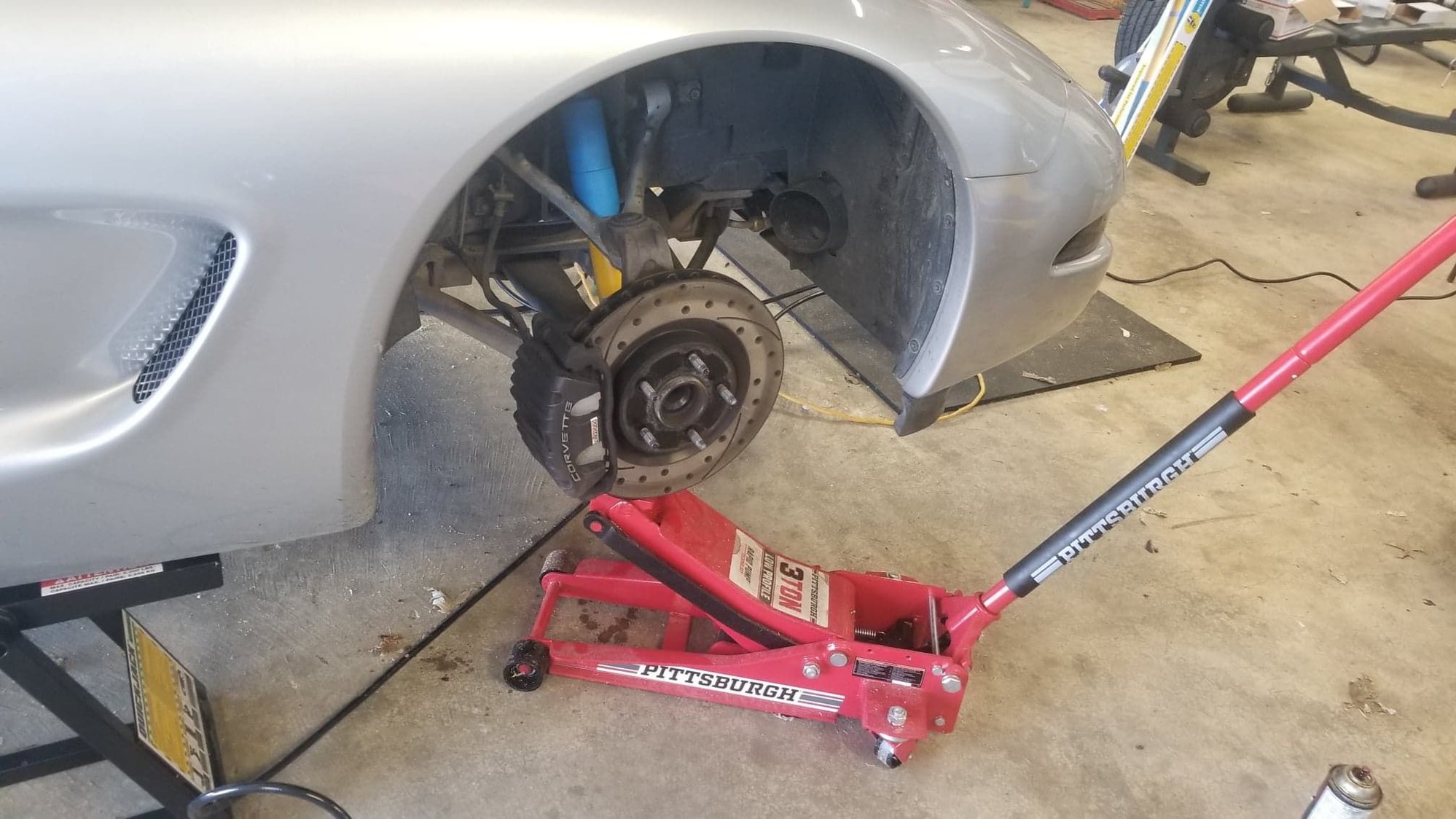

QJ5000 has been a good addition to my garage.
Tire rotations are a breeze and getting the C5 up in the air safely and evenly makes it a more the reason.
Last I looked at 4 post, and before I bought the QJ, they were double the price.
QJ's are not for the old & weak, they take some muscle to get in place.

Has anyone used the quickjack 5000TL on their C5? Concerned on the distance between jacking points. Seems really close to not meeting the minimum distance. Just assembled mine and it seems really close to not fitting properly on the jacking pucks.
Old Mar 5, 2022 | 07:20 PM
pjdbm's Avatar
pjdbm
Joined: Mar 2017
Posts: 1,486
Likes: 343
From: Long Island New York
I lift my C5 often enough with no issues, I carved out the blocks to fit nicely without using pucks.
I move the QJ slightly closer to the front to compensate for the weight difference.
*** Just saw you posted TL, not sure on that model

I agree on all points. I use mine often, from detailing to suspension work. Shock install was a breeze using these, but yes, you do have to muscle them into place. I leave mine on the shop floor and scoot them into place when needed. All in all a great addition to my garage. Got mine online from home depot for 900 shipped last year, worth every penny!

Same here. It appears to be about 2-3" too long. Not sure what to do.
Old Mar 19, 2022 | 07:27 PM
AtkRWC's Avatar
AtkRWC
Joined: Apr 2019
Posts: 232
Likes: 121
From: South Texas, US Army-Retired
According to Quickjack, on their YouTube channel, the jack can be used crosswise, or perpendicular, BUT I measured, and it still does not seem to fit completely. With the blocks pushed all the way towards the outside it is about 59.8" to the outside of the blocks. The center of the pucks does fall within these parameters however do slightly exceed the outside of the lifting blocks. I would be concerned about the blocks potentially kicking out. I know, hard to visualize, I'll try to take some pics later to explain.
So for now, the QJ5000TL does not fit the C5. There may be a work-around using steel plate like I saw from another C5 owner. Still really bummed as I have been wanting this jack for a long time and it will not work unless there is some modifications.
The QJ website say: "The minimum lifting point spread did change from 31.5" to 37", but this will not make a difference to the vast majority of 5000TL users." It does make a difference for C5s. I just did not think to measure since so many C5 owners had good results with the previous models.
