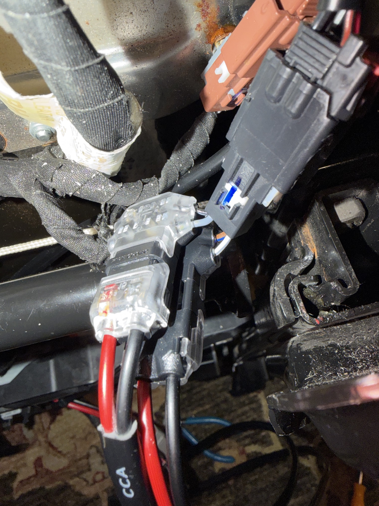

Thank you for this picture. I have the GT2 seats and this was exactly what I needed. All of the other endless threads were very confusing. So anyone else that is looking for wiring info, disregard everything else and go directly to this picture.
That said, I'm using quick connects to the pins but I get the feeling that it's not a good long term solution as they can pull out fairly easily. I'd recommend splicing into the wiring behind the harness (now that you know what pins to look for) or maybe soldering direct to the pin.
Glad the pic helped. Agree on the connector issues, splicing before the harness may be my best option. It’s tight in there, I’d really rather get the c8 car side connector and come into the seats that way… running out of time!

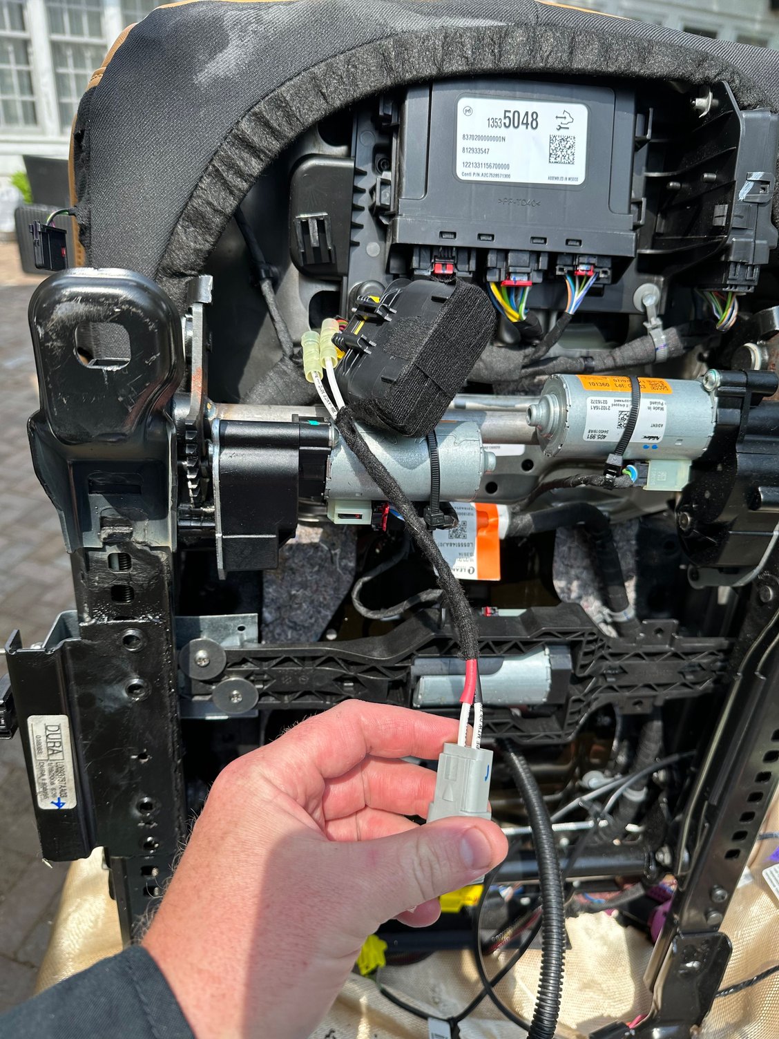

I have no personal experience with the Vetteworks harness, I dont believe they can control the fans. You can do harness + sims, or you can follow what Rod and I did and swap everything from the C6 seats over to the C8 seats (or do your own mix).
I repinnned the C6 seat-side plug to pull power for the C8 movement functions, I spliced into the C8 seat power/ground and added Amphenol connectors to make it clean.

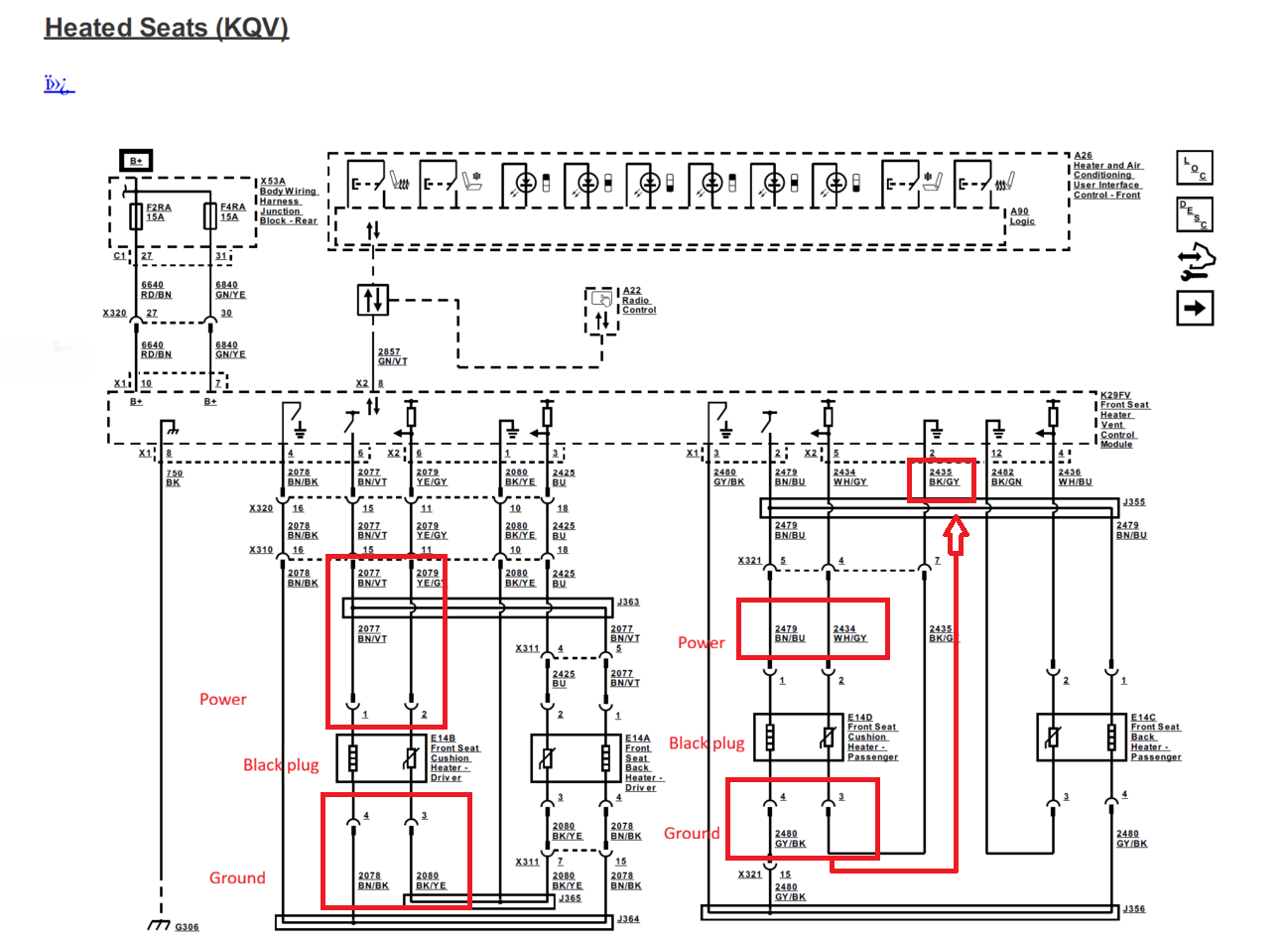

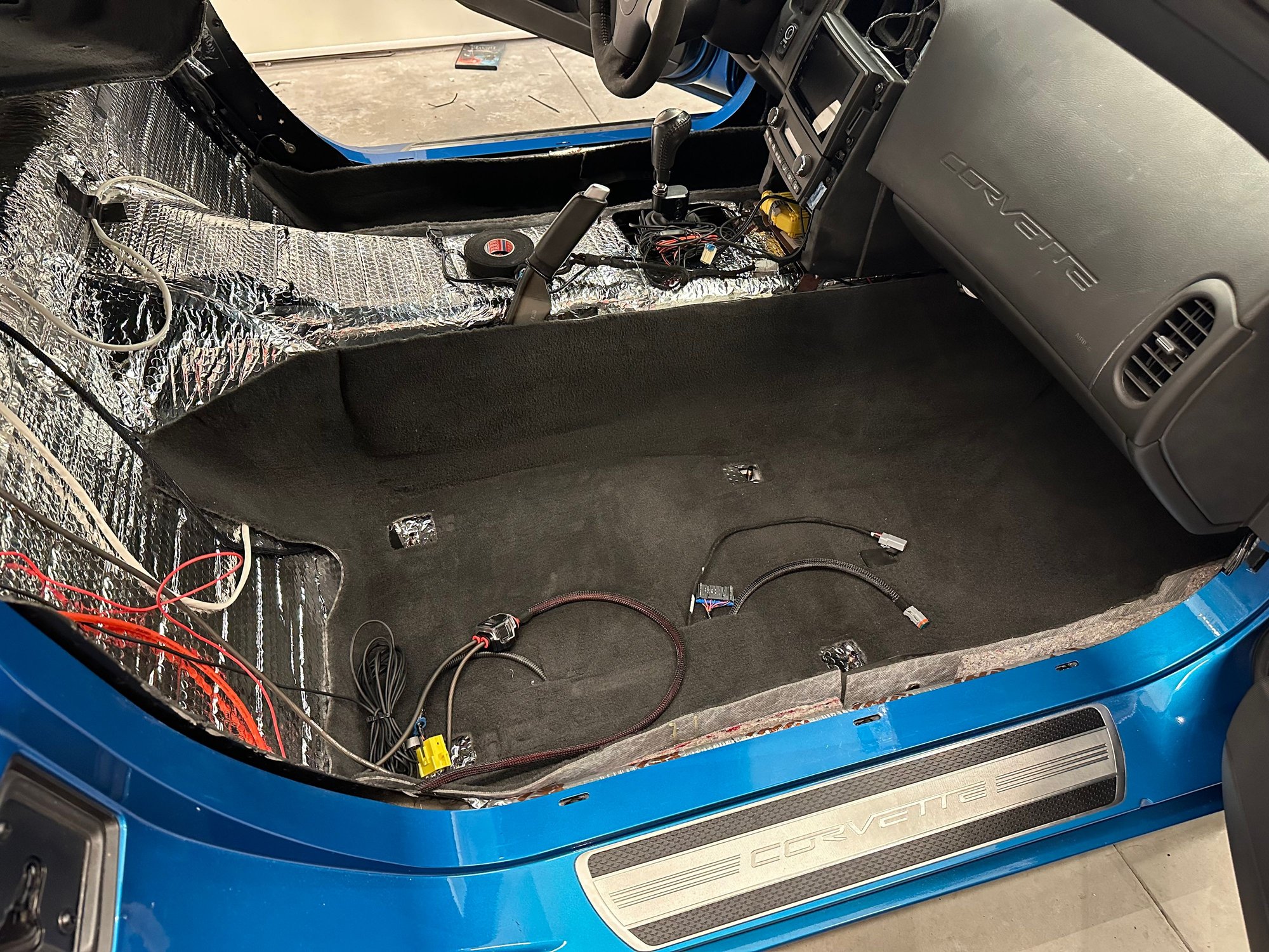

I figured out the seat heaters. Here is the schematic for the driver and passenger side with my markups. I utilized the black plugs right next to the seat ventilation plugs on the seat back.
Both bottom cushion and seatback cushion are tied together via this yellow connector; therefore, you only need to tap into either wiring plug in order to get both cushions to function together. I chose to tap into the bottom cushion plug, as noted in the above schematic.
DRIVER SIDE
POWER - Brown/Violet 2077 and Yellow/Green 2079
GROUND - Brown/Black 2078 and Black/Yellow 2080
PASSENGER SIDE
POWER - Brown/Blue 2479 and White/Gray 2434
GROUND - Gray/Black 2480 and Black/Gray 2435

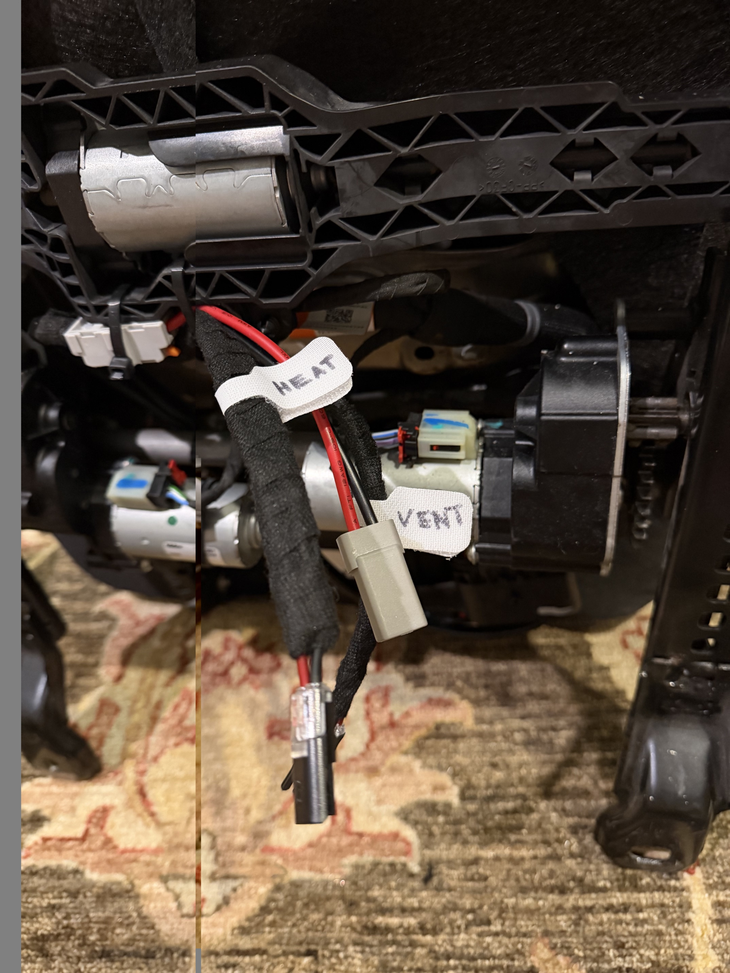

Here is my passenger side wired up. I used double taps for power and ground, leading down into one power and ground plug.
Three plugs: seat control power, ventilation, and heat:

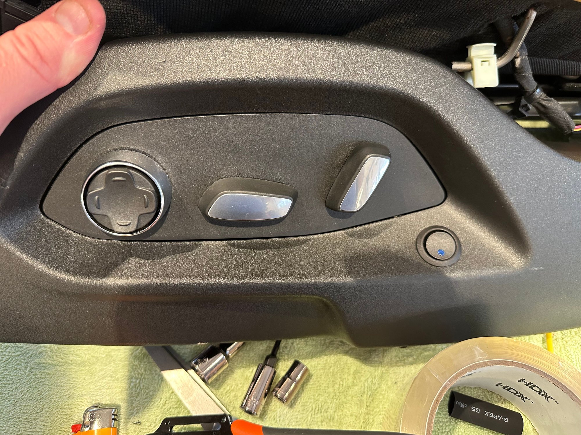

I am not doing levels of heat or vent fan; only simple on/off via push switches which will be housed in the radio bezel ash tray space.
