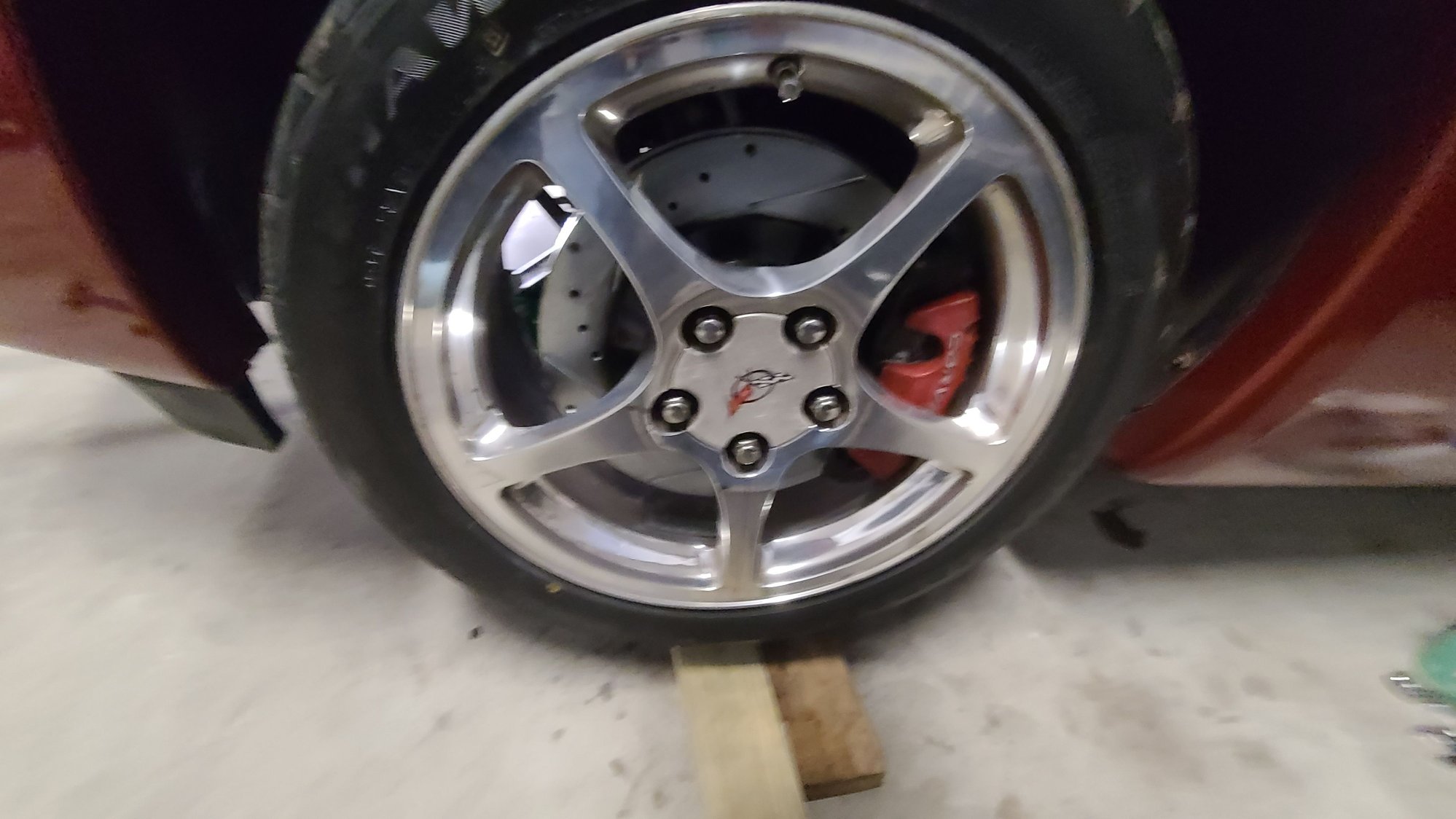

It's purely a cosmetic change, does not offer any real performance benefit, and may reduce rotor/pad life. That being said, it's a popular cosmetic upgrade, and one that I've done, even though I am usually not into mods with little functional gain.
If you like red calipers, you can find a set of take-offs from a Z06 and it's a direct bolt-on. Plenty of aftermarket rotors with slots or holes, RockAuto has a few to choose from.
I swapped on the C6 Z51 package which gives larger rotors front and rear, slightly more rigid front calipers, in addition to rotors being cross-drilled. Again, little performance benefit, but it looks nice to me.
Rusty in this pic due to recent washing and sitting but once around the block and they're shiny again.

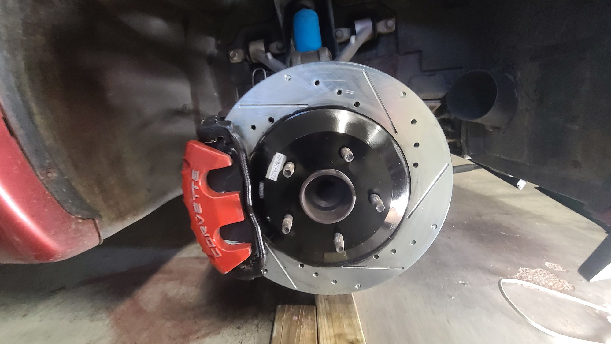

Just installed last weekend. I had a pulsing in the brakes, so replaced with new. They look great and stop
Old Mar 16, 2022 | 04:10 PM
Maxpower220's Avatar
Maxpower220
Joined: Nov 2021
Posts: 47
Likes: 26
Painted the center with high heat paint.

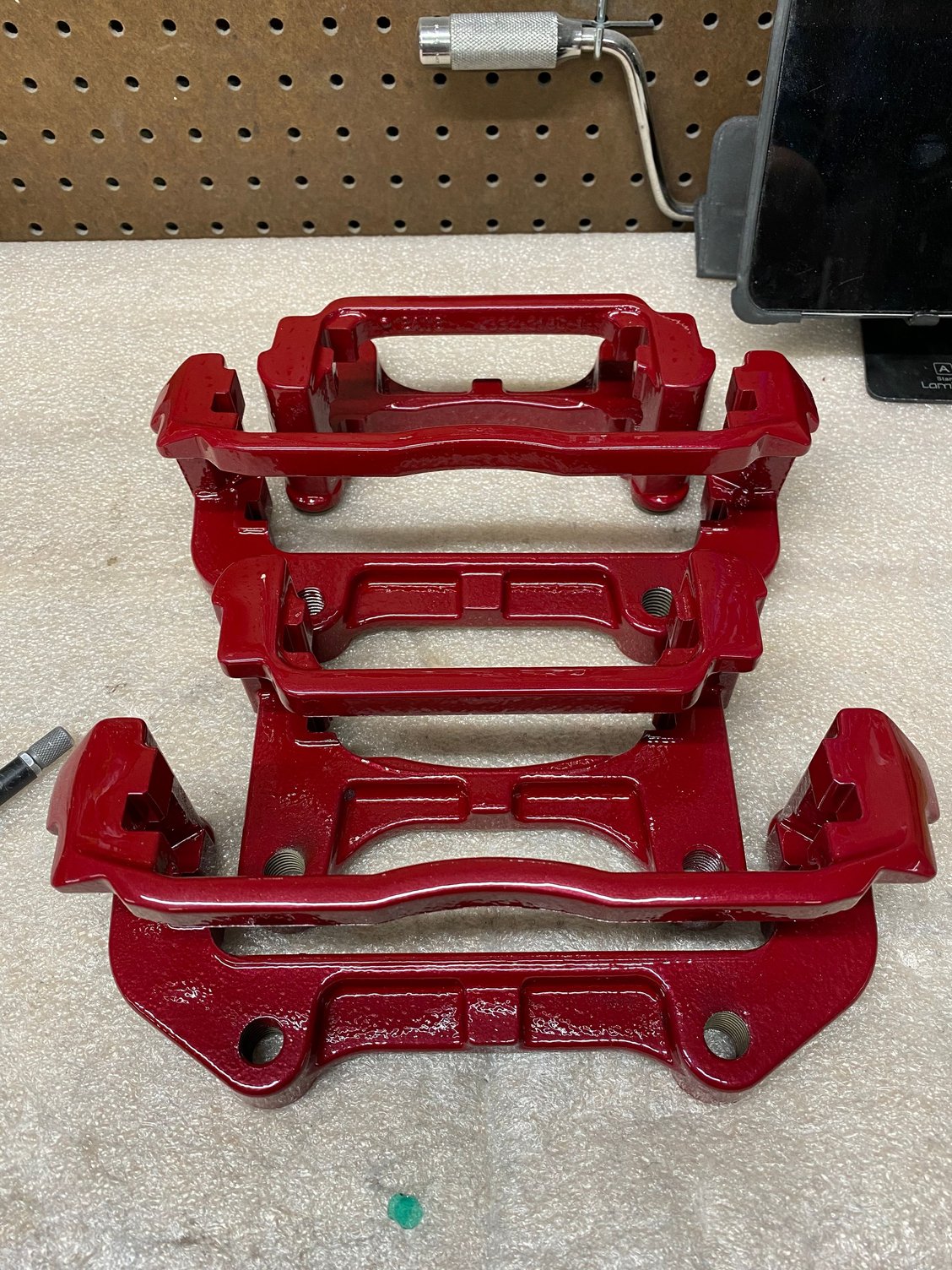

Purely cosmetic. I’ve put the C6 Z51 brake rotors and brackets on my last C6 and my current C5. Unless you’re tracking the car, the cross drilled rotors will last forever with no problems and personally, I like the look more than slotted. Facebook Marketplace is a great place to source the rotors, I’ve bought two brand new sets from owners who never got around to installing them. Even with shipping they were around half the price of new. There’s a vendor on ebay that sells aftermarket Z51 caliper brackets for $35.00 each and they’re good quality. If it’s in your budget, get in touch with Dave at Renewed Finishes about powder coating your calipers, he’s second to none and even took the time to grind down all of the imperfections and casting marks on mine.
those look great!
Your calipers look awesome. Nice job by the vendor.
