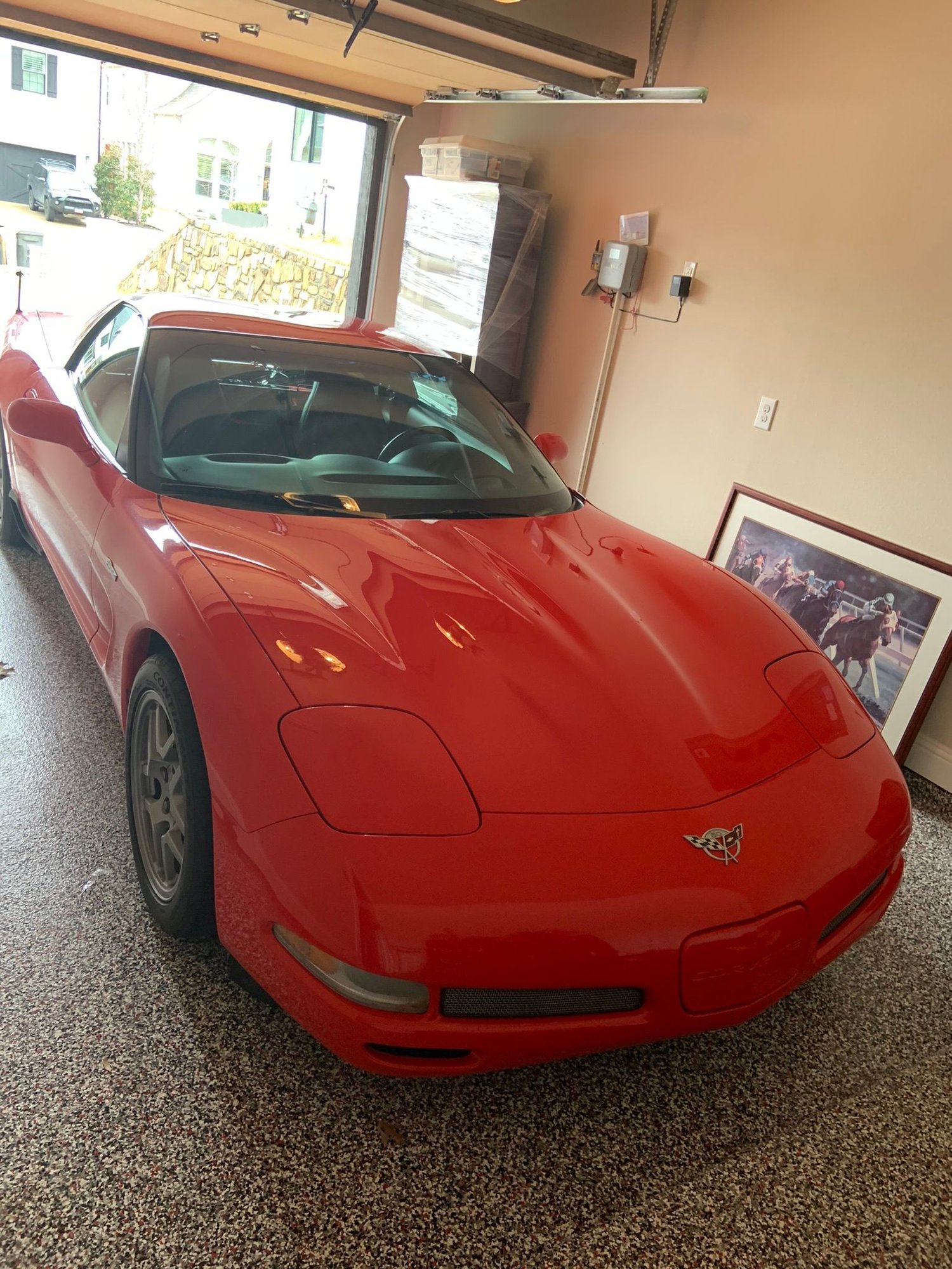

Just got home before the hail storm comes in! About 20 miles home on Central Expressway. Man that’s different than the past 10 years in a truck / Jeep / Land Rover. It was raining so couldn’t have too much fun. But I am excited.
