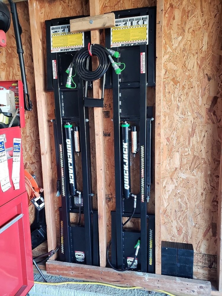

QuickJack user here. It works but its not "quick" to setup. It's really best for guys like me who can't dedicate floor space to a lift and only uses it every once in a while. (excellent value vs function though)

I do put them up every time because I simply don't have the room. Here is what I do
(the hoses I now store unrolled because when cold they are hard to control / unroll)

Thanks for the comments and Rich thanks for that pic. Cheers!!!
