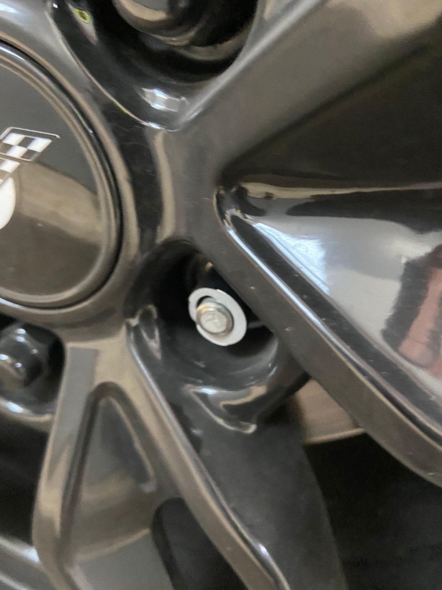

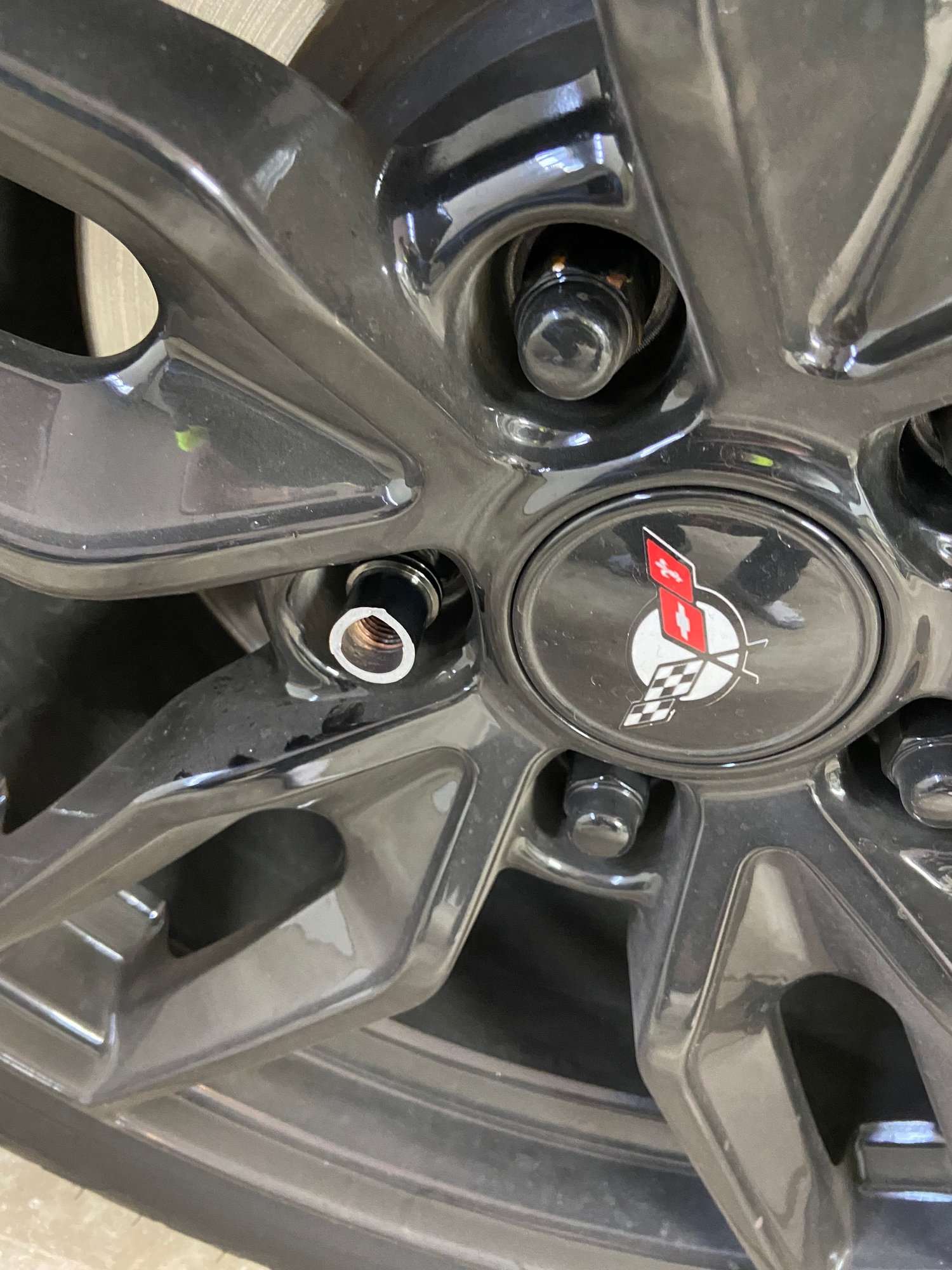

Anyone running wheel locks on the C5. I got a set of McGards and both rear nuts broke and came loose. Walked out in the garage today and notice it. Looks like maybe the wheels studs are too long for the lug nuts and it cracked the tops off.
McGards website says these are the correct nuts for the C5. My guess is previous owner changed the wheel studs along with the wheels.

Had the OEM locks on my C5 when I bought it. Have run multiple sets of McGard locknuts on multiple cars - one set aftermarket and others OEM. Never had a problem with any of them. Those pics look like the result of someone tightening the lock nut with an air impact wrench and not bothering with anything wimpy like a torque wrench.

those are c7 wheels? might the wheels themselves be 'thinner' ie expose more of the stud? just a thought.

The issue with the pictured wheel locks is that the WHEELS may not have as thick of a mounting pad as the OEM wheels, and allowed the lug nuts to cinch further down onto the stud, blowing out the cap.
