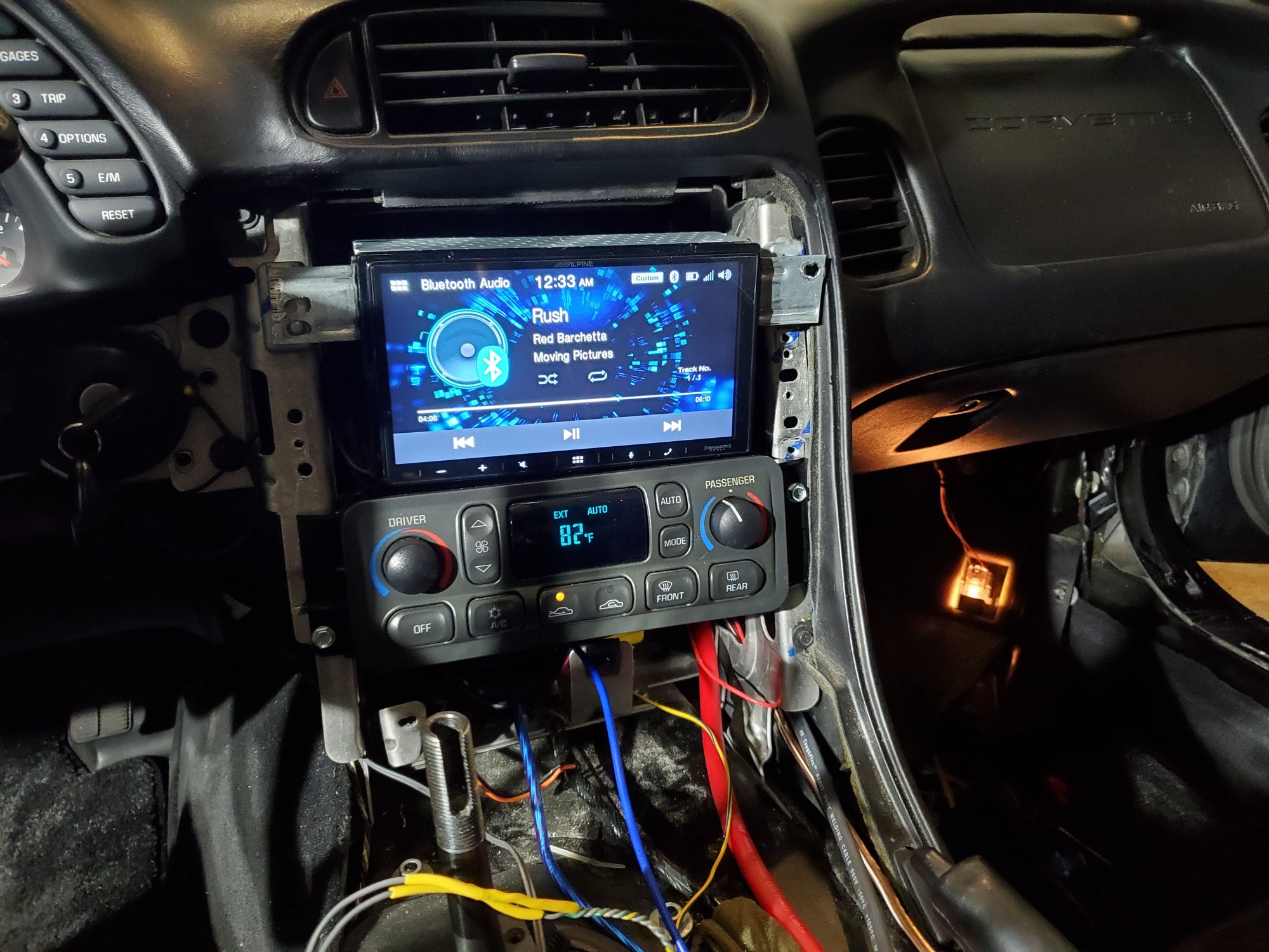

This is what I did ..for $300, the Alpine wx650 is hands down the best out there -- incredible screen, very shallow mounting depth. Uses android auto/carplay for nav, so no need for a DVD.
It's thin, cheap, AND, you can get an add-on app that adds 450watts to the amp, and straps on to the back of the head unit, so all the wiring is done right at the console. The headunit ~$500 with the amp included, or I think around $300 without the amp (runs great without the amp too, delivers 25 watts per channel)
consider this DD headunit if you're doing an upgrade... - CorvetteForum - Chevrolet Corvette Forum Discussion
Here's what it looks like installed:

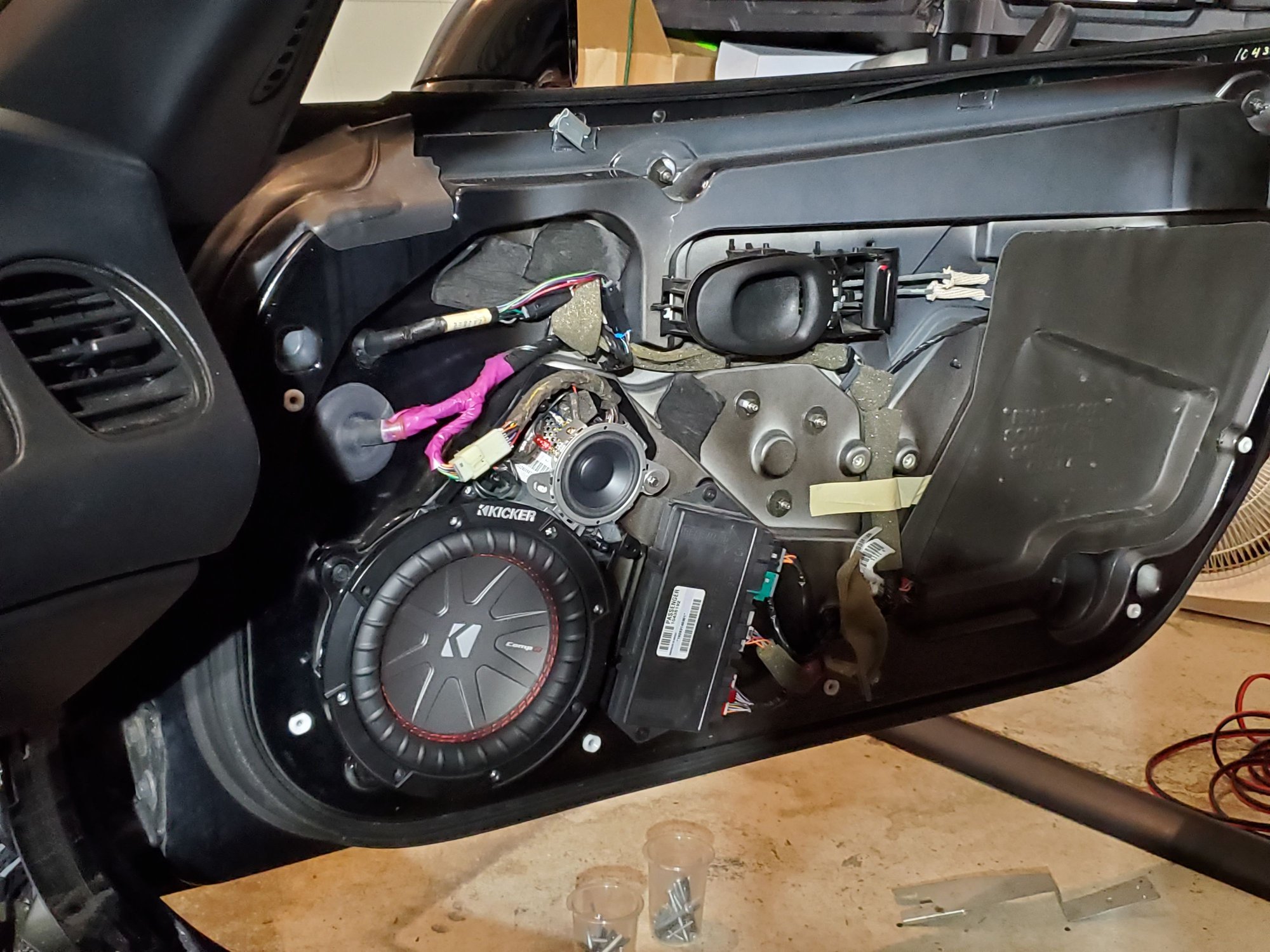

A for speaker, did hertz in the rear, audiofrog and subwoffers in the door.
these are the ones I put in the doors:
Audiofrog GS25 GS Series 2-1/2" midrange car speakers at Crutchfield
These are the subs I put in the doors:
https://www.crutchfield.com/p_206CWR...R-43CWR82.html
And here's a write up on what I did:
New install, with new 8" kicker subs in Door - CorvetteForum - Chevrolet Corvette Forum Discussion

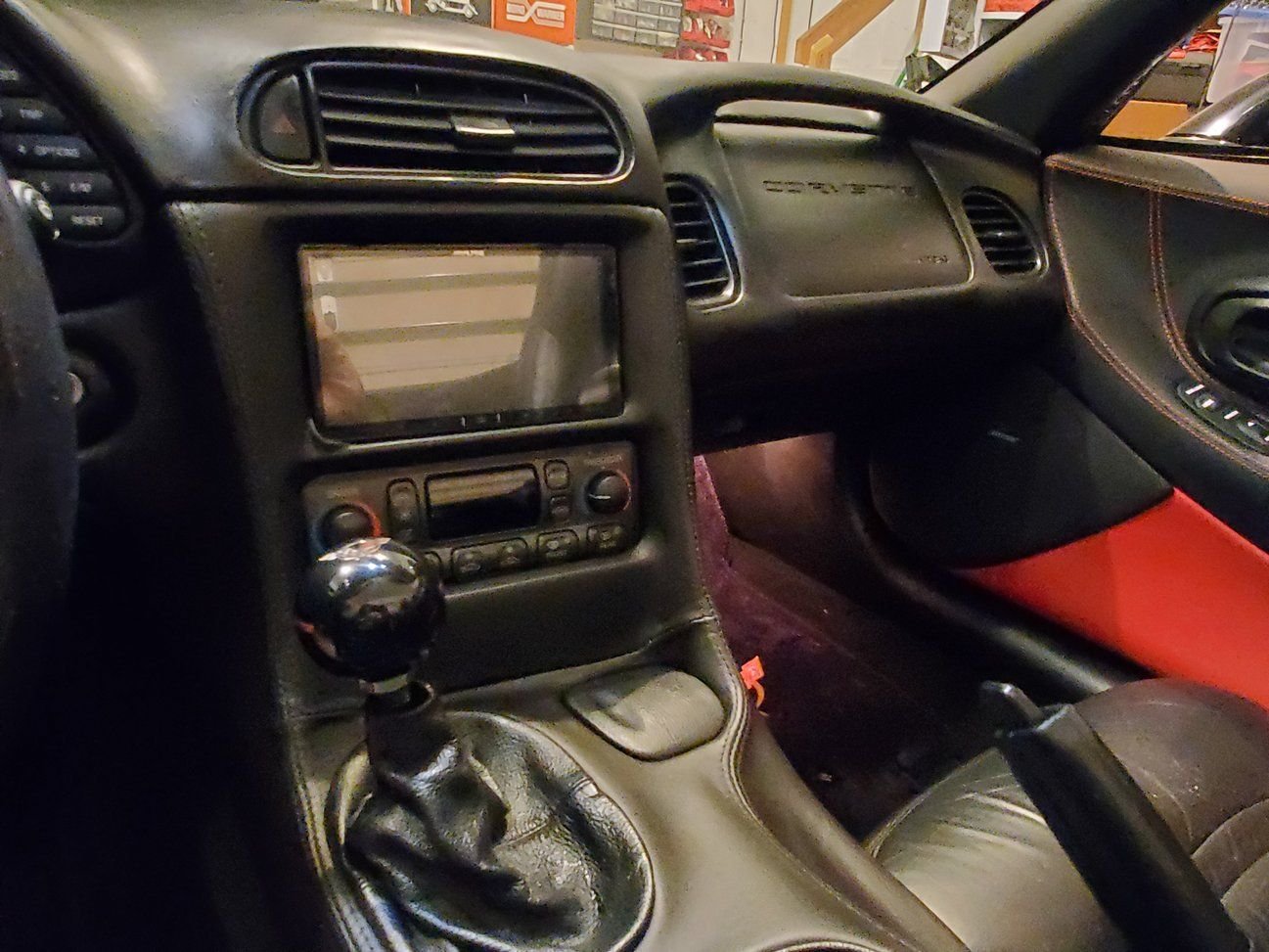

finished product:

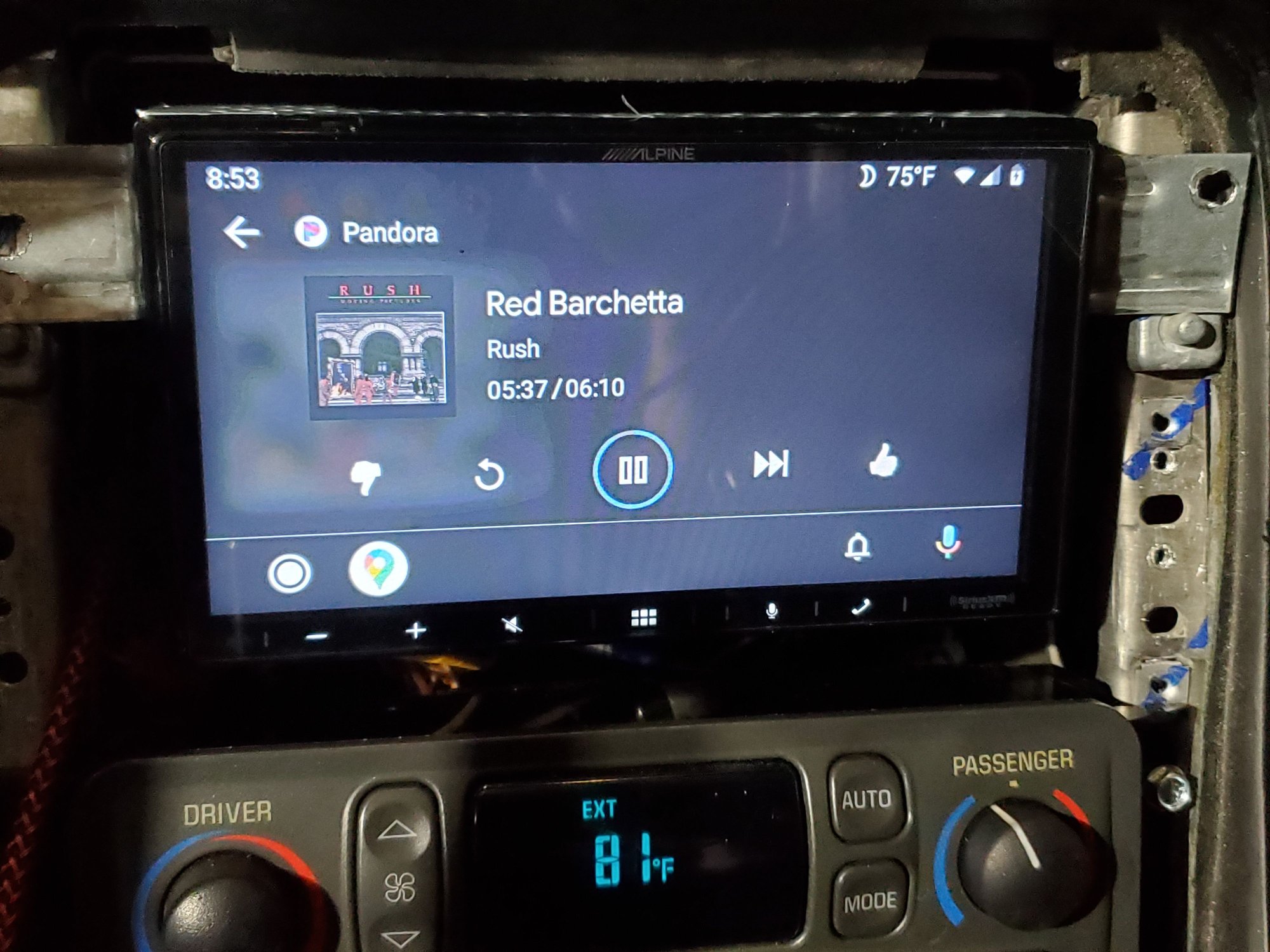

Excellent reply along with good photo's showing the details !
I am wondering what was the correct temp.......75 or 81 degrees ?

81.
The vette has a sensor that directly measures it. I was in my garage at the time and hadn't yet turned on the AC
the temp on the head unit -- I was running google play, and the temp is the temperature reported by Google for my area.
