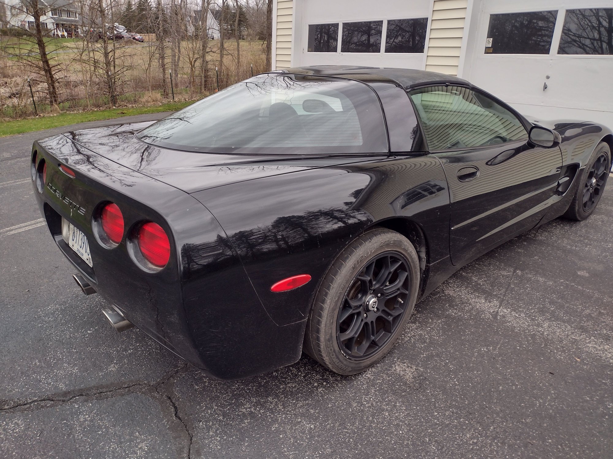

A few weeks ago I picked up this 2000 6 speed coupe. It is in rough shape and I have a pretty long list of things to take care of. It was sitting behind my buddy's girlfriends house. Apparently her ex boyfriend left it there and didn't want the car back. He was willing to make a deal so here we are. I enjoy fixing cars up and have a couple other vettes so this is a perfect project. I've been wanting to get into a c5 for a couple years but was waiting for the right deal to come along. This car has 111k on it.
First step was to look over the car and see what it's going to need. The paint is in rough shape. I haven't decided if it'll get a full paint job or just re shoot bad spots and rub the rest. The interior is very worn. Both seat covers are shot and the driver seat bottom foam is gone. Lots of interior bits are broken or missing. So far I have had good luck finding replacement parts. I got some cheap seat covers and a replacement drivers seat bottom foam. I'm not expecting too much out of the seat covers for $300 from ebay but they look nice in the box so we'll see how it goes.
It does run, drive, and stop. It was shifting rough but after a clutch fluid change and upgrade to c6 z06 shifter it is much better. The oil pressure sensor was working intermittently so would sometimes show zero oil pressure. New oil pressure sensor took care of it.

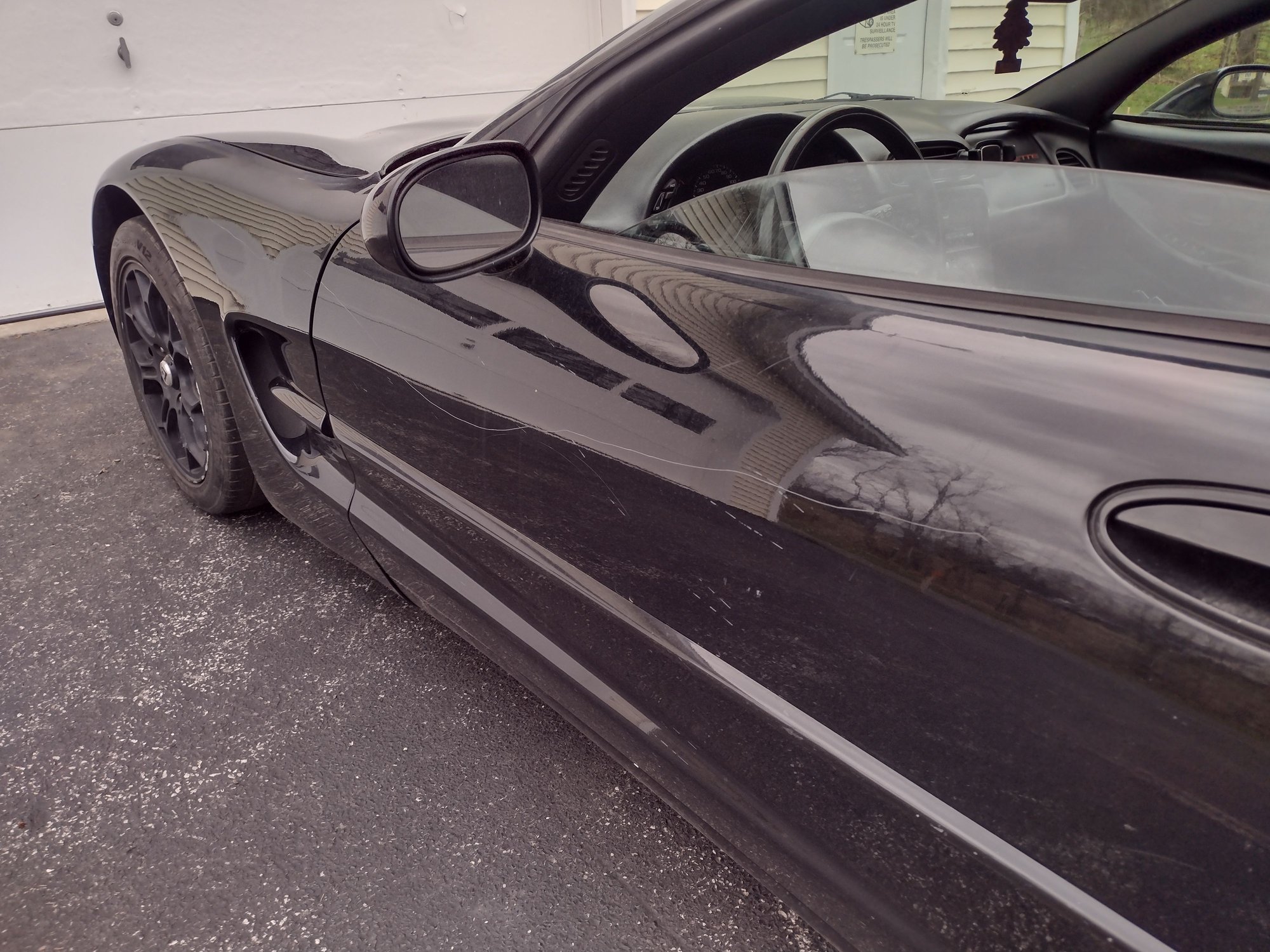

Last night I buffed a spot on the hood to see if I would be able to save this paint. It came out somewhat decent so I did the rest of the hood, the halo, and the deck lid this morning.

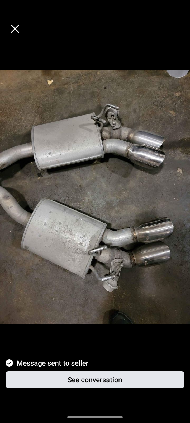

One thing I really like on some of my other cars is the npp or dual mode exhaust. I have a set of long tubes and x pipe for this c5 but don't want it to be super loud all the time. I picked up a pair of npp mufflers from a 5th gen camaro that I'm going to attempt to fit to the c5 then rig up a vacuum solenoid for control. The billy boat dual mode mufflers are wayyyy more $$ than I'm looking to spend.

Wow great job on the paint!

Also good luck withe the mufflers. Their angle will make them a challenge to work on the c5

Thanks! The paint isn't perfect but it's presentable. Considering I'm just using stuff from autozone on a harbor freight random orbital polisher. I have no idea if the mufflers will work but I have a good fabricator buddy who might be able to help. The center caps on the wheels say motegi but I'm not sure of much else
