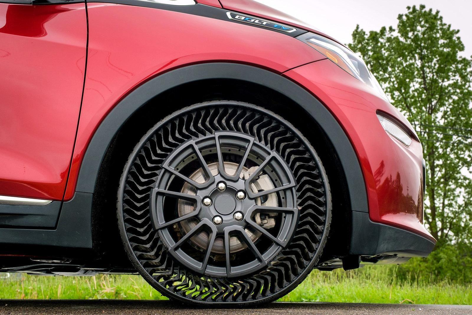

Get you some tweels

Originally Posted by jdmvette
Get you some tweels
Talk about reverse technology. Is it just me or do those wheels a lot look like C7 wheels and C5/6 calipers? Strange
In the process of changing to 18/19' and looking at full dry/summer tread style. Presently on Michelin Pilot sports

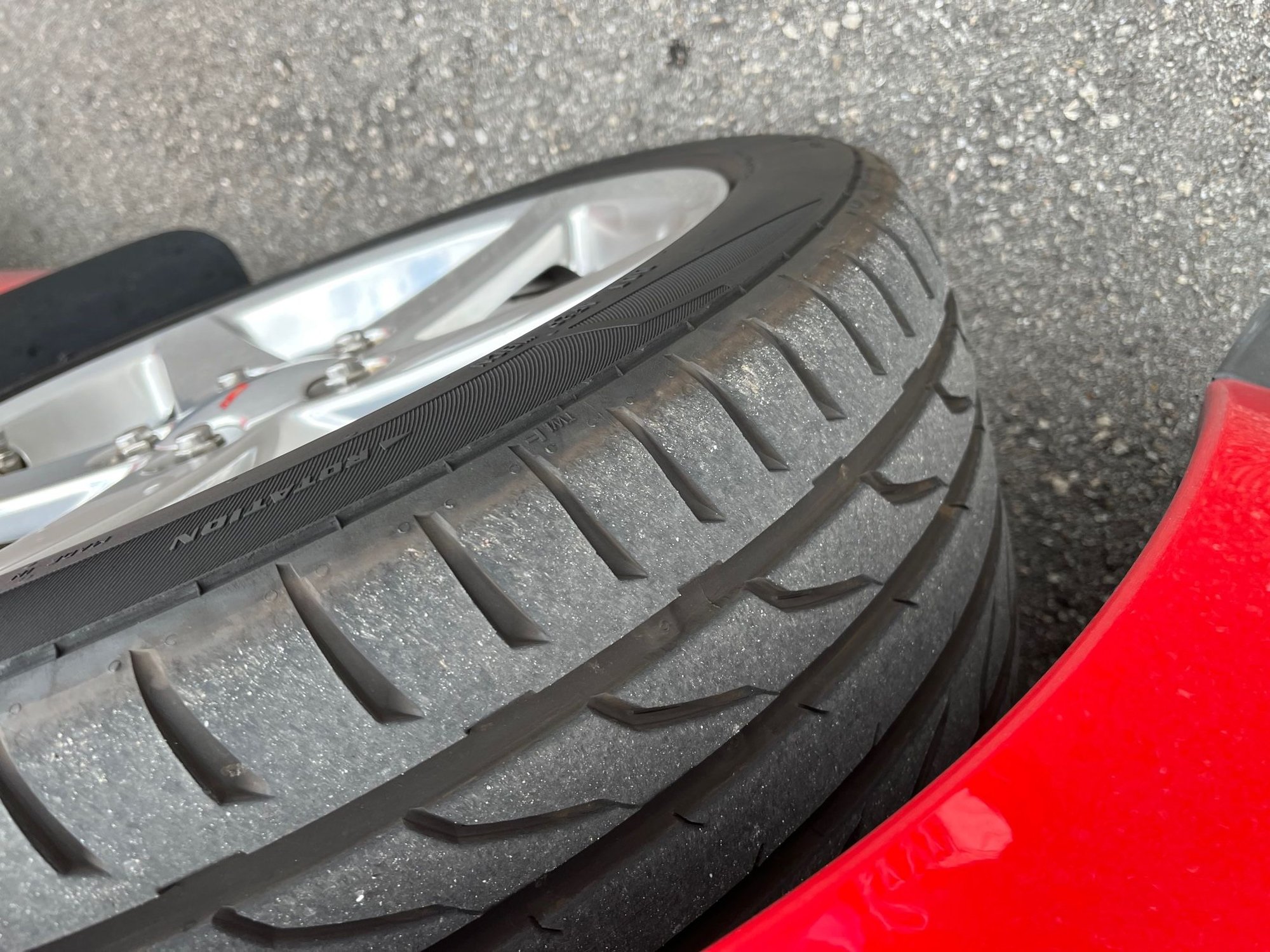

Originally Posted by HandOverFist
Just added a set of General G-Max 275/35ZR18's on the convertible...smooth and quiet thus far.
I also have the General G-Max RS Ultra High Performance Summer tires on my 2006 Convertible for 10,400 miles and really like them. I had them installed last June. I switched from run-flats. The Generals have great dry and great wet traction and better road feel and steering response than the run flats. The are great performance tires for the money. Summer tires are fine for me all year long since I am in SW Florida.
Here is a picture from a couple weeks ago. As you can see they wear very well. The rears typically do show a little more wear than the fronts.
