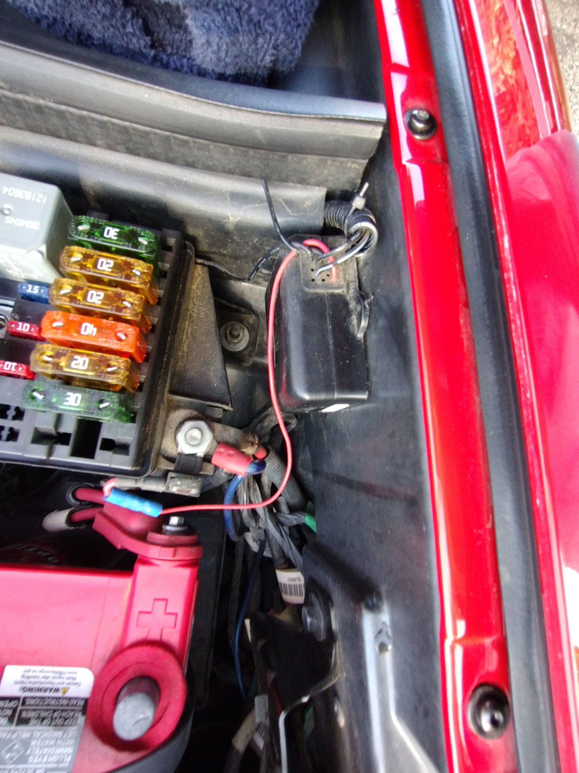

Good Day Vetters,
I was giving her a good bath and noticed this part by the fuse box under the hood. I have no idea why I hadn't noticed it before but I did this time and I wonder what it might be. The red wire and the single black wire go to different ground spots. The sticker has #919795 but I searched for that number and nothing came up. So my question is, does anyone know what part this is? I would like to pry it open because it appears to be glued on and not fastened on but I would like to know what I may be getting into. Any ideas? Thanks in advance and Cheers!!!

That is definitely not stock.
Based on the connections you've photographed for us, I would guess it's an on-board battery trickle charger.
There's another wire harness that runs out of our view, looks like it snakes toward the headlight. If you can trace that wire harness, it may give more clues (i.e. if it hooks up elsewhere or has a certain plug on the end).

Where do those black wires go?

Almost looks like a anti rust thing

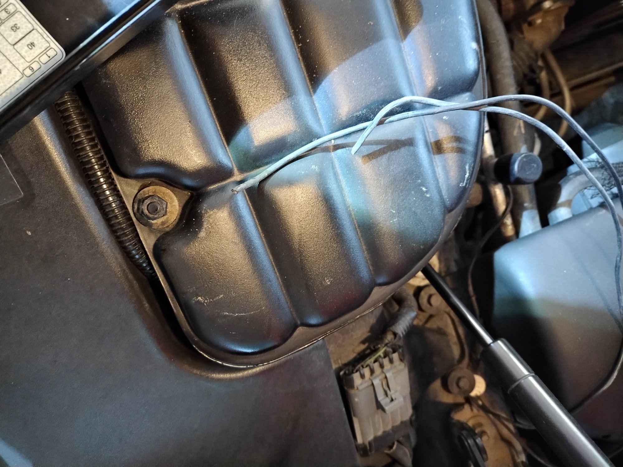

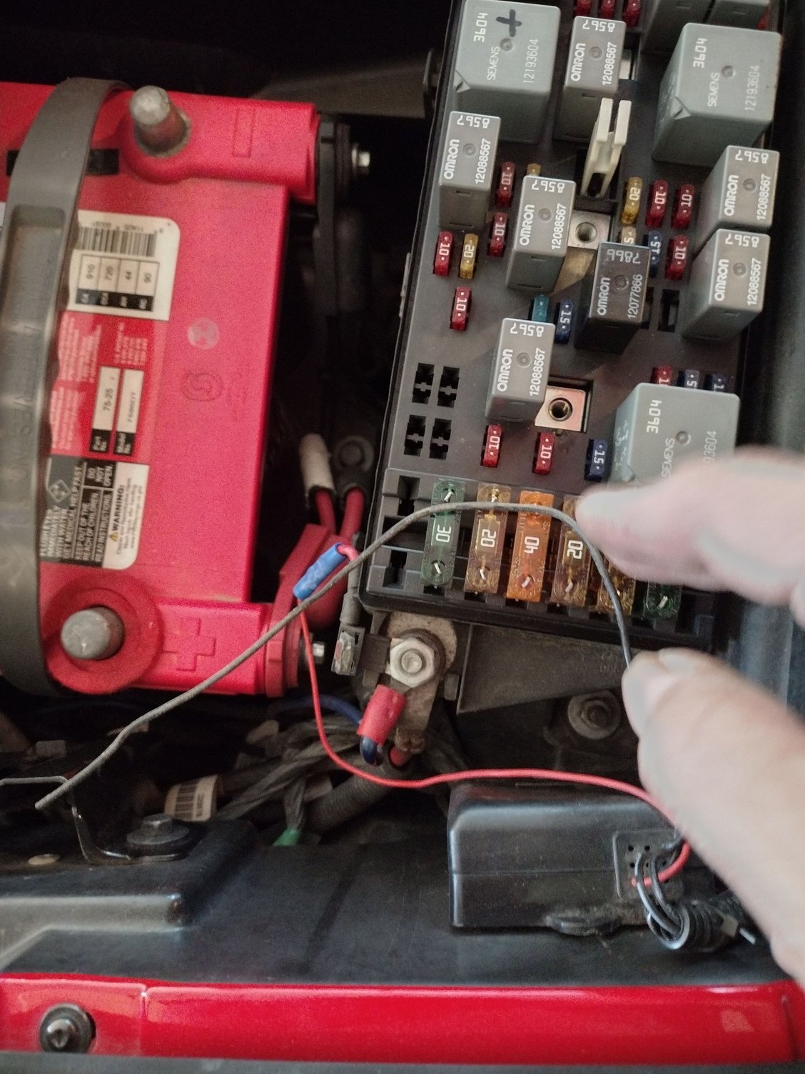

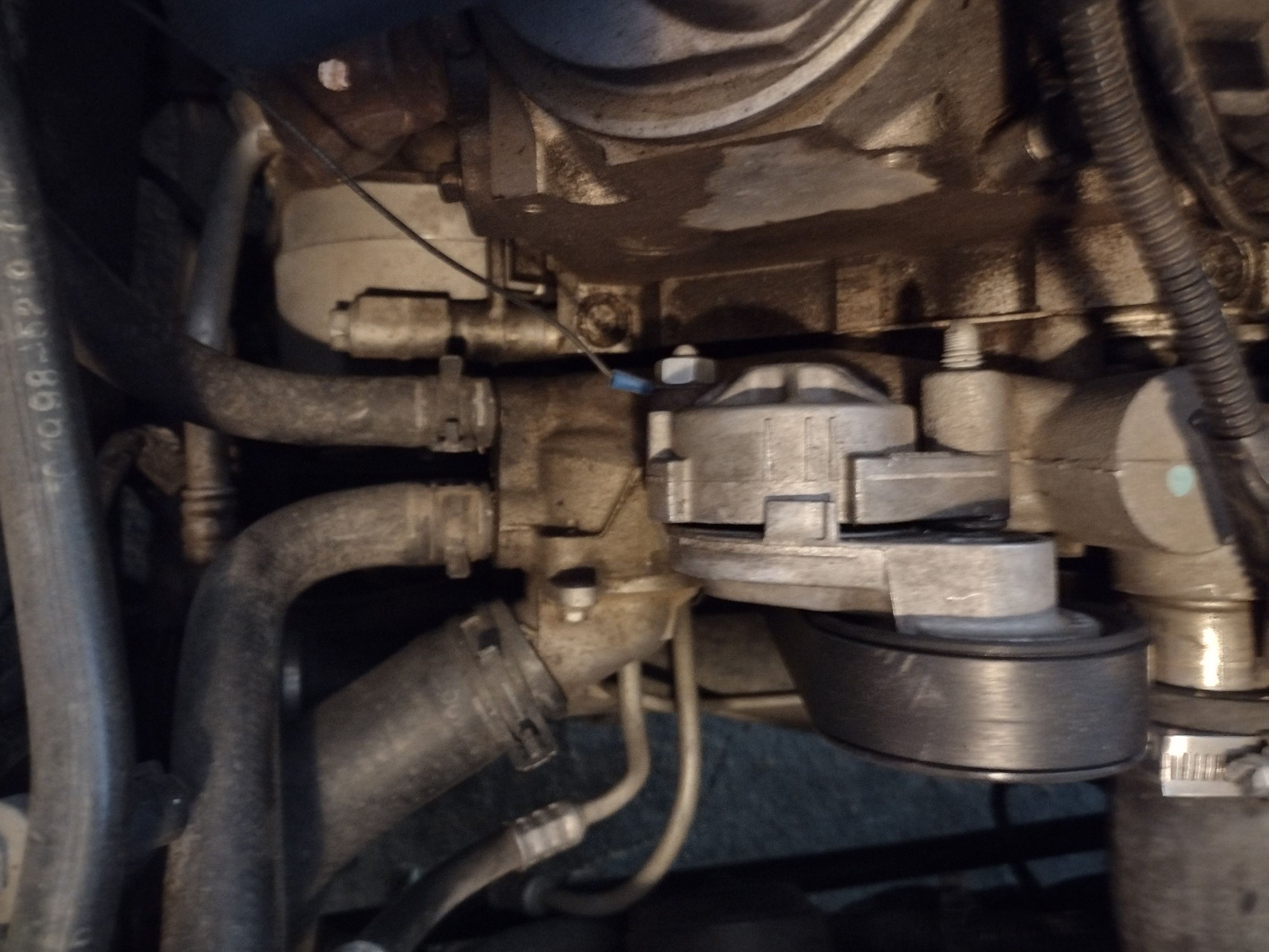

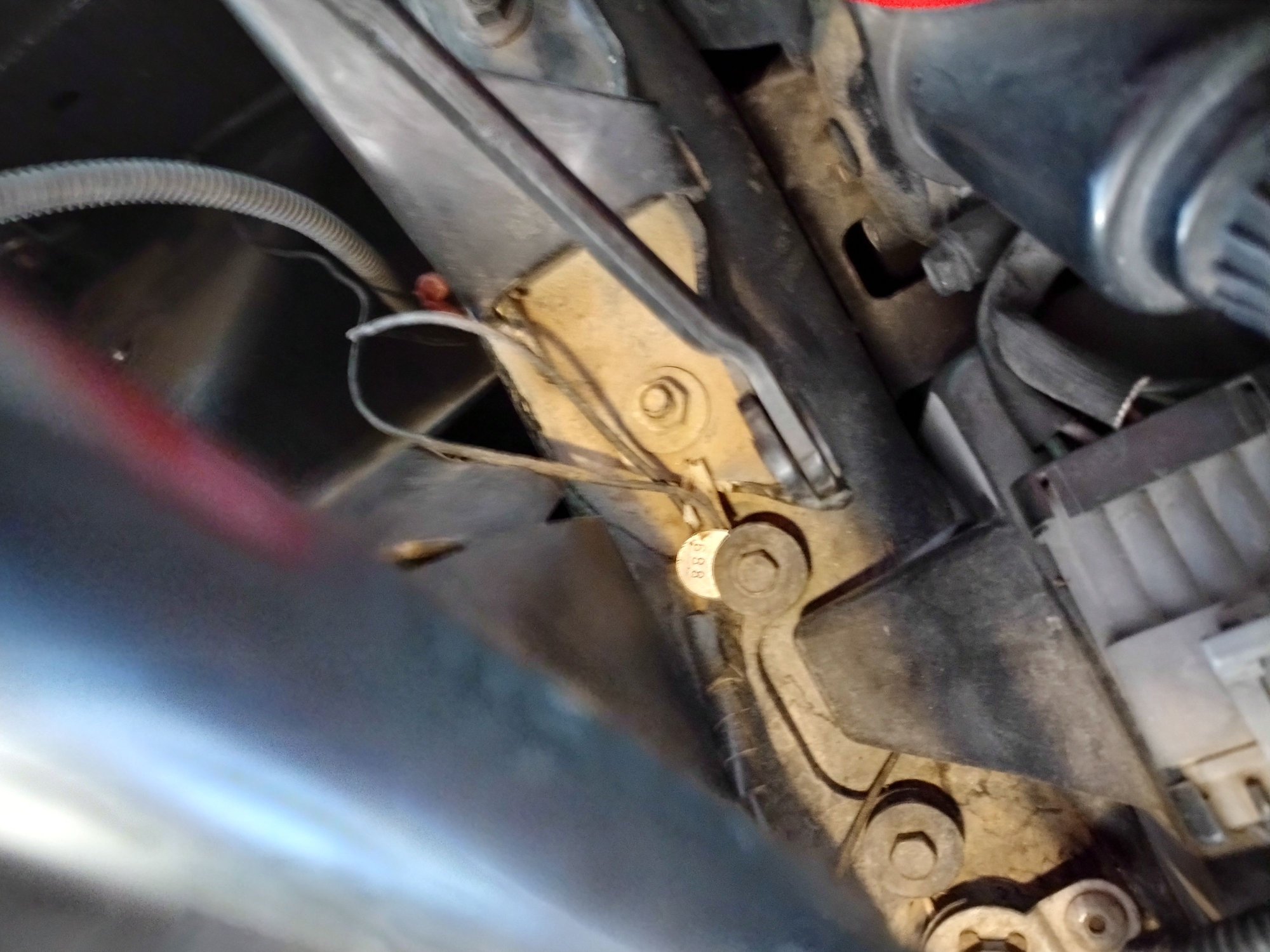

So now that that's done, I am even more confused because to me it seems to be a non-operating/functioning item. Pic 1 show one black wire disconnected, and the red wire grounded. Pic 2 shows the second black grounded as well. There are 2 black wires going through a loom and they terminate to a ground point as shown in Pic 3. In Pic 4 you can see the loom snaking down to another termination point which is also a grounding point. I pulled up those 2 black wires and they are cut!! So, I am lost as to what this part may be since it seems to be grounded in 4 points. I guess I just have to open it up to get a definitive part number or its function unless someone here knows what this part is.

Yes, that's some type of "anti-rust" gizmo, like so:
Amazon.com: Electronic Rust Protection Module for car, Truck, SUV, ATV, Boat or Trailer | Anti Corrosion Module | Electronic Rust Control Device| : Automotive Amazon.com: Electronic Rust Protection Module for car, Truck, SUV, ATV, Boat or Trailer | Anti Corrosion Module | Electronic Rust Control Device| : Automotive

Looks like it has some kind of red light near the bottom of that one side - perhaps it was part of an aftermarket alarm system for the car?

I finally got around to pulling this part off to see what its purpose is and if I am correct, I am surprised that it was located where it was. First, pulling off the part and opening it up didn't reveal much as to the manufacturer so I started pulling off all the number sequences from the electrical parts and looking them up. There were several sequences that turned up nothing including the PCB part number. Only 1 part number sequence gave me a clue as what this part was. I ran the number SC2272-M4 from the IC and it came up as a 4 channel RF remote control decoder receiver. Then I tried my FOB to unlock the doors and no joy. Based on this information my guess is that it was in fact the RC receiver for the vehicle. The reason I said that I was surprised after this finding is because I always thought that the receiver was located on the drivers side rear hatch above the RL tire.
So, my question is this. Seeing that is could be the RC receiver then I should be able to upgrade the key fob with a newer version where the keys are lowere in cost and easier to find. My fob is GM10253839 with the passive switch. I understand that the newer version fobs cost less and may not have the passive switch and are plentiful on the market.
Comments anyone? Thanks in advance and cheers!!

That box is definitely not original equipment. All C5's have the TPMS and key fob remote receiver installed in the cargo hatch behind the trunk liner above the drivers side rear tire. The same area where the gas door emergency release cable is located. If its not a rust prevention device it could possibly be part of a aftermarket remote starter or alarm system.
