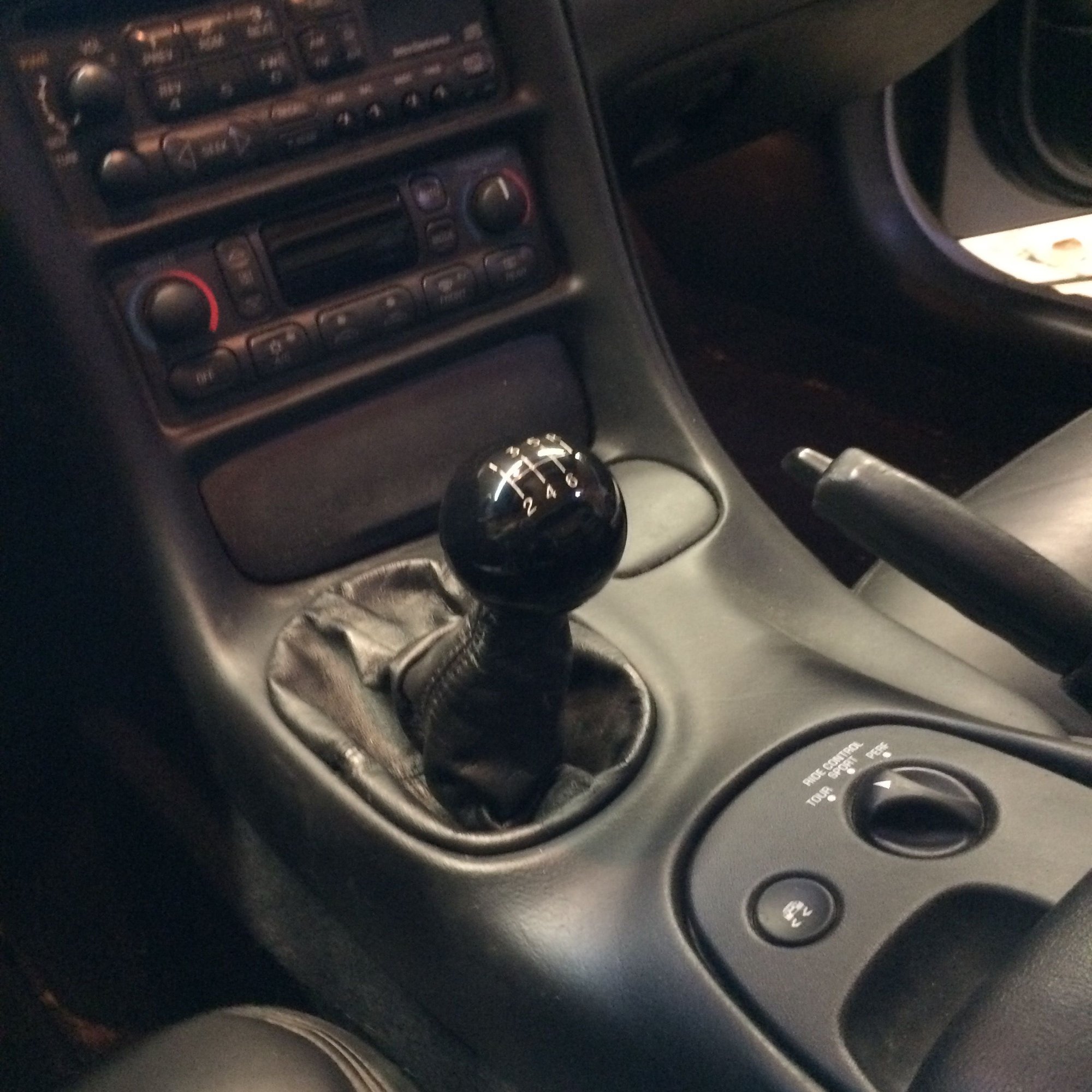

I can't remember what kind of shifter this is. I like it though. Can anyone identify? It's three letters. Is this the height you're looking for?

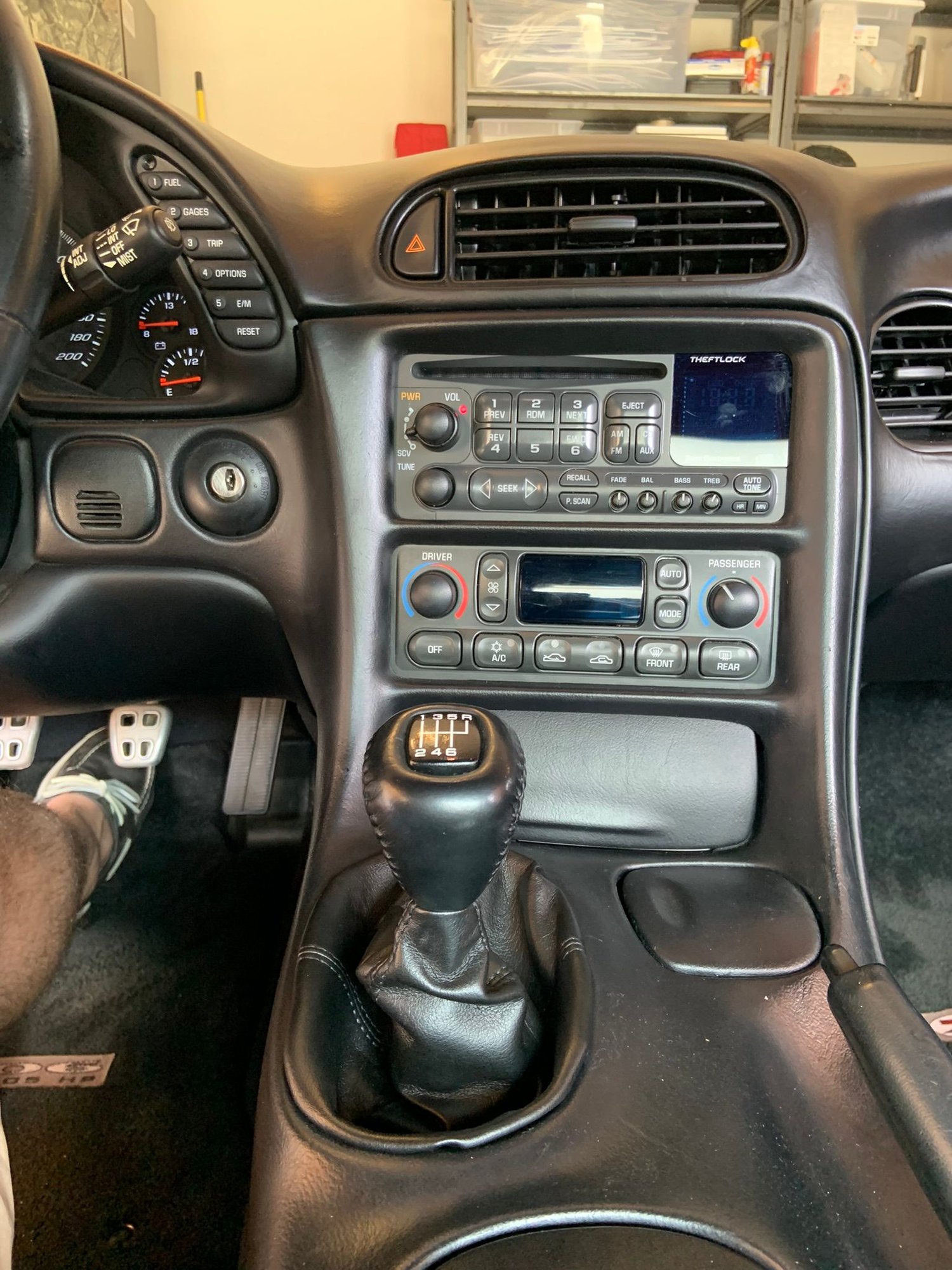

I just installed the MGW and have it set at the height you are talking about. And there is room from where I am to go higher or lower still. Very happy with the shifter overall. I kept the OEM **** for a stock look.
