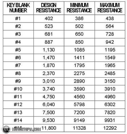

Measure the resistance of the pellet. There are 15 different ones. Order the correct number key blank. Have any locksmith cut your new key.
This is the way to go. Chevy dealer will overcharge you.
