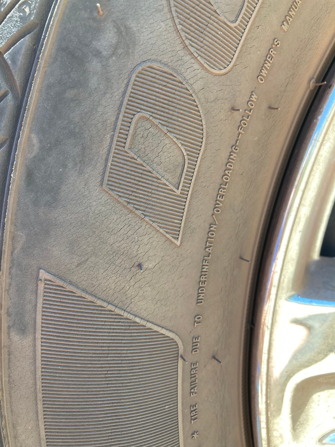

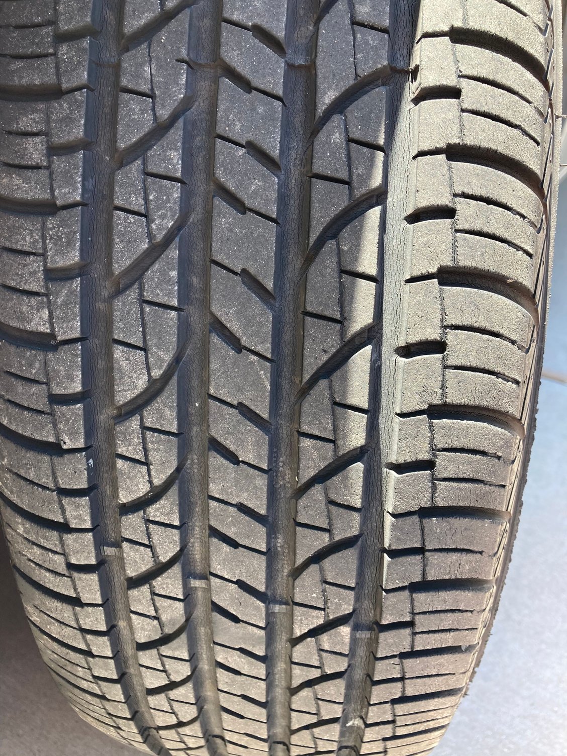

Someone here suggested looking at inside, the concrete is very hot so I only took pics of front driver’s side.
I now see the area in between patches of thread looks dry rotted.

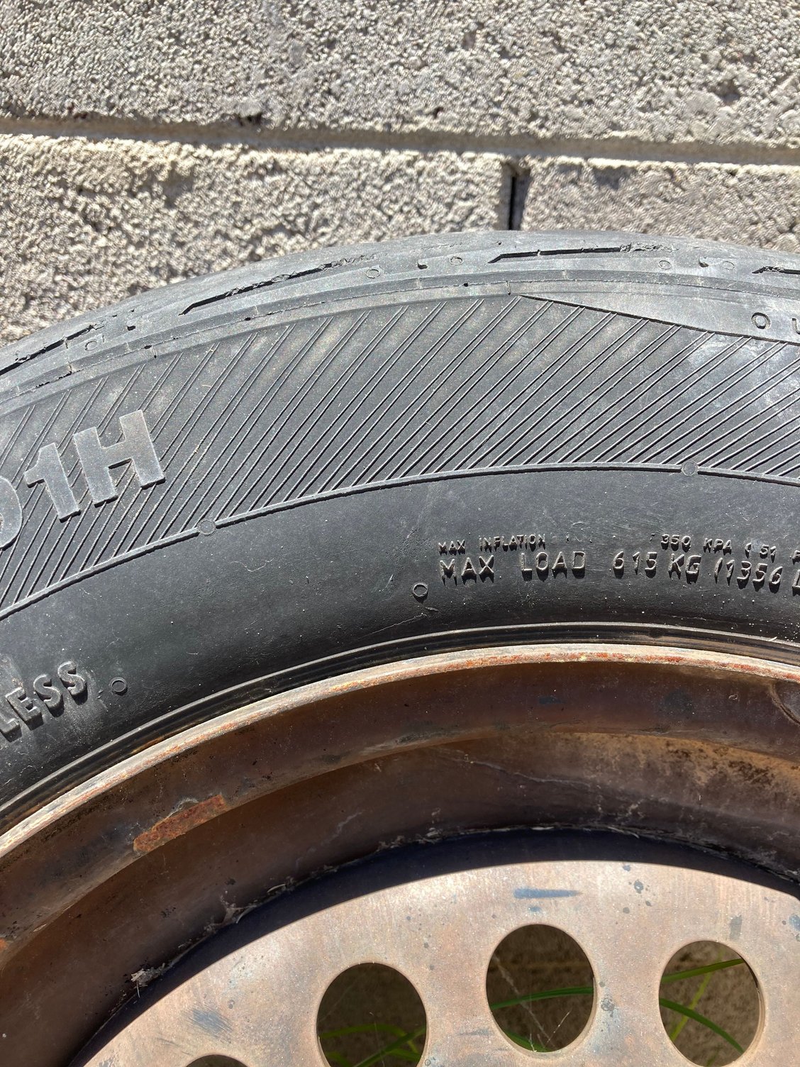

Just for kicks, another cheap brand called Barum bought for old grand am Jan 2015 at Discount tire, it seems to have less dry rot than the 2019 Douglas tires, and car was always outside.
I called Walmart and told guy about it, he claimed this happens to all cars in Arizona, and his one year old tires on his car has this, I explained I have other vehicles that don’t have this.
Will check girlfriend’s tires ASAP as they are still factory from 2018, and she parks outside.

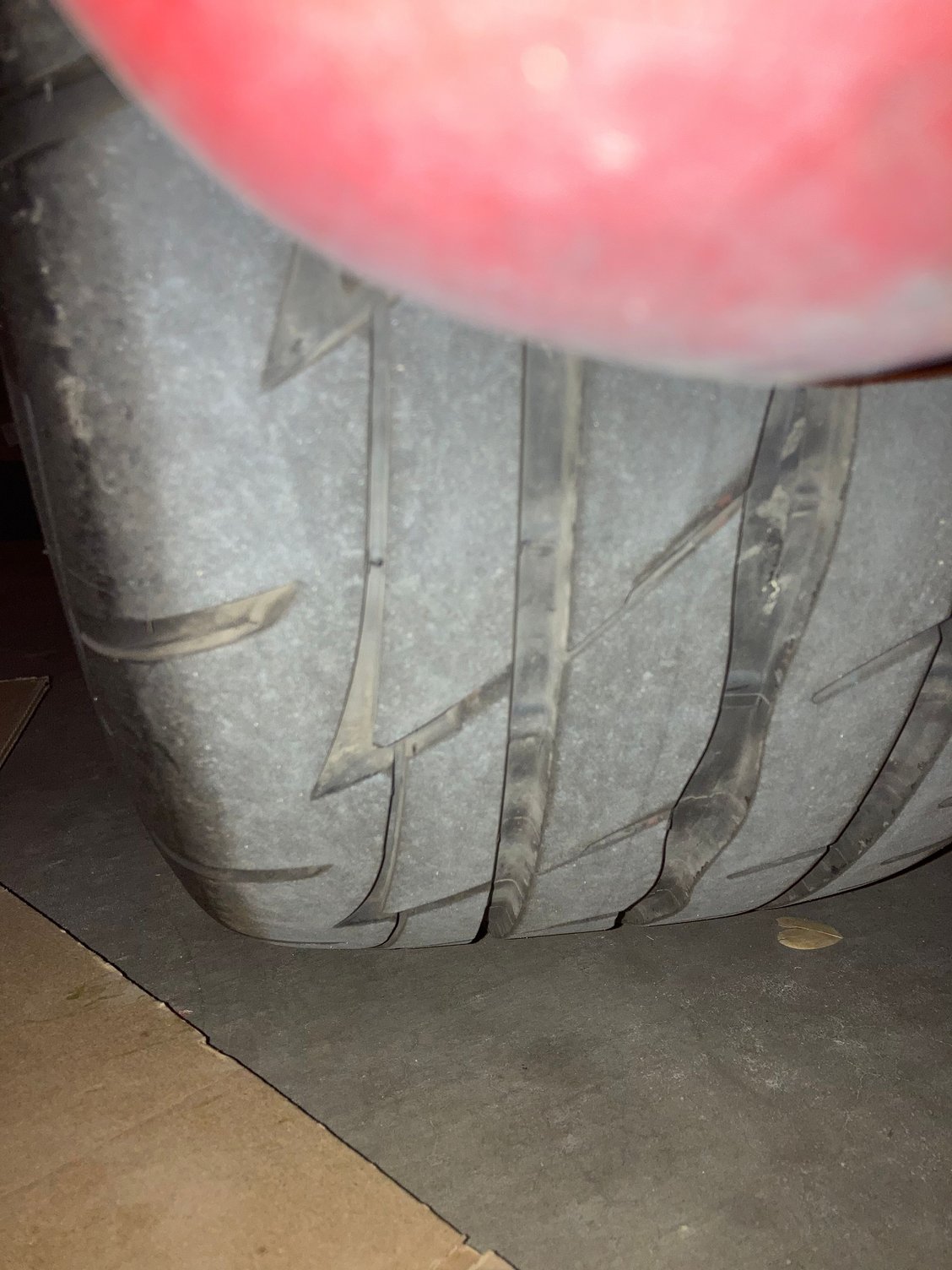

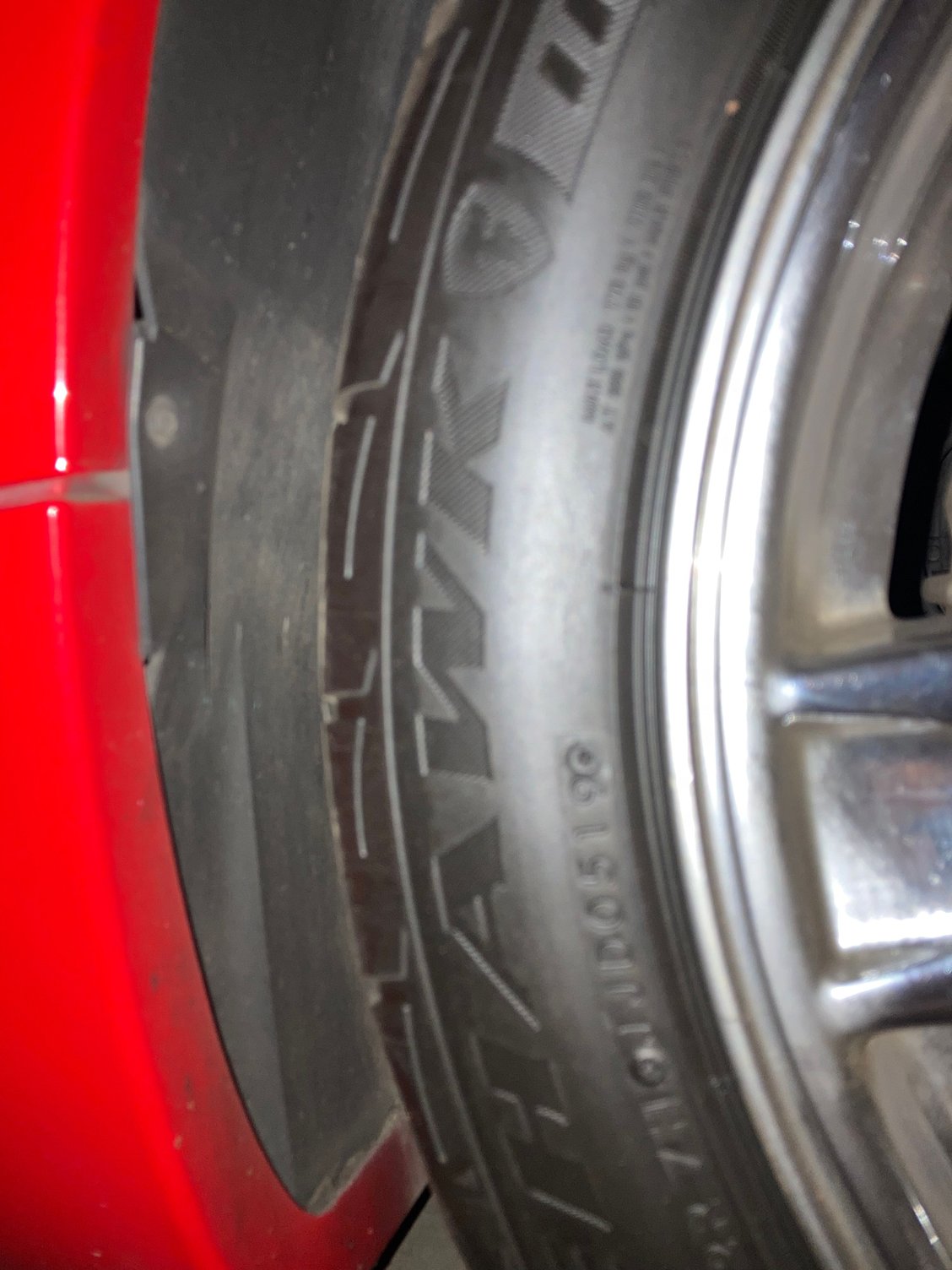

C5 tires seem fine.
