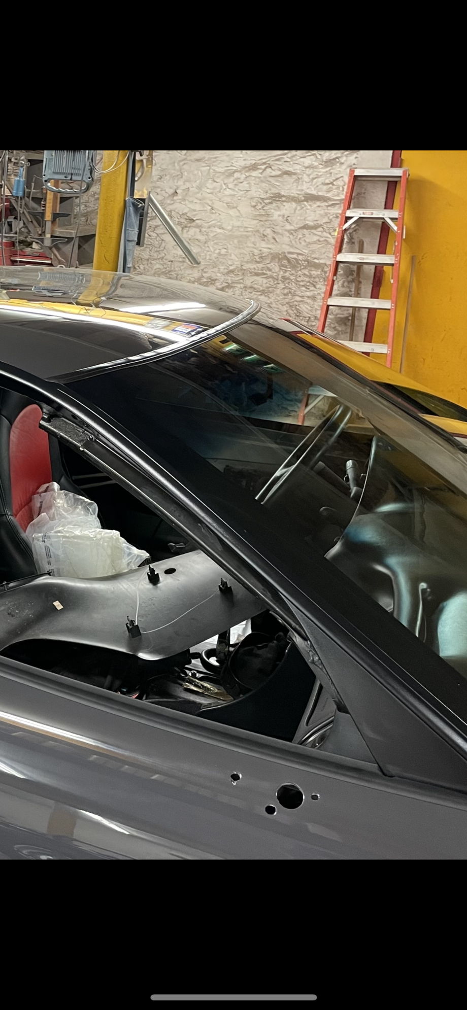

It’s doable, however, you must use caution when removing and reinstalling the molding. When pulling it’ll likely be “rippled” as shown below though a couple days in the sun will flatten it out no problem.
