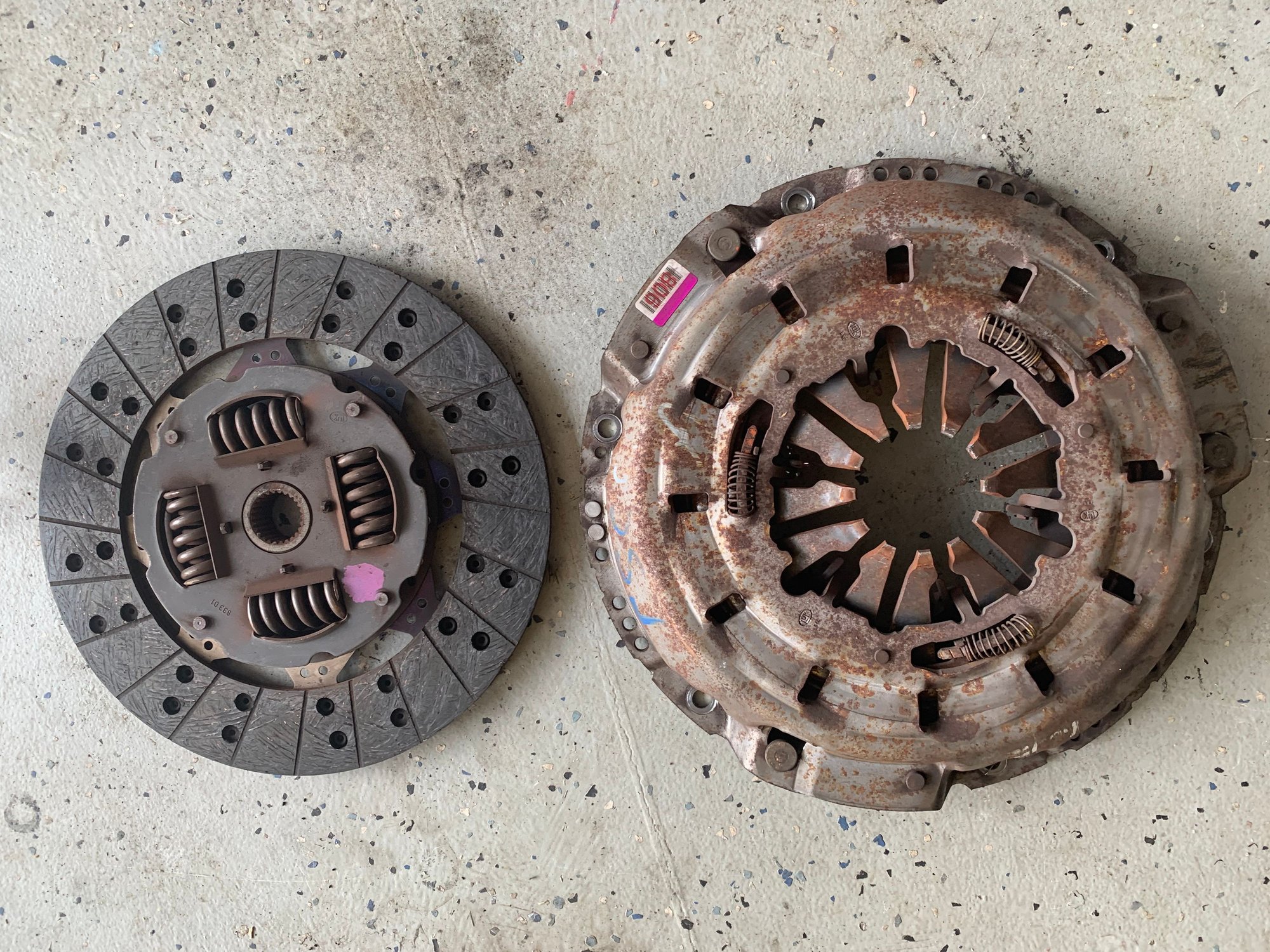

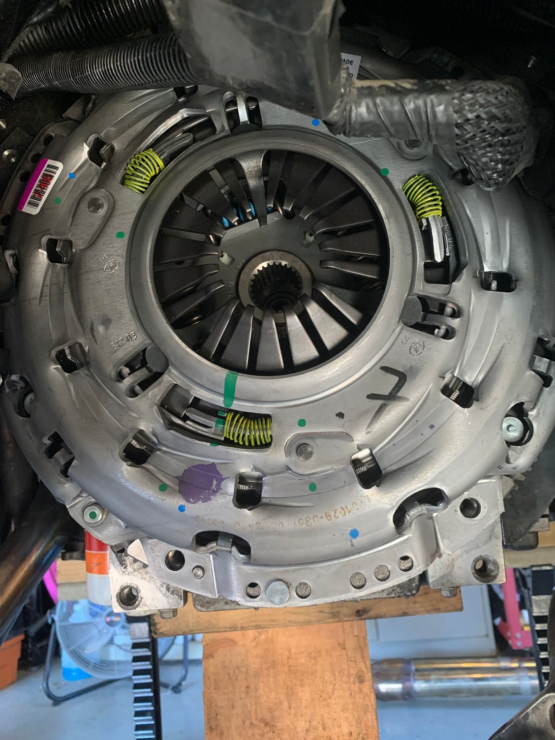

No sure there is a correct answer. Original clutch I just replaced in my 03 would grab about 1/3 of the way up or so. Just replaced it with an LS7 clutch and that grabs at maybe 1/4 the way or less. It was a shocking difference to me. Just took a bit of getting used to now it feels fine. An interesting part of the LS pressure plate is that it has progressive springs that adjust over time to account for disc wear. Here’s what my stocker looked like at 56k, and the LS7 clutch assembly below.
