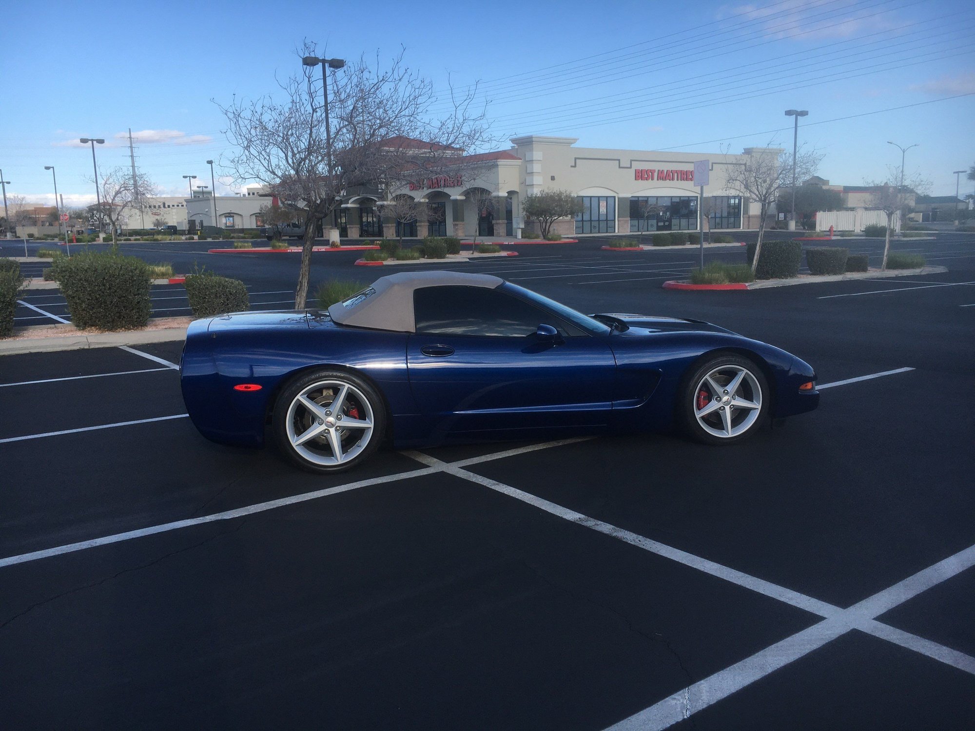

I have the Starfish wheels on my 04 vert. Was told by one of the Vette shops in Denver that they do not see those wheels very often. Did 3/4 inch hub centrics on the rear and 1/4 inch spacers on the front to bring them out flush. Used factory lugnuts. Getting 5+ turns is safe. Anything less you are taking your chances.

Looks great! Mine is the exact same color combo. Since one of my rims is being repaired for a tiny rash from some dummy that doesn’t know how to change tires, I having the centers of mine painted slightly darker to make the star pop more.
The factory silver does have a pretty good flop but it’s hard to tell when the rim is off the vehicle and in your face.
Thanks for sharing the pic! IMHO those look great. Kinda took the anticipation out of it. LOL

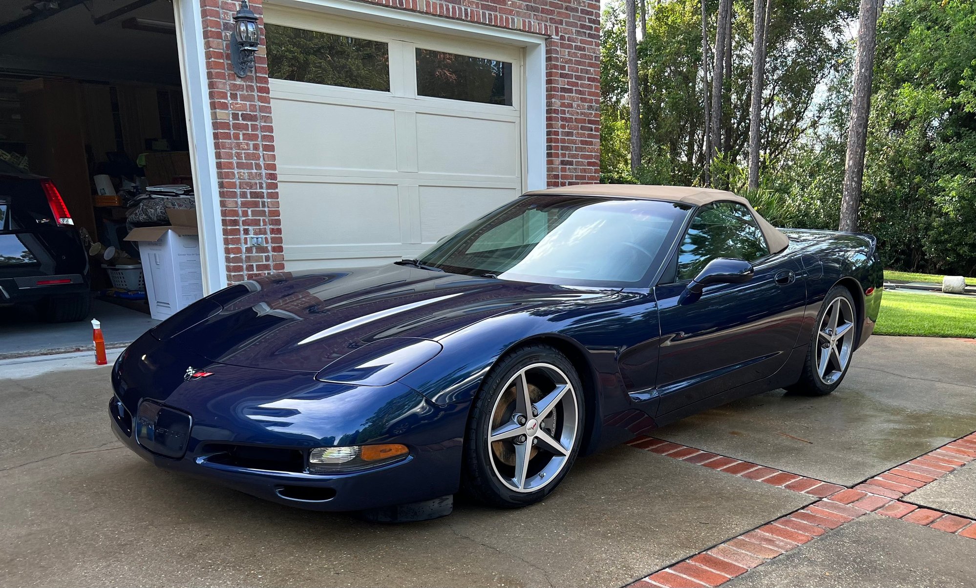

I had the center darkened to make the star pop alittle more.
