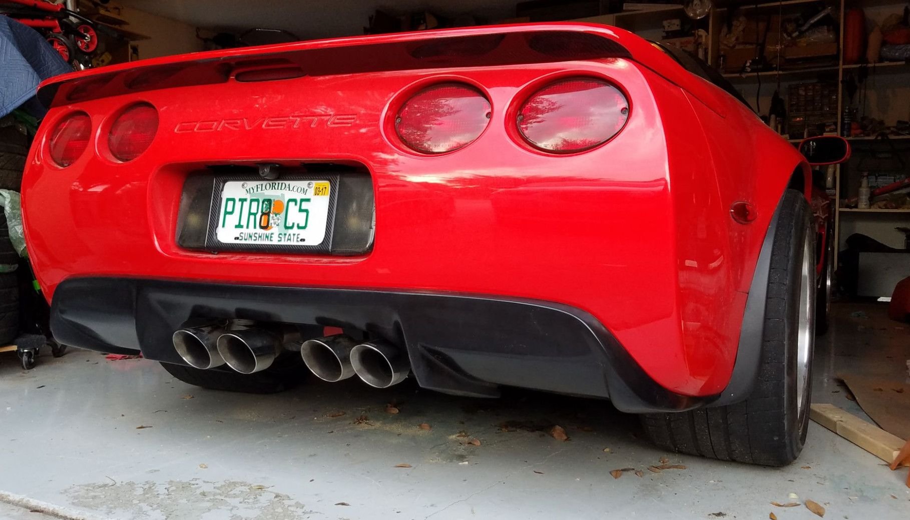

Recently installed mine, couldnt find instructions neither. I put heavy duty dble side tape on the lip of the diffuser, lifted the rear end, removed the nuts that hold the mufflers' up and stuck it on. I also drilled holes on each side of bottom end piece and used bolt for extra support.

I think these look a like diffusers are fine. But a real diffuer
means cutting the bumper and bolting the diffuser on,
and attaching the tray under the car.
