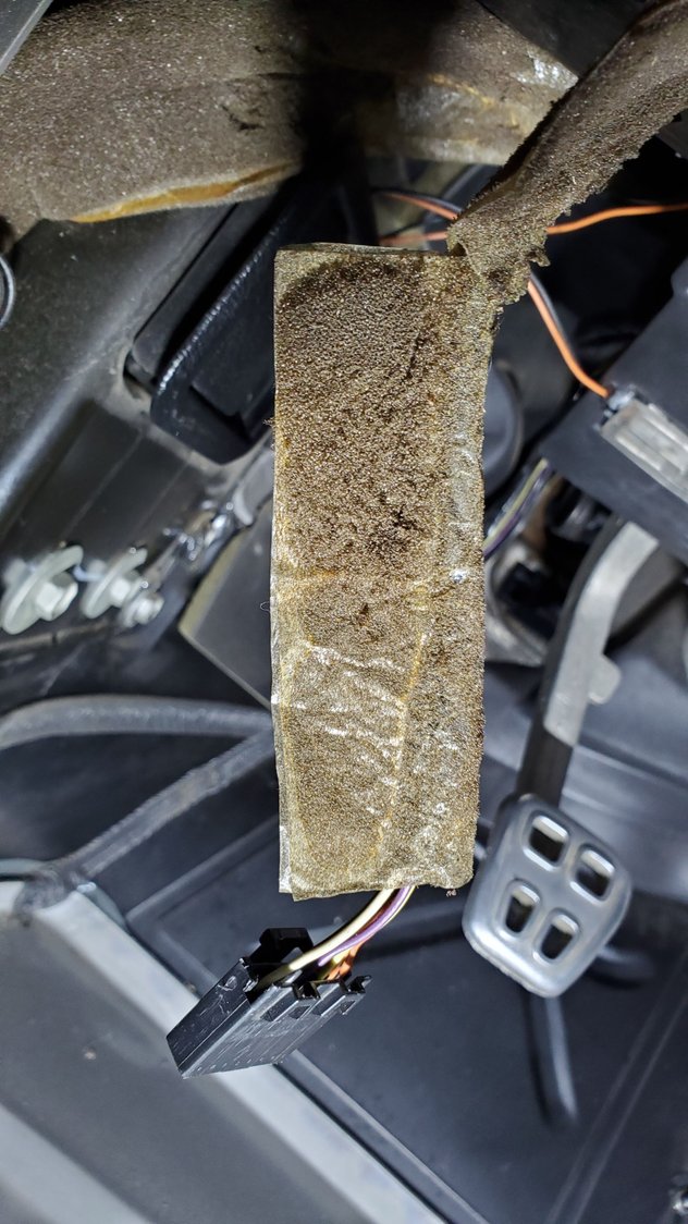

A lot of the wiring under the dashboard has this padded foam wrap which has mostly disintegrated over the years. Now the foam has mostly crumbled, and whenever you handle them, it's a mess of sticky residue. I'm not even sure what they're called, but I'd like to remove these strips while I'm working in an area and replace with something. It's padded for a reason, so I don't want to compromise their intended function. What are my options? I have rolls of Tesa tape.
Thanks.
driver's side footwell wiring harness

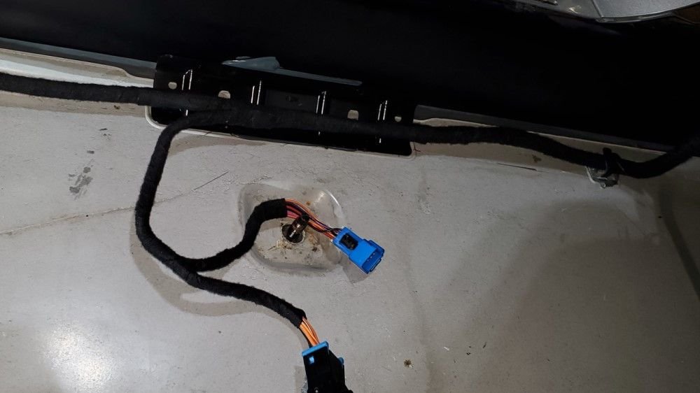

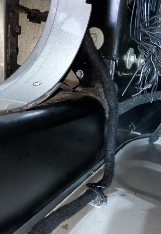

It cleaned up nice. Here is the wiring loom which goes from the bottom of the D/S A pillar all the way back to the antenna box on the B pillar including the seat connectors. You may notice the gobs of loose ground wires and missing ground pack...I'm going to ground those directly to the metal just below the hood pull lever with ring terminals.
D/S A pillar. 19 black wires cut from ground pack to secure direct to the frame.
replaced the 2 plastic wire push channel things (top middle) while I was at it.
B pillar antenna module. Cleaned the ground while I was there.
