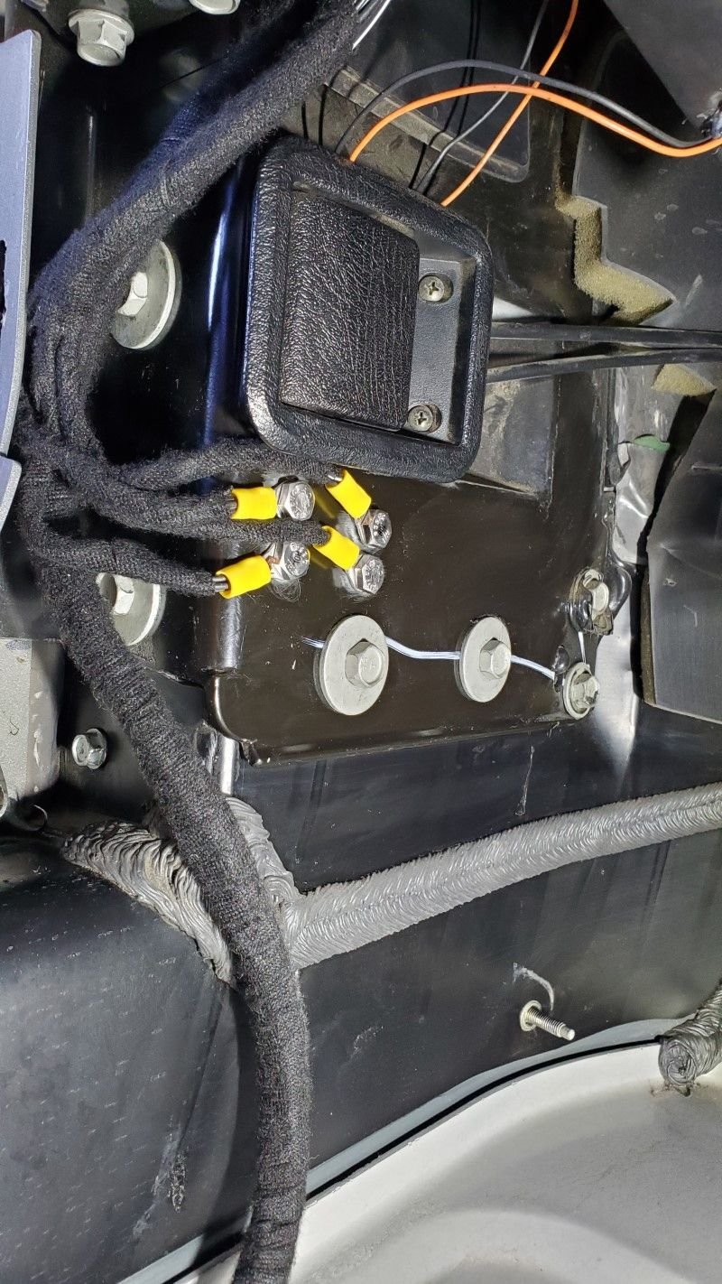

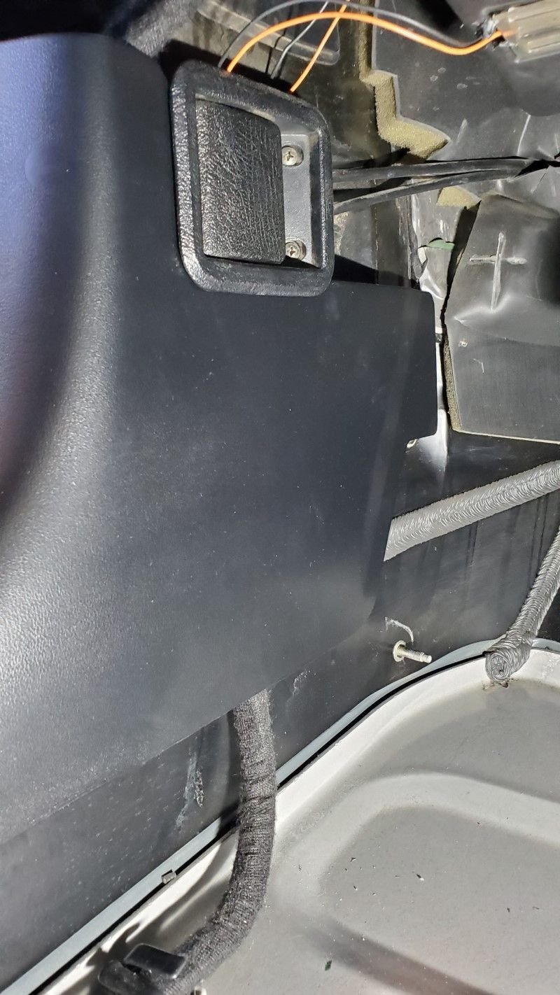

aaaand we're done. Ground wires all buttoned down.
driver's side A pillar
Ground wires all snugged into the frame with ring terminals & star washers against bare metal. Finished off with a good dab of dielectric grease.
