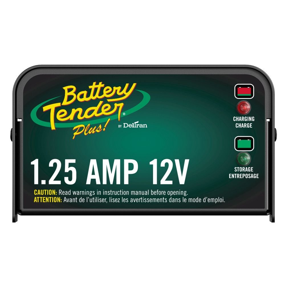

If the area your storing the C5 for the winter has electricity, why not just use a Battery Tender

If feasible, using a battery tender will keep the battery topped off and ready to go when you are.

Agreed on the battery tender. Any time I’m not driving mine for more than a week I put the tender on it. I even have a fairly pricey Odyssey AGM battery and it starts to drop off significantly after sitting for just two weeks. c5’s are known to have noticeable parasitic drain. A battery shut off switch would be a bad idea on a modern car like this, bound to cause problems completely shutting it off/on all the time, would not recommend it.
