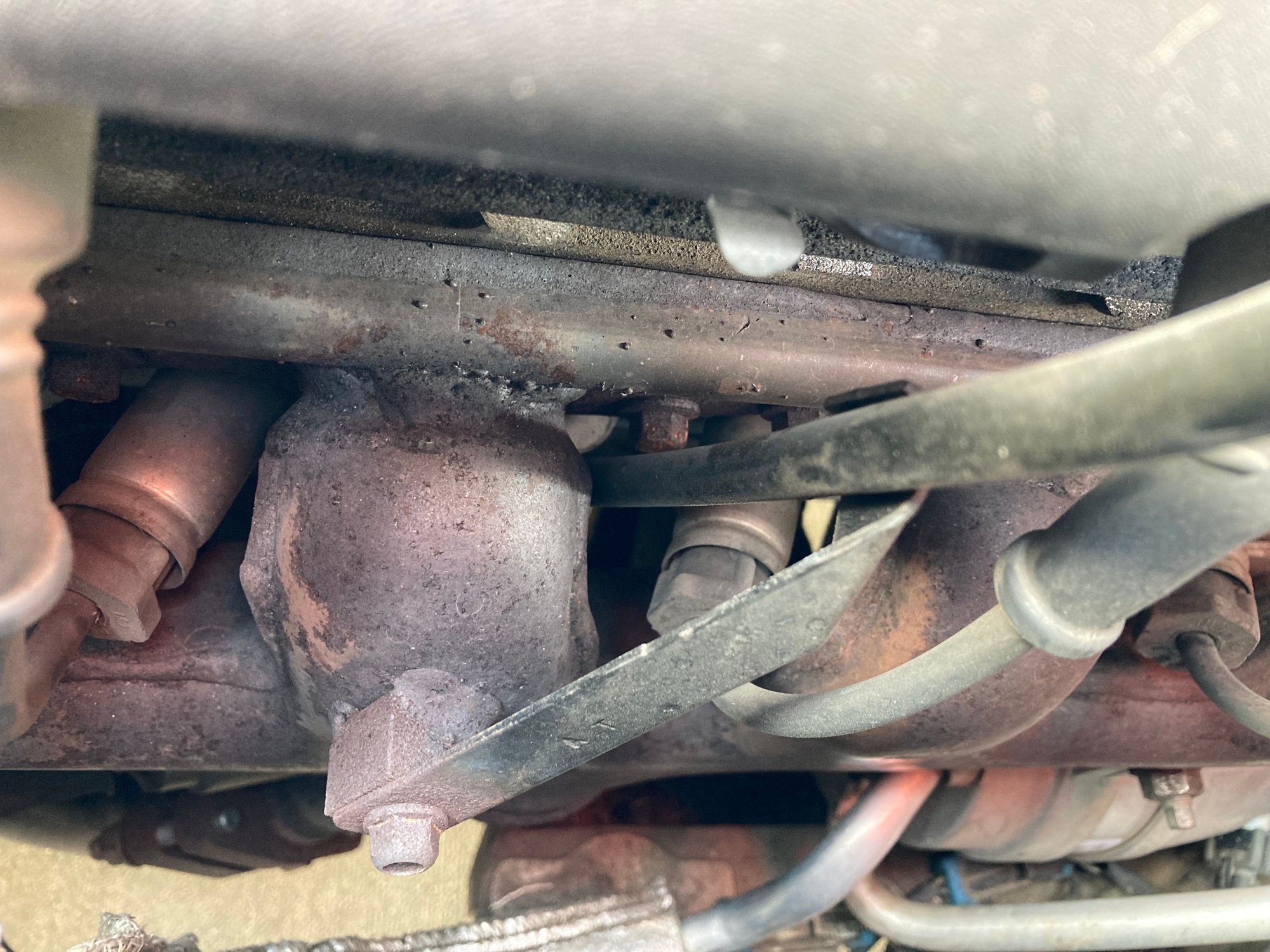

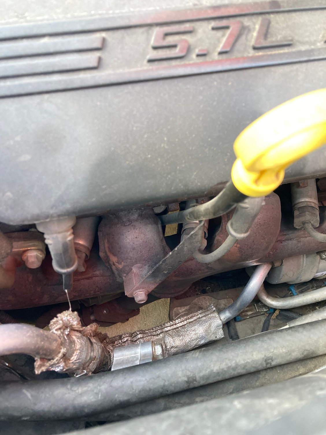

Originally Posted by Cekgsk
Checked their website. I have a '98. What is the dipstick tube needed for? I see it's required.
The early C5 has the dipstick tube bolted to exhaust manifold, later dipstick tube bolts somewhere else, this is my 1999.
Someone said they pulled dipstick tube out turned it half spin and bent the tab some and bolted to head.
Right behind dipstick tube you can see a bolt head that looks like the same size as the bolt that holds tab onto exhaust manifold, maybe that location could work with some slight bending of dipstick tube tab.

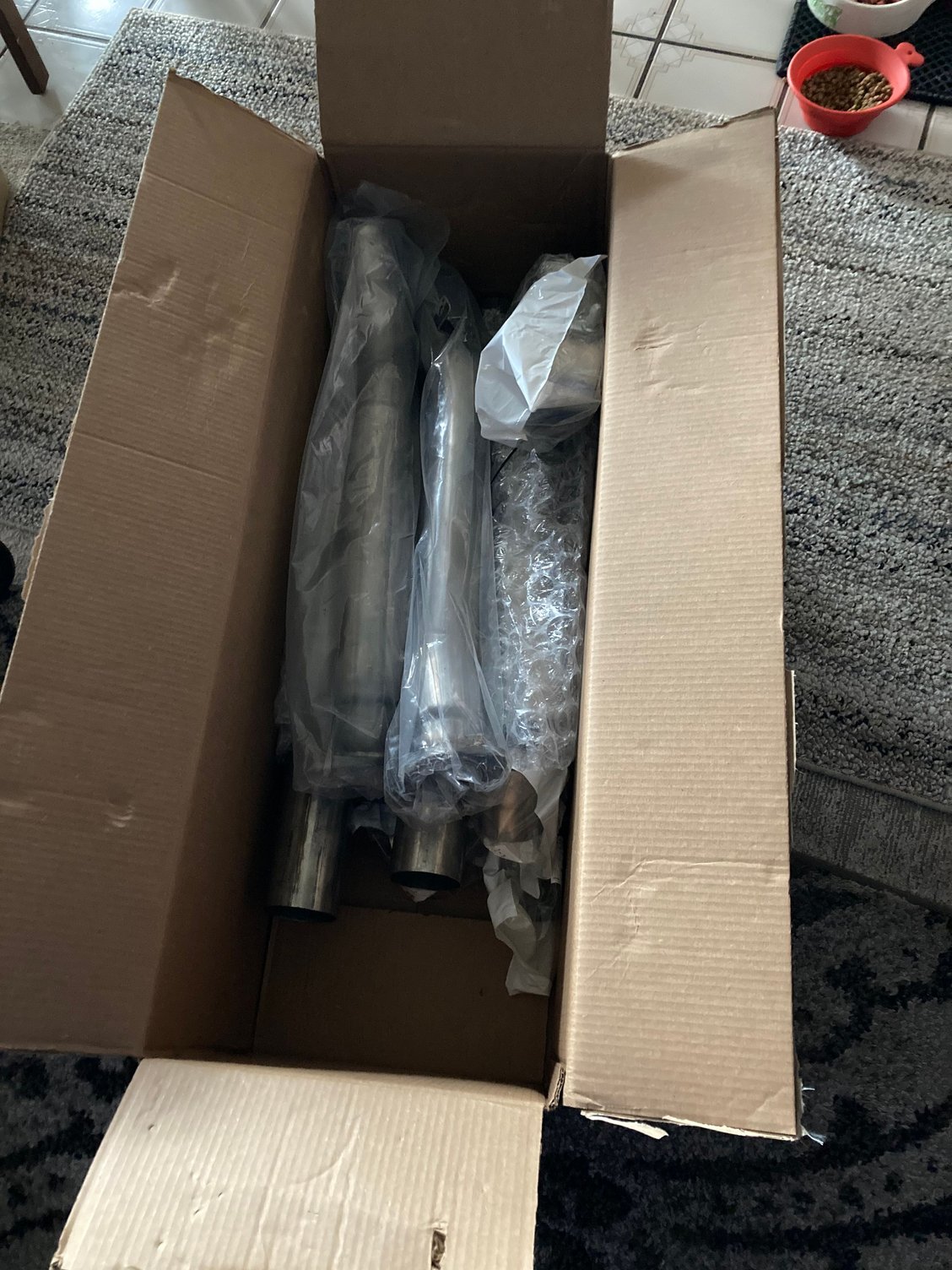

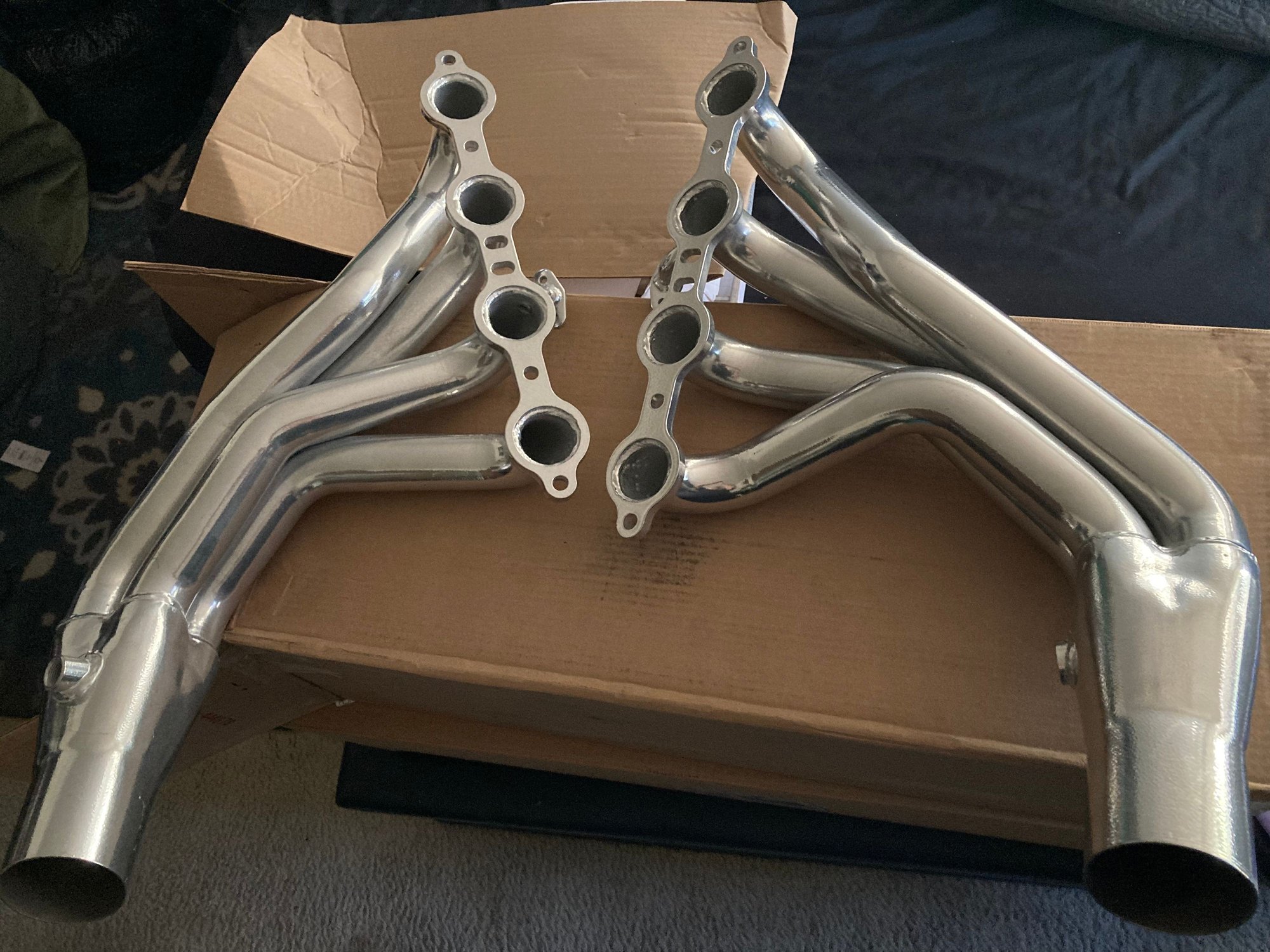

Box with X pipe/midsection came yesterday, box with headers came today from TPS.
