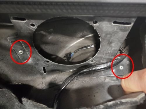

I did a search and couldn't find any definitive info on this. I'm looking to do a serious audio upgrade on my (stock audio) 99 convertible. 5.25's in the back aren't ideal at all. It looks like the factory speaker pods are held in by basically 2 rivets that I've highlighted in the pic below. Can anyone confirm that once I drill out those rivets the stock bracket will pull out? I'm a bit concerned there will also be some adhesive somewhere that will make removal more difficult (obviously not impossible) once I remove the rivets. I'd like to know what I'm up against before starting.
Thanks in advance!

In my 03 Vert, there is definitely adhesive holding those panels in. They probably just used the rivets to hold them in until the glue dried.
Good to know, thanks! Did you end up removing them?
No, I had all of the carpet out to install dynamat and a backup camera so I took a look for you.
