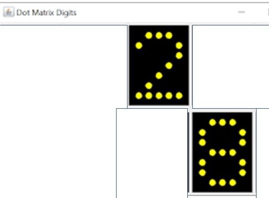

Another vote for display problem. Only takes about 5 failed pixels to turn an 8 into a 2... As with everything C5, check/charge the battery and see what happens.
