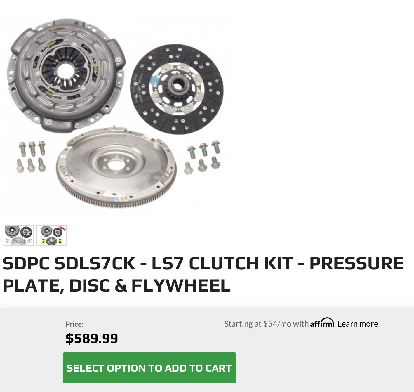

That’s an excellent price, but make sure about the parts. Also, have them install a remote clutch bleeder, this is a must! Tik and Katech offer them.
The LS1/6 flywheel is not compatible with the GM LS7 clutch, or the LUK LS7 style clutch, and the older clutch is no longer available. So you should get some clarification from your mechanic on what they are planning.
GM sells the LS7 clutch kit that includes a new flywheel for a couple hundred dollars more than the aftermarket LUK. Your call.
The LS7 clutch is now the standard GM clutch replacement for all corvettes from 1997-2013. It’s rated for the C6Z06 which is over 500 hp, so it’s good now and a few upgrades down the road.
Finally, spend about $100 more for a new clutch master cylinder, so the entire hydraulic system is fresh.
Heres an example of the GM LS7 clutch kit (aluminum flywheel is an optional upgrade).
