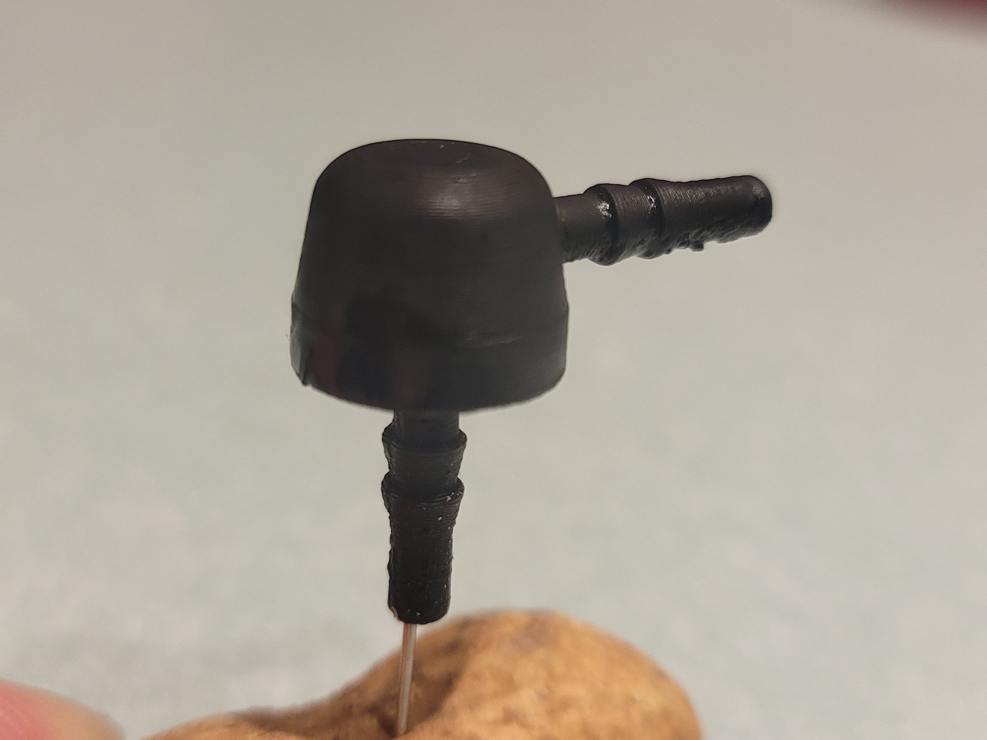

First time caller.. long time lister ...
2004 C5... the little barb that is on the "dome" that the hose from the passenger wiper attaches to has died. The hose is fine as is the rest of the hose assembly under the cowl.
Any suggestions? Has anyone tapped in a new barb? Wondering if there is another solution - 3d print maybe...

Thanks... however was looking for a work around. For instance - the id of the hose is 1/8 ... that's a standard barb size - has anyone removed the elbow and run hose right to the wiper? Has anyone successfully repaired the elbow? Has anyone found a suitable replacement for the elbow?

Thank you! I like your thinking! Local kid here 3d prints I'll see what he can come up with he said something like $10 each which I'd be happy to pay if it worked and looked similar to stock. If that's a bust your plan seems solid!

I've seen the kid's prints. High chance of success. Depends on the 3d model and the quality/calibration of the printer.

Thanks... good news... I'm going to try the 3d printed alternative first - 10 bucks to support a local kid. Will report back!

3d printing for the win! Definitely more robust than the original! GM should hire the kid!!

That turned out pretty good!
