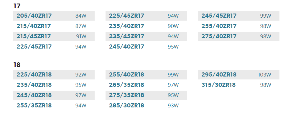

Hi All,
I've recently started autocrossing my '03 Z06 and want to upgrade to Falken RT660 based on a number of recommendations and reviews. Sadly, like many manufacturers now, they don't make the OEM sizes I need for stock rims. I'm considering 275/40 ZR17 for the front and 295/40 ZR18 for the rear because these are the closest matches I can find that aren't either too wide for the stock rims or significantly more narrow, which would sort of defeat the purpose of going with stickier tires. I have 3 concerns with this setup:
  1. Clearance: The rear tires are 1.2" higher (sidewall, double that for circumference). Will they rub in a performance scenario when the suspension is fully loaded?
  2. Vehicle Rake: The ratio of rear height to front height is slightly larger. Will this shift the weight distribution enough to change the handling characteristics?
  3. Traction/Stability Control: I'm pretty sure I'm in the clear with this configuration, but I want to be certain I won't run into issues.
I'm currently on Pilot Super Sports and find them to be too hard for AutoX and difficult to heat up on short courses. Z06 stock rims are 17x9.5 and 18x10.5, which are a bit wider than non-Z06 C5s.
I've attached the RT660 tire size table for reference.
This is the same exact set up I have. No worries on this one.
