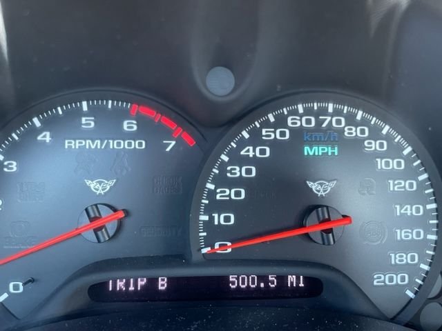

carl418's Avatar
carl418
Joined: Aug 2022
Posts: 235
Likes: 113
From: SC
I finally just today finished the break-in miles that Motive says to put on their new gears. 500 miles of easy driving. I thought it would take forever but in reality just 3 weeks. And you wouldn't believe the amount of people that pulled up next to me, wanting to race. And there I was, not being able to do anything about it. But... their time is coming!
Anyway, it feels great now! It's like an entirely different car... very quick to get up into the rpms.
And being the stickler that I am, I drove it 500 miles before punching it.
