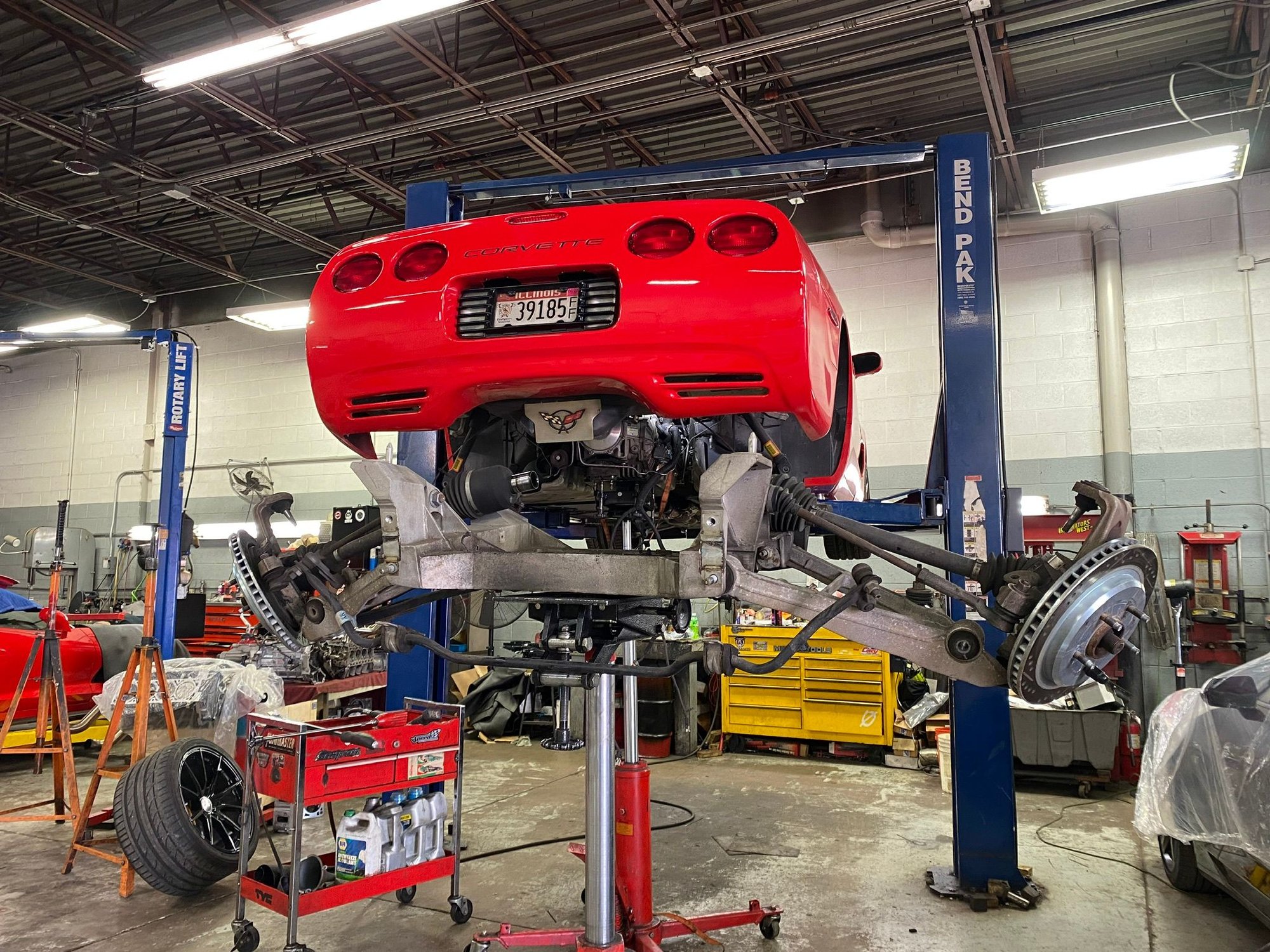

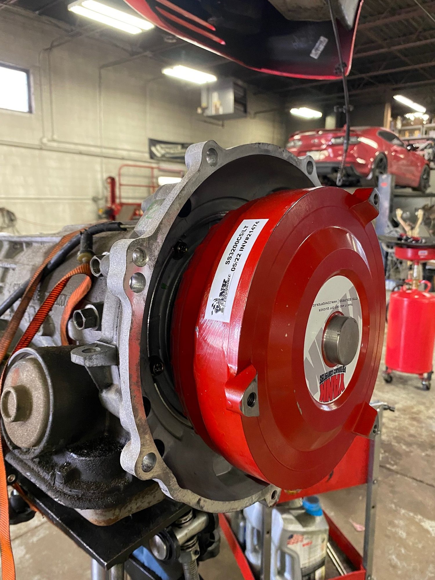

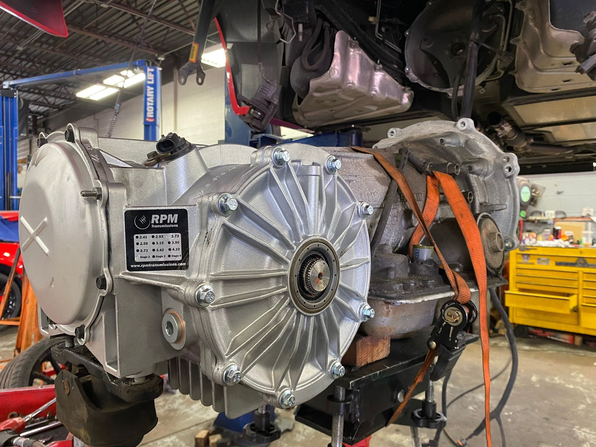

Pics of my install at Speed INC.
They did a trans service too, fluid, filter, gasket.
