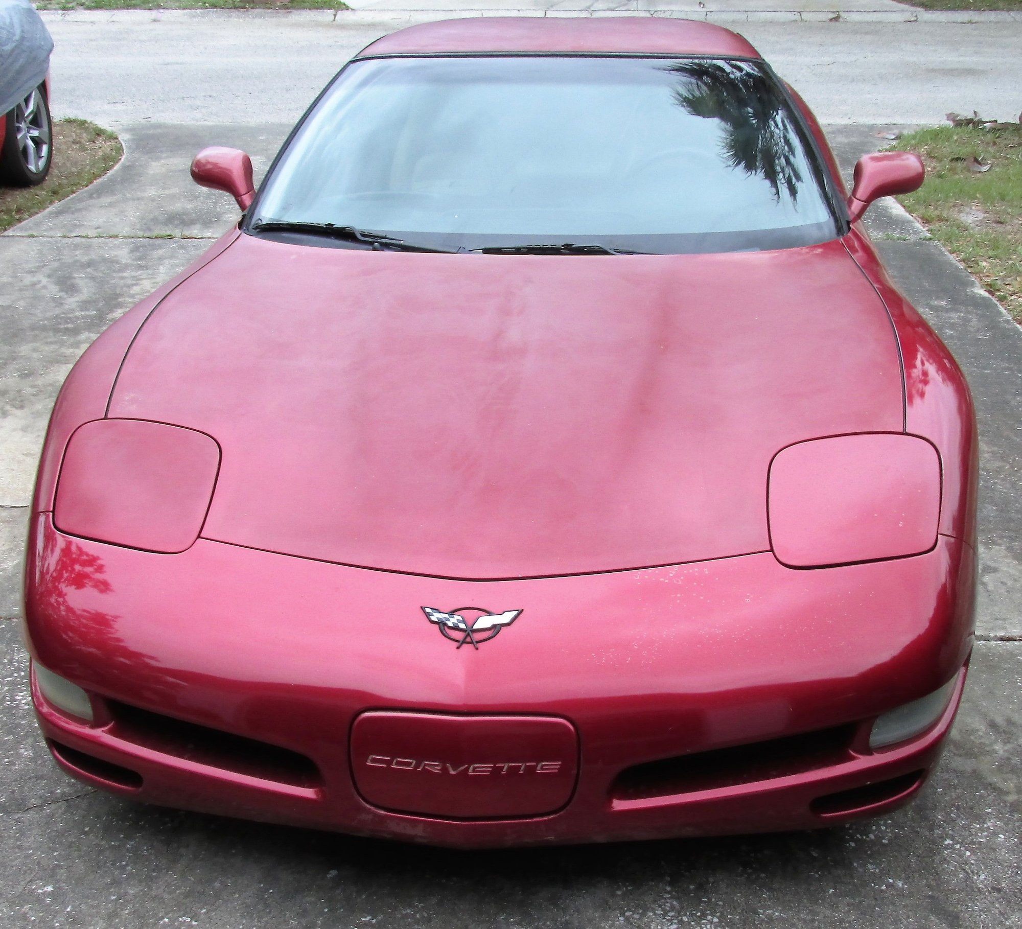

Got some new parts in today, wheel locks, key fob, window regulators and hood lifts. Got the fob programmed and hood lifts put on quickly. Will probably get the drivers seat fixed one way or the other tomorrow, and get going on both the window regulators. Most of the stuff I'm doing is fairly easy, but i have a list of 18 items, have checked off maybe 1/2 of them. Another thing I realized is the tint needs to come off, it's old and messed up. Side windows will be easy enough, not sure about rear.
On a side note, went out in the garage early this morning when everything was quiet, and could hear a humming sound coming from the car. I followed it to the passenger seat. Pulled 3 (lumbar) and 36 (pass power seat} fuses (after setting seat in a good position) in passenger footwell and it quit. As soon as I pulled fuses, charger jumped up a couple of notches, so i guess I found my battery drain.
This is my 9th Corvette, but I have done a lot of cars like this one. People rag them out and I buy them cheap. Obviously, I had to buy this one for the $3900 and will keep looking for the next deal. I should have all the little stuff done in a week or two, and then will make a decision on the paint. So far have only put maybe $300 in it.

Got the driver's seat kind of fixed and put back in, will get a pic of it later. The side bolster had broken loose from the main part of the seat, so i did the best I could to reattach it. It is ok but seat is worn and really needs to be recovered, especially since the passenger seat looks perfect. Plugged back in driver's seat and it moves fine. He had unplugged it thinking it was his power drain, the drain was from the bladder on the passenger seat, turned that off both seats by pulling fuse 3. Got both seats and mirrors set where I want them, turned off AC and set the memory.
Wanted to get the window regulators done today, but didn't get to it, have to watch Rays play at 7. Going to take it out for a spin tomorrow to see if any surprises, I already noticed one thing today when I cranked it, oil gauge pegged out, so sensor bad, no big deal. Engine runs very smooth, fairly quiet with stock exhaust. AC was cool but not cold, will check freon.

Got the wheel locks put on today, and one window regulator done. Took some time to get window properly aligned, and works perfect now. Also took off the tint on both side windows and got that cleaned up. Did some more clean up inside car, starting to look better. Things are getting crossed off the list, about 10 things left to do, then have to make to big decision on paint. Although i was going to flip this car, I'm now thinking of keeping it for a while.

Reached the end of this project, not perfect but turned out nice. I'll let the new owner take it to the next level, it would be ideal for someone that paints cars. As much as I would like to keep it and drive it for a while, don't really need three cars right now. Also don't want to get into the cost of the paint job ($2 - $4k +) and the added insurance.
There are a few other small things that need to be done (like most c5's), but you could drive it now with no problem, A decent paint job would make all the difference in the world. I kind of like working on cars like this, mainly cosmetics and small fixes, would have liked to finished and driven, but time to move on.
