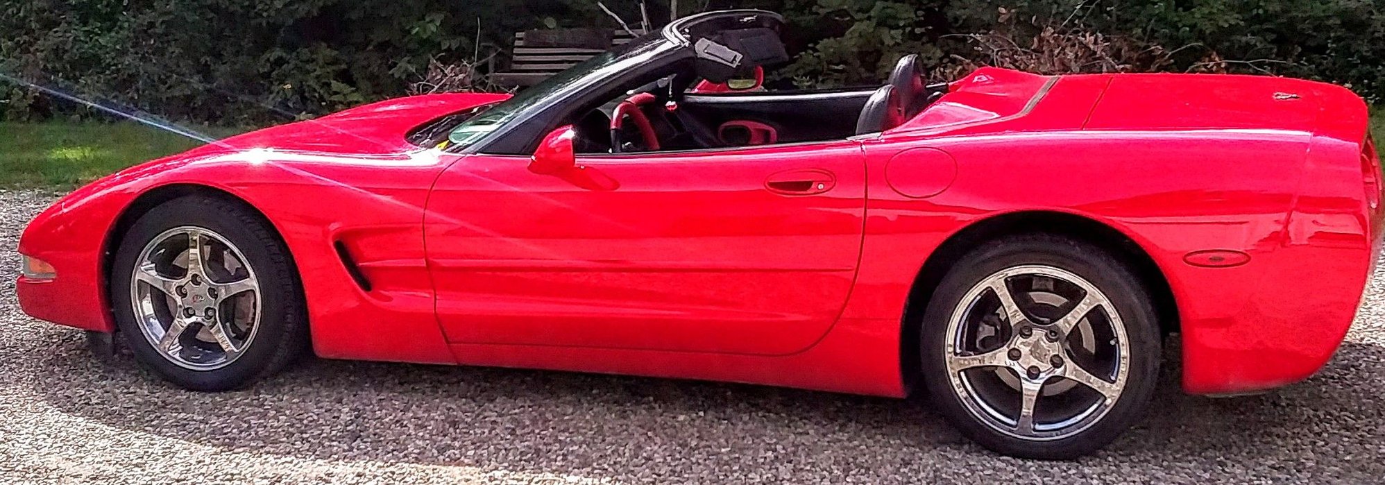

Time to fix the leak in my A/C system. I'm certain it's in the Evap unit. Big job. I wanted to take it to Lyle@C&S in Sarasota, Florida. About 90 miles South of me. But he's booked until July (great time to be C&S!!). So it's going to a place in Pinellas Park, Florida, instead. Shop is R&B Auto electronics and Repair. Had my Caddy there once, and was impressed with their work. They specialize in Corvettes, and also work on late model Cadillacs. I'm going to try and post a pic of my car, as it looked going to the shop yesterday. Don't shoot the messenger if it's MIA!!

The car looks phenomenal! I hope everything goes well with repairs.

Car looks great! Good luck with the a/c service.
Thank you. It does have a few battle scars from 135,000 miles of war, but for an original paint, 23 year old car, it's pretty decent. I never bought it to park it. If that's what some like to do, that's great. I buy them to enjoy the drive! Thanks again, Monty..

Car looks great, especially (to reference a recent posts on the topic), the BSM fits the car. Being in Florida, A/C is definitely needed even with a Vert that I would expect you like to drop the top.
You might note how far recessed the rear lugnuts are. That's because they are wider, repop thinspokes I bought almost 20 years ago, from Bob@House of Wheels. They're 18"×10.5" so I could run a 315-30-18 tire out back. Probably not in production anymore. But it helps keep the stock, sleeper look, while running wider tires. The 427 needs all the rubber I can get it!!
Amen to that! My car is a driver as well.
I hadn't noticed that until you pointed it out. That's exactly what I need for mine. I love the stock wheels, but I also want a wider tire to hook up with the extra power. I might have to start looking for just a rear set of those.
