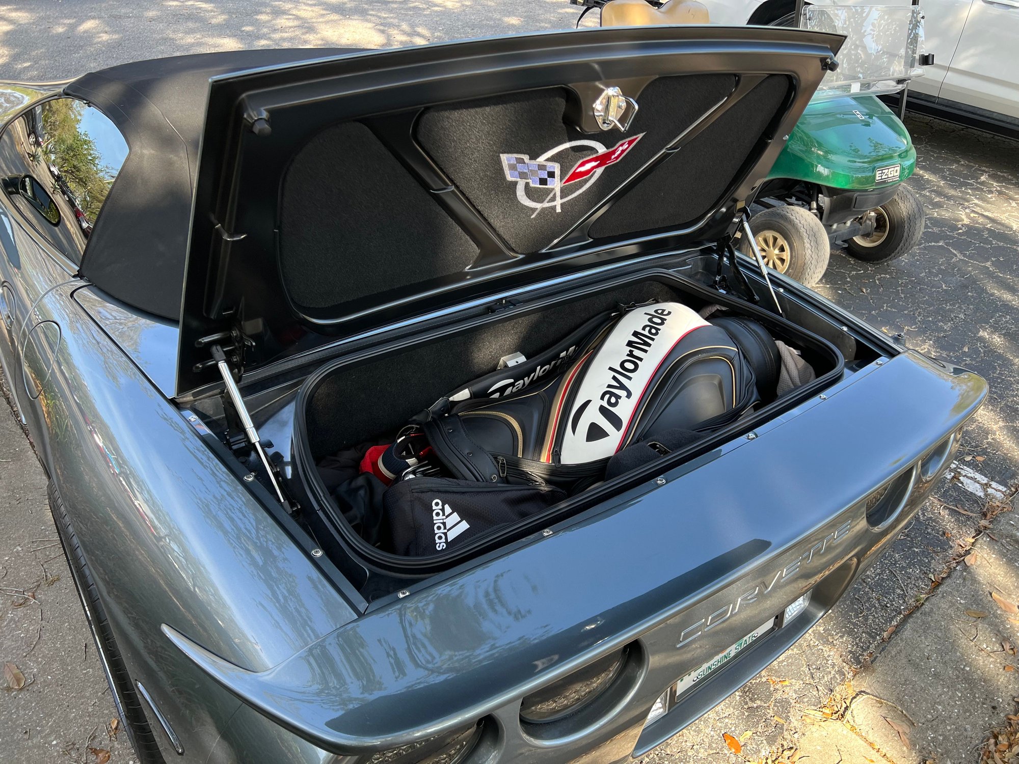

I replaced my trunk struts last year when they started to fail. I went with a set of chrome aftermarket struts, however in answer to your question, the trunk lid opens up almost completely vertical. Here's a pic of my C5 golf cart.
That is definitely higher than mine for sure. Looks like I may be right..........wrong struts. The good news is the tonneau struts are correct. The trunk is wrong but so much easier to replace.........Thanks MSG
