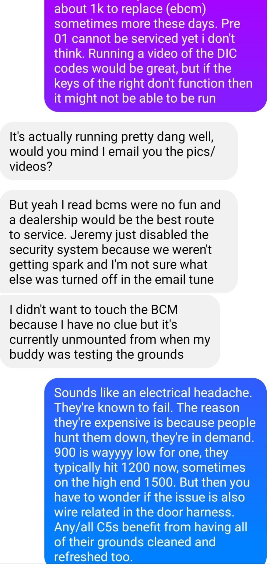

I'm chatting eith a seller whose FRC my friend is interested in.
I have never had an ebcm issue on my cars before so I don't have direct experience and knowledge.
What sounds to be ebcm related or not in this case?

Maybe so! I've never had either fail me across three C5s yet.
The one at odds here would be the passenger footwell from the pictures I've seen and level of info shared. I'm riding secondary on this one at the moment.
What would affect wipers? Factory security?
