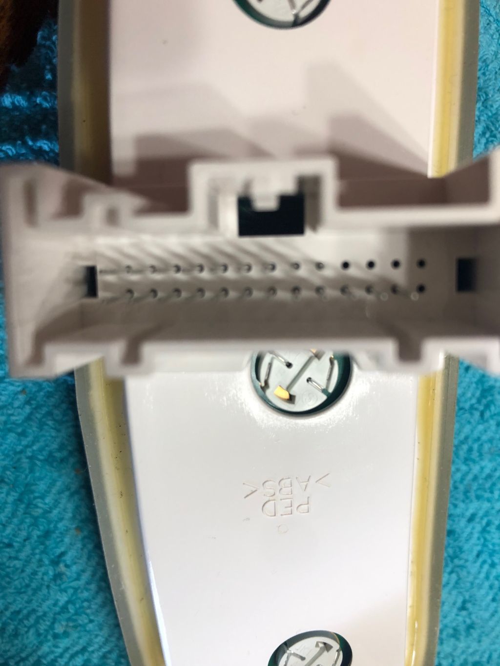

Here's the back of the switch. If you'll notice there are some pins not there or used so I bet the it'll fit.

I believe the memory switches should work fine in a non memory car.

The switches WILL interchange.Been there,done that
