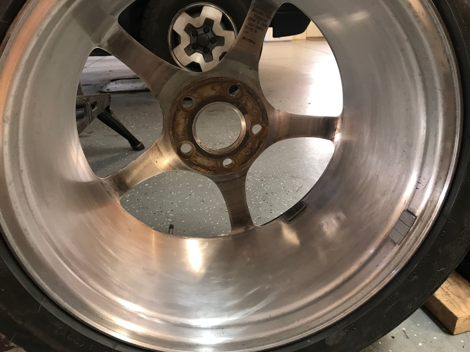

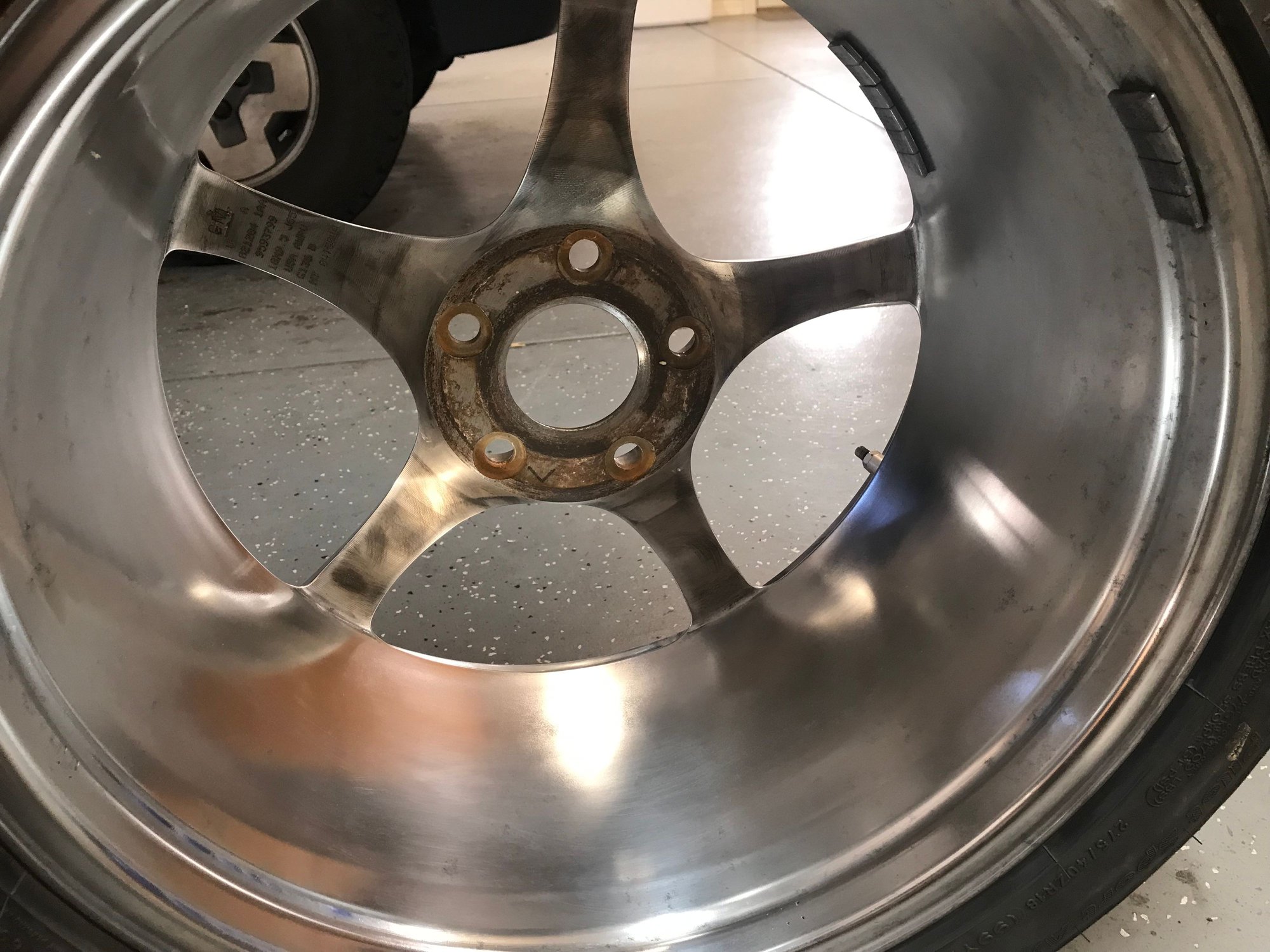

Progress Photos:
1st is RR wheel taken through 600 grit.
2nd pic is LR wheel through 600 grit then using Mother's Power Metal, a Mother's power ball on my drill, wiped-off with water, then sprayed with crystal clear lacquer. I am pretty much done with this wheel except for a couple of spots on the front.
No I did not get 100% of the corrosion off but since I plan on getting those C6 wheels in the future, I think they will look fine until then.
