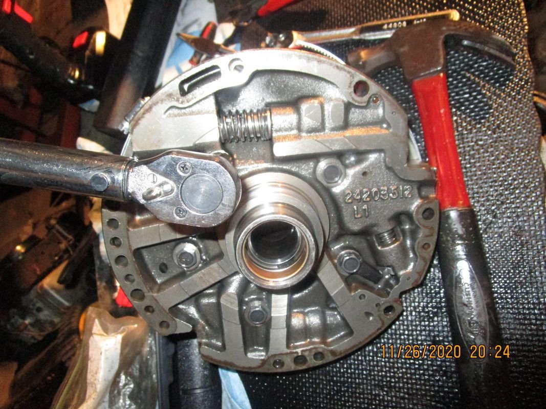

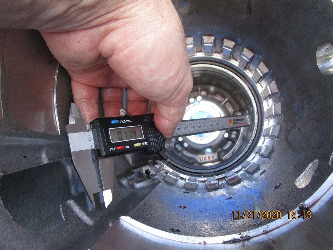

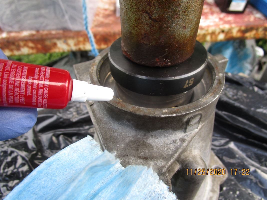

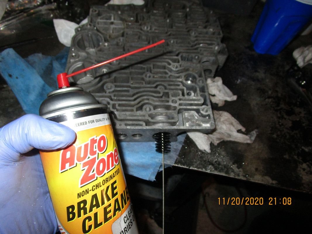

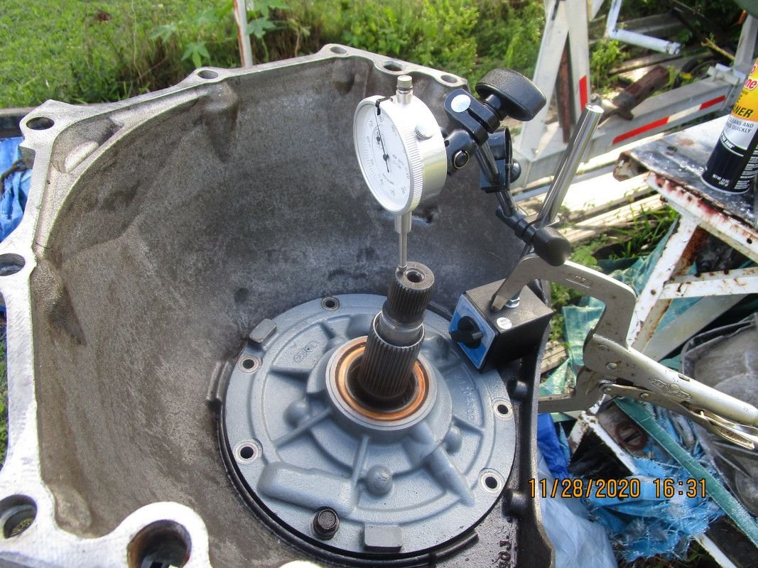

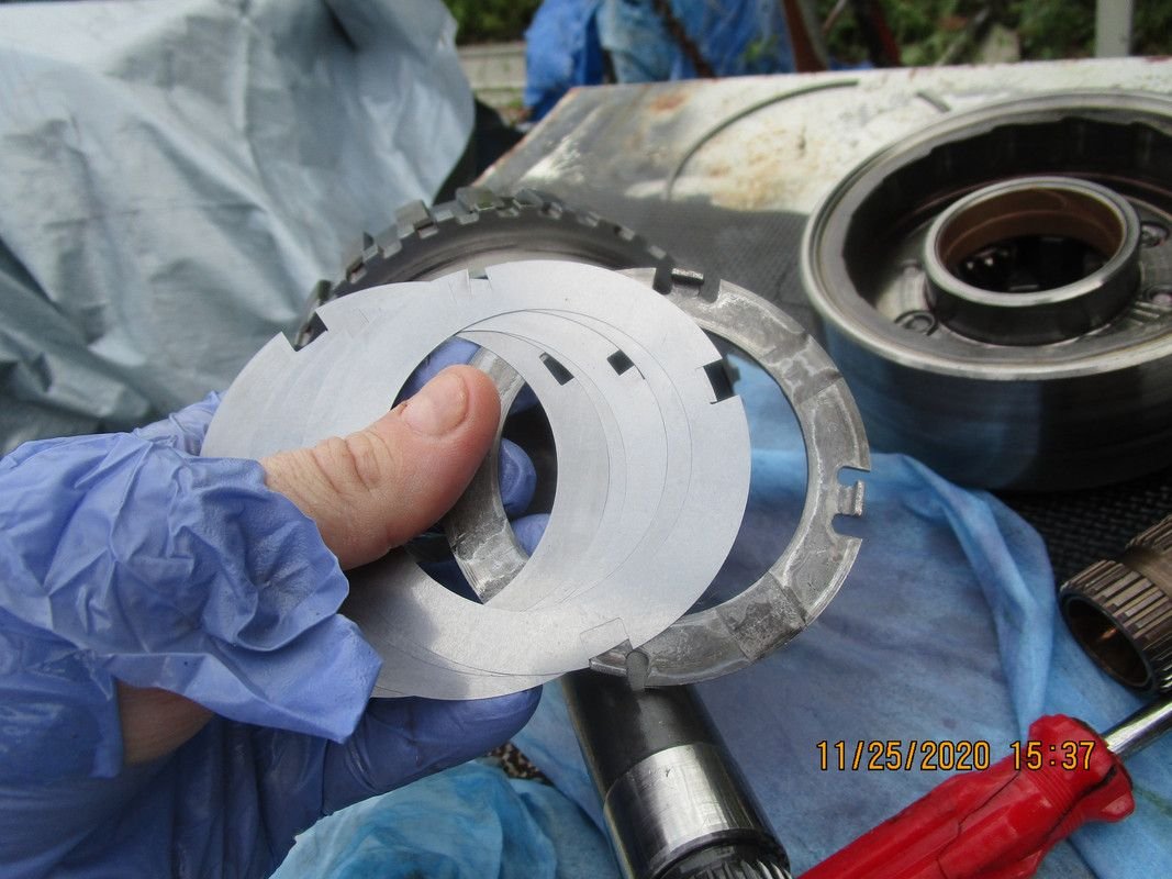

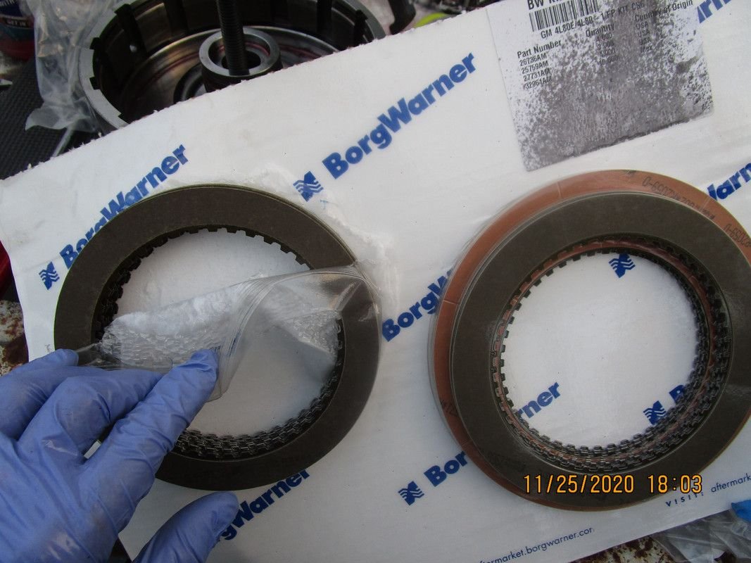

My solution is to become capable of rebuilding the transmission yourself
This way you can do whatever you want and nothing can stop you and theres no down time, it only takes a day or two to build a trans
Then you know what parts go in it and how.
nothing quite like opening a brand new pack of Borg Warner clutches
knowing those bushing are replaced, straight, and loc-tite'd nicely
How deep is that case bushing? Did you remember to put it in backwards? Nice and straight?
How about all those crevaces and crevices, did somebody clean them properly? You blade bottle brush brake clean bandit?
Did someone use a torque wrench?
Tighten up that reaction carrier and rollerize the output shaft- somebody? Anybody?
Check End play or just slap it together?
If you want something done right- do it yourself.
