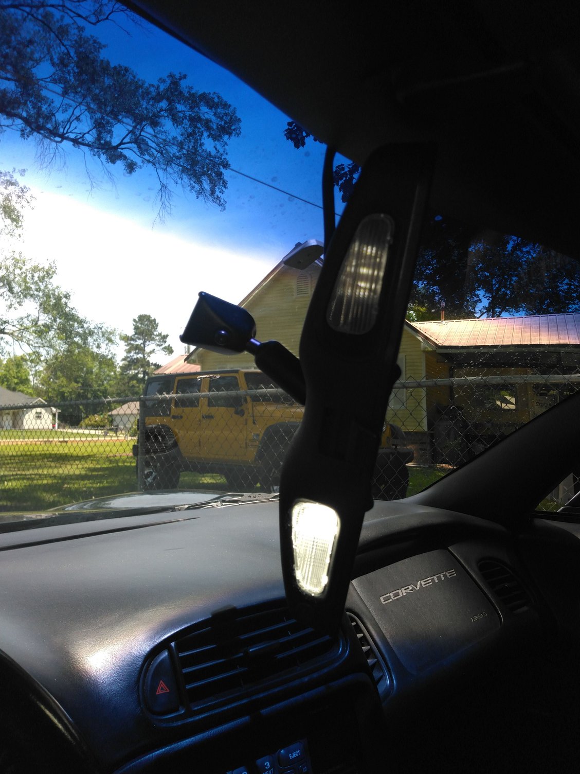

Swapped them, no change. Took a picture, one light is on because door is open, other light I have the switch manually turned on. If I turn the switch off, both will come on bright with the doors or key fob unlock

Follow up: fuse #2 was blown, which is some kind of load detection for the BCM....
With fuse bad, I think it defaults to 5 volts.
Still not sure how it can tell difference between courtesy light and map light,
but it is functioning correctly now.
