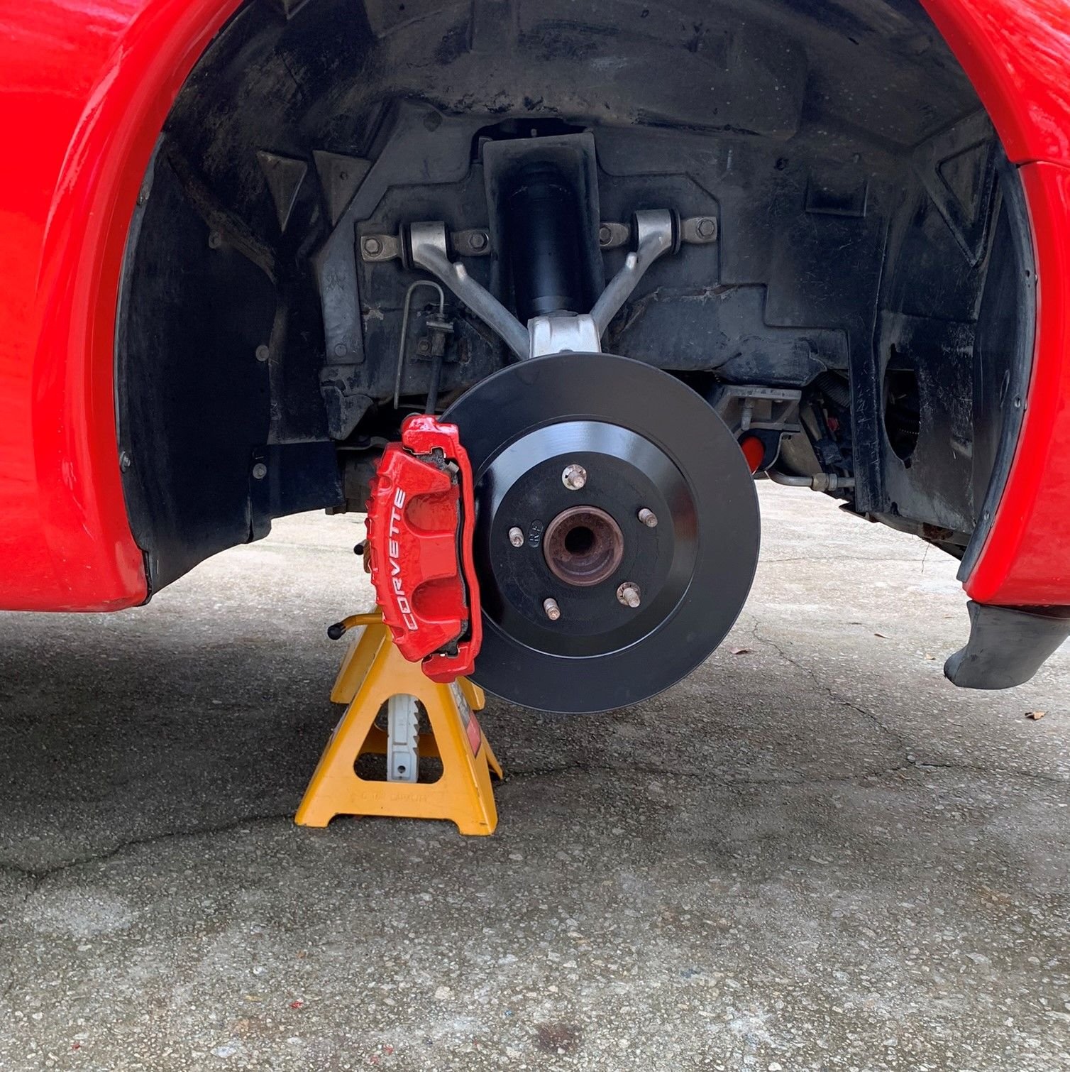

Here is how I did mine, very happy for brush on!
